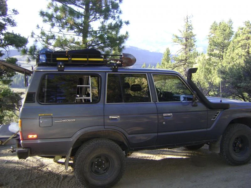

So, quick update...
Took the truck down to Valley Hybrids last week and Georg took a look at it. First off, Georg is great. I would highly recommend him. Great guy, great service. So, I was missing my carb cooling fan so I got one from him and I installed yesterday (we'll see if it works). Also, I have nasty exhaust leak that I am going to fix in the next week or two. My timing was way off so they took care of that and, wow. Already a different truck for the better. Gas mileage has already gone up 2 mpg.

Mar 24, 2009
2,855
AU
nice looking rig mate
i see you have tha slidin rear windows they are rare in US models ay did they come with the 60
Mar 12, 2010
25
Arizona
What color is that called man? Thinking about a similar color for mine
