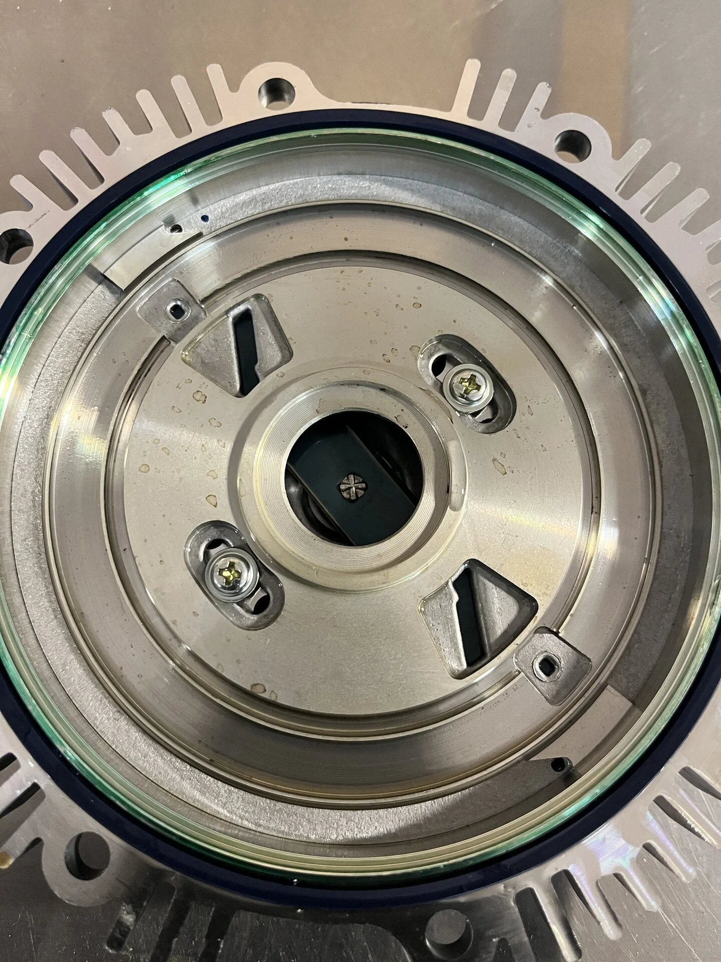

Blue hub clutch
Well hobby shop only had 10k then jumped to 30k so 10k it is.
I have said it before and I will say it again, if all you ever do is what @LongDuck says to do, you will be in a good spot :) and if @medtro gives you access to his treasure trove of parts... then you are golden.
That said, I also second the hub mod, even if all you do is the fluid swap. I went all the way up to 30k CST and it works really good.
Hobby Action in Chandler has all the different fluid weights. I'll be there most of the day racing (it's club racing day) if you want come say hi. I'll me running 2,000,000 CST in my RC car center differential :rofl:
I almost went with 30k but with all the reading with 10k and blue hub. Im still upgrading. And it seems 30k would be engaged a lot. Currently pretty much driving it daily. Need to fix some leaks on my gs300
or 10k mixes with 30k
Didn’t think of that. I usually try to keep most things on the k.i.s.s. Method and blanked on mixing fluids l.
mixing works well
See how it does this week. Hopefully. Lol
Well looks like it works well. Moves some air for sure. See how nap time goes tomorrow lol.

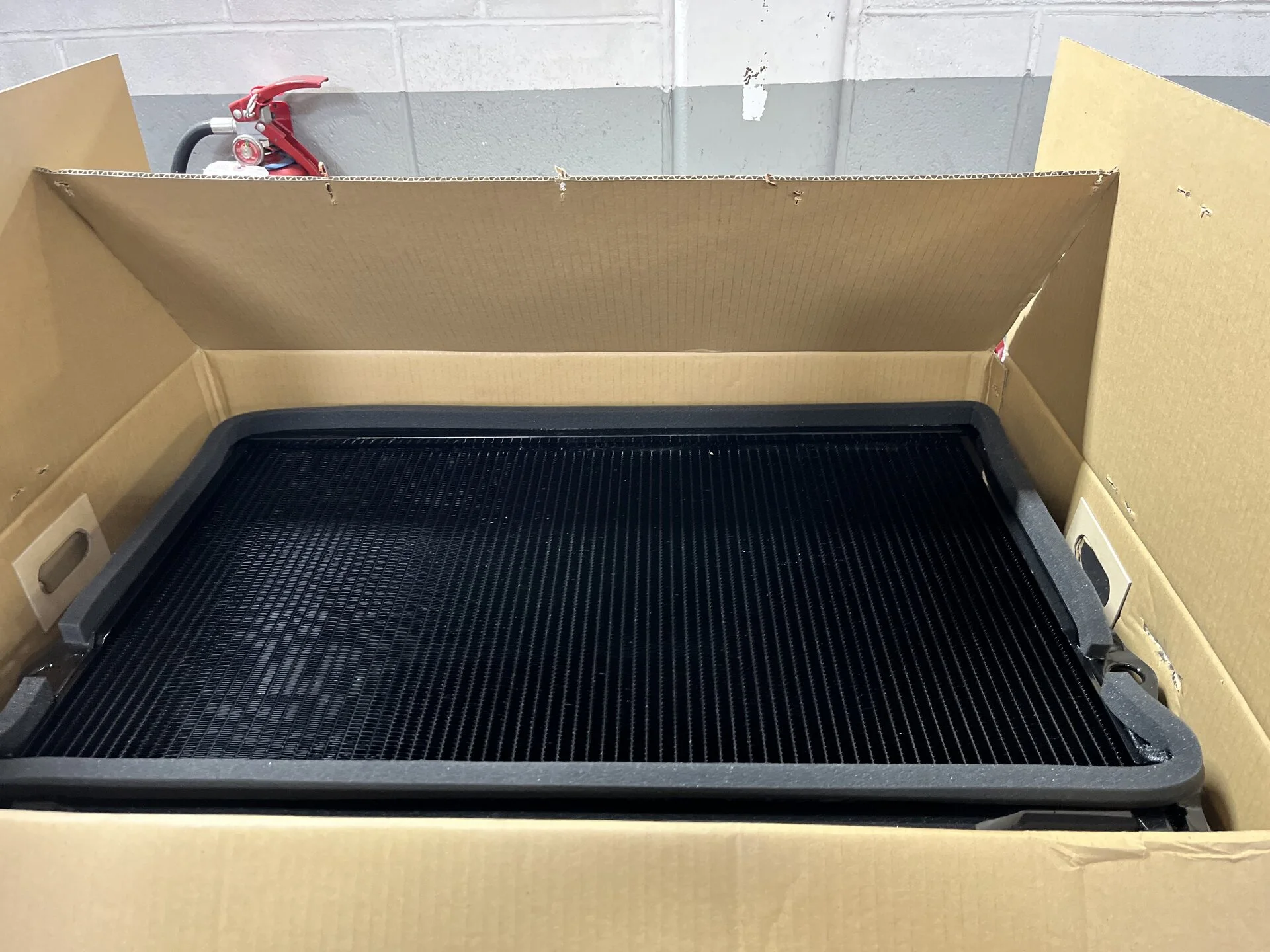

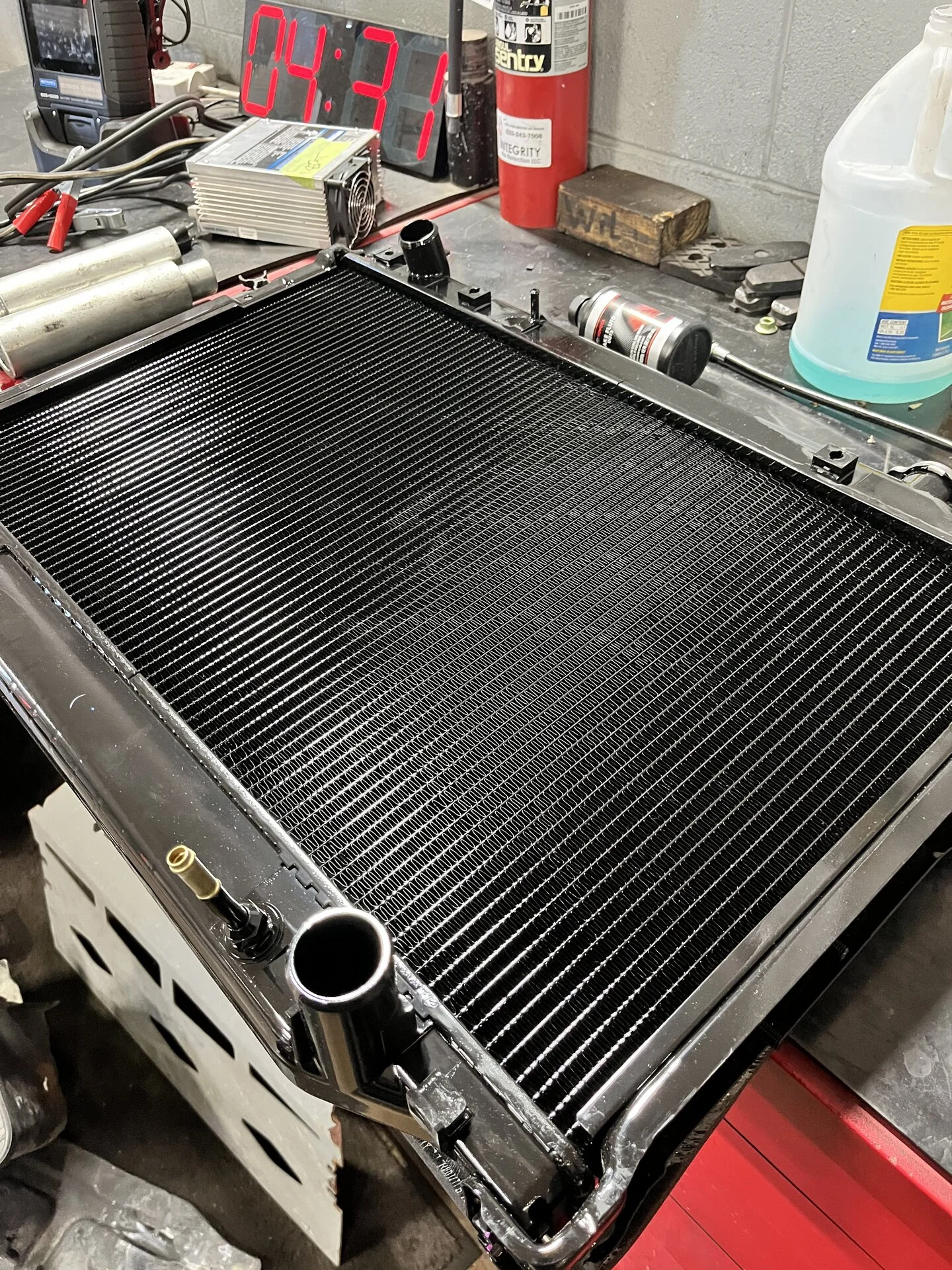

Well free rad cracked on the way in to work today. Shame. But still thankful. So the thick boy 94 style rad is actually cheaper then the thinner 97 style. So since the truck was working well with the older style one. I got a new oem 94 style at work. Still available at the local where house!! Score!

I run 25CST in blue hub clutches, which you can achieve by mixing your two fluids 50/50

it's working great in a blue hub clutch - but is likely too thick for a black hub clutch (have not tested anything in those beyond 15K thickness)
