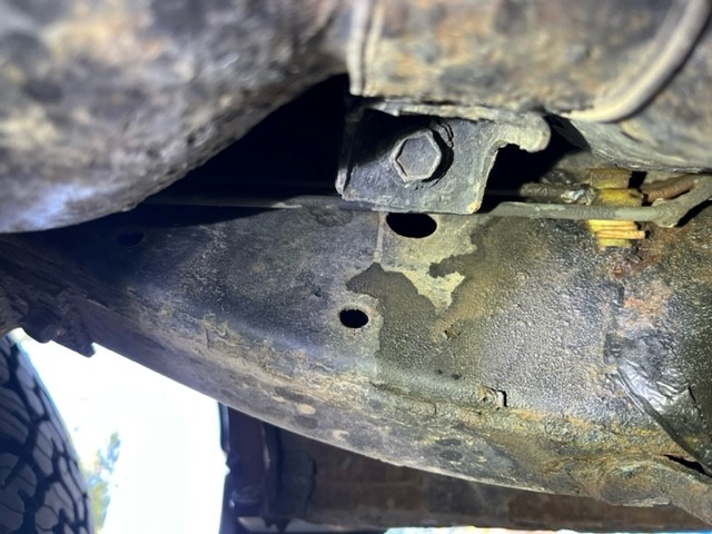

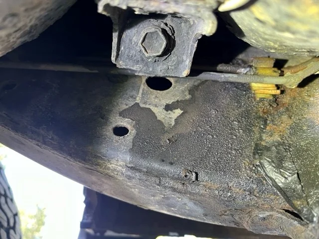

Hi All - I have a 1996 LX450 and a section of the hard brake line that runs from the front to the back blew out. It is the area under the car that lines up with the front section of the rear leaf springs (hopefully that makes sense). I am in the Lake Tahoe area and my mechanic says they have been unable to find a replacement as it is a long piece that is difficult to find and ship. Any suggestions? Thanks ahead of time.

@Saito - Criticism accepted. Not sure what I was thinking. Leak is to the outside of the bushings of what I suspect is the stabilizer bar. Aligns with the middle of the left side passenger door. Again, just trying to describe the area of the leak but clearly not up to the technical specs.

Can you take a pic of which brake line it is?
Sure thing. Here it is...the top line in the pic, which I believe is part number 47324.
Interestingly, I called my local Toyota dealer and they said the part was available and there were eight in their Ontario, CA warehouse. Part number 47324-60211. My impression was that the part was no longer available. I ordered one and will report back in a few days. Figured for around $80 it was worth a try.
Last time I needed a hard line I ordered a OEM replacement 😉
Just to close this string, I was able to find OEM hard brake lines from the dealer. The one I originally purchased from the Toyota dealer (Dolan / Reno) had the right part number but didn't ultimately fit. My mechanic found another at the Lexus dealer, which fit (not sure why they would have been different). Ended up replacing both hard lines while at it.
