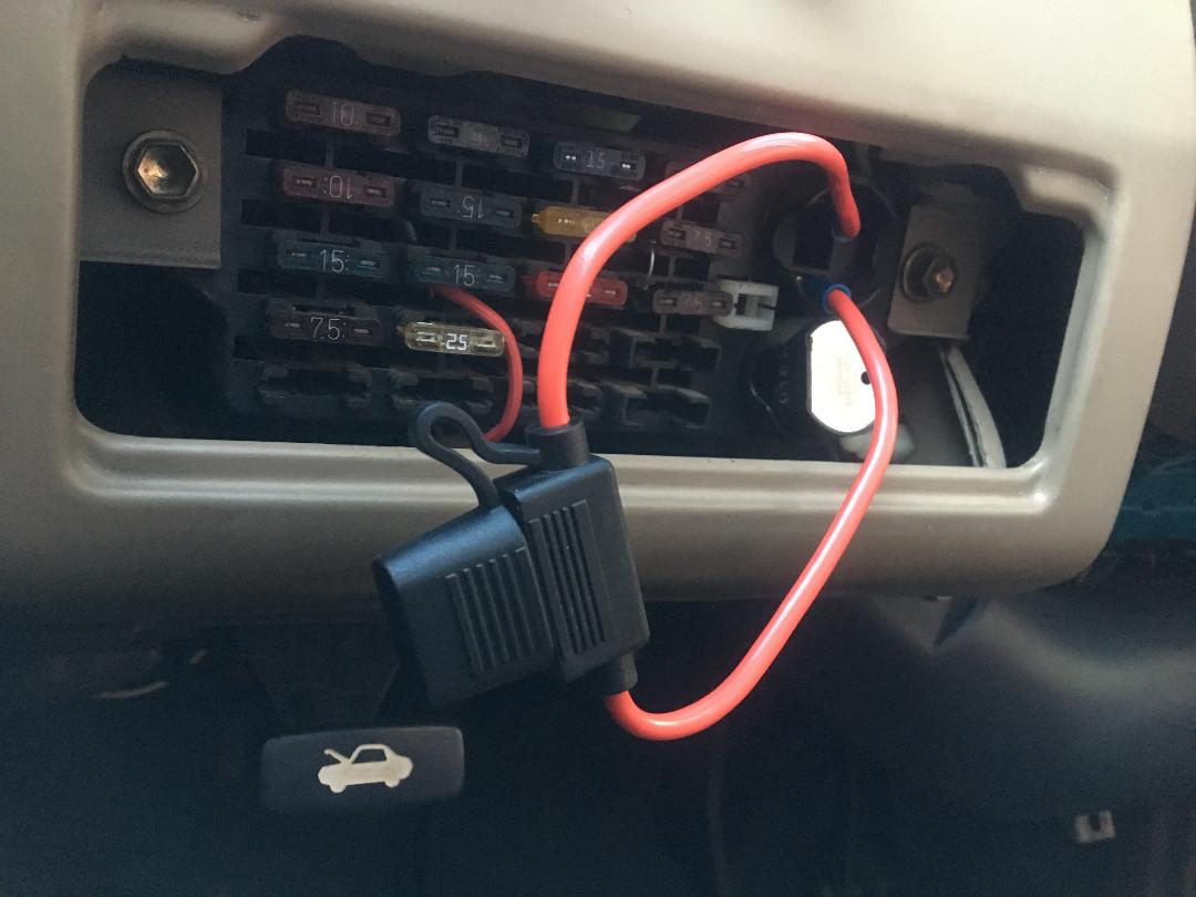

Mine did the same thing. I bought another CB as someone said those will wear out and it would still trip on high...I bypassed that CB with an inline fuse and it hasn't happened again. I I used the same size fuse as the CB. Wires do not get hot. I ordered these off ebay and just put a blade connector on the ends. Cheap fix....let us know how a new motor worked out if you went that route. Is the new motor quieter? how much was it and where did you buy it?

yeah, I try to keep my truck mostly original, but I was chasing a number of things when this happened to me. This was a quick fix that has lasted for years....and you cant see it with the door on....just a different type of fuse.
I’ll give it a try. I might have a spare fuse holder kicking around. Just so I can have some peace of mind. I heard that there was a pigtail under the dash that those grounds run through, any idea where it is?

PM me your address and I will send you a bypass like I used. I had to order a pack of them so I have a life time supply. I have been using it since I think 2017 and the wire does not heat up and the fuse has not blown so completely safe. Mine would mostly be fine on low but would blow after a time on high. Very frustrating and I had bigger things to chase.

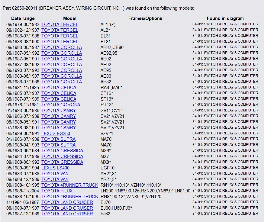

It appears (tentatively) that it’s was the CB for me. I put a new blower in. All the grounds and junctions look good. The wiring gets warm but not hot. I bought a new CB from Toyota to the tune of $42. The contacts in the fuse panel look clean and engage well. But the breaker does still get warm/hot. Cool enough you can still touch it but noticeably warmer than I suspect it should be, however it seems to be holding so far.
