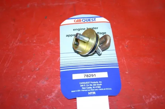

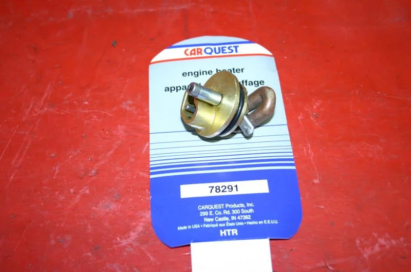

Rufus: this block heater works in our 3B.

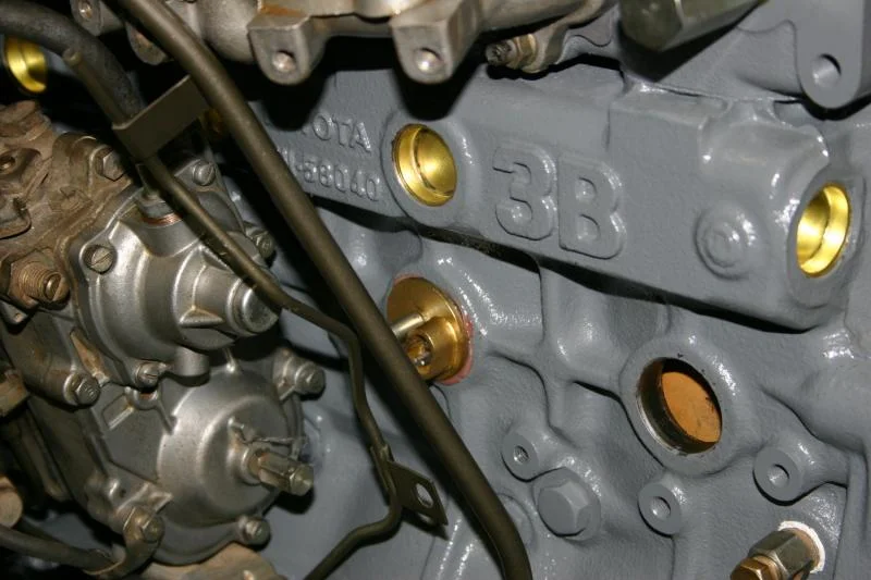

I bought it for my 2LT-E, but the heating element was to deep, so I tossed it on the shelf, and when replacing the freeze plugs on the 3B I decided to give it a shot. It's in the second from the last plug on the left side. It didn't fit in the rearmost hole (the element was too deep for the 3B there too).
