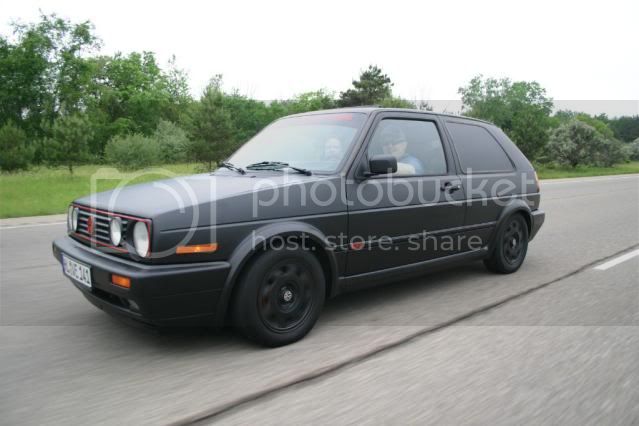

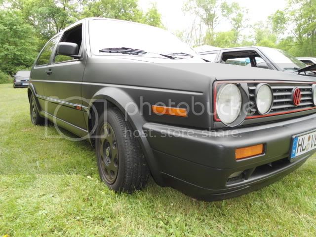

We used it to paint my 16 yr olds 92 GTI (his 1st car). He wanted that rat rod matte black but wanted it to be more of a "satin/matte" look instead of just plain flat & that is exactly what Blitz Black is. VERY inexpensive too. For less then $80 we bought a gallon of paint, a gallon of the JD primer & a quart of the reducer & had quite a bit left after painting 4 coats on it. (my step brother actually laid the paint & it was his first "all over" paint job as he is a touch up paint guy by trade)
I agree not flat, but more of a satin look. It looks much like my powdercoating on my 40.
I have not compared it to the others..... for the same money as a quart of flattening agent for UE, I had all the paint, thinner and hardner. SOLD.

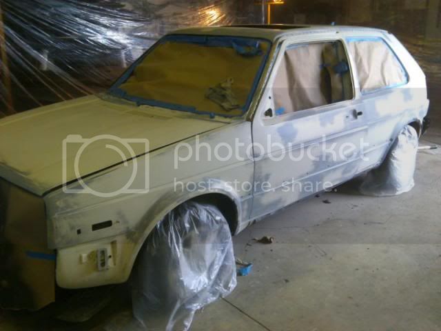

pics of hood blackout
Here are some pics....
