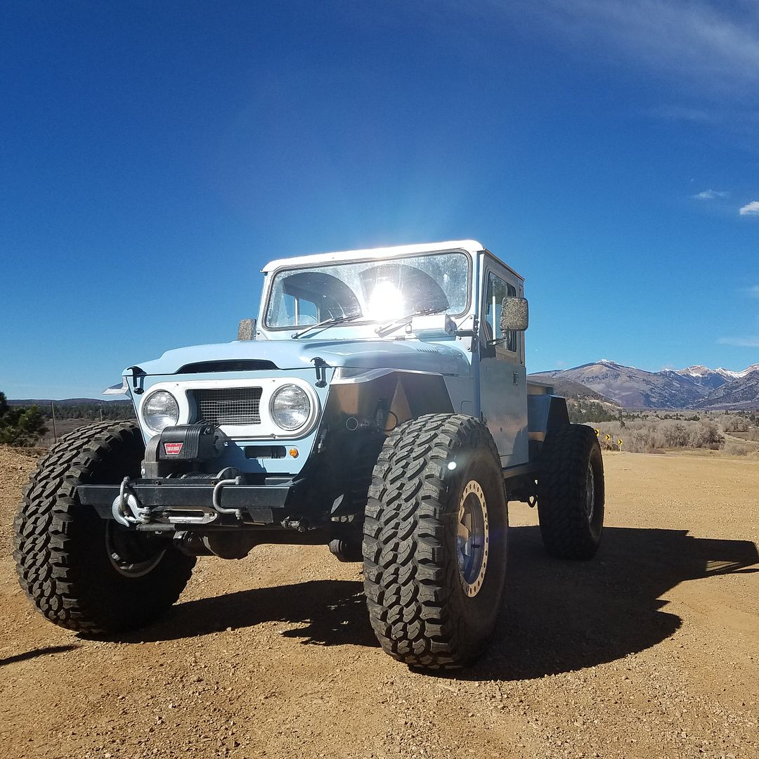

Great build, the patagonia's look good, a little on the skinny side maybe? How are they singing along on the highway?
They are a touch skinny, but not a deal breaker in my opinion. They also look a lot better in person.
The tires go down the road excellent. I didn't think 80mph on 40s with two fingers was possible.....it is....

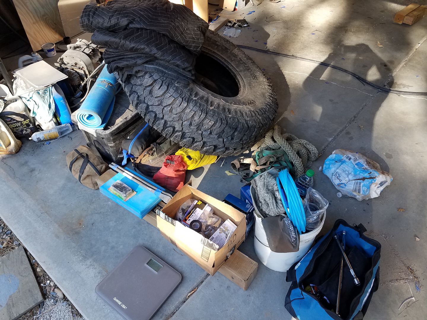

I decided to tear down the vehicle to see what I had going on....
This is what I was able to strip out of the truck to weigh, including myself. All combined that is nearly 500lbs. That bring the total down to 4400lbs and that includes a full tank of 25 gallons of fuel.

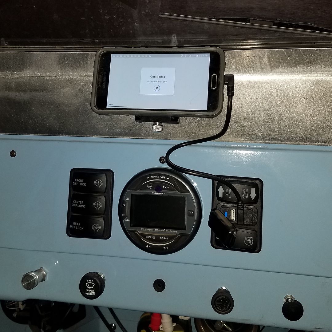

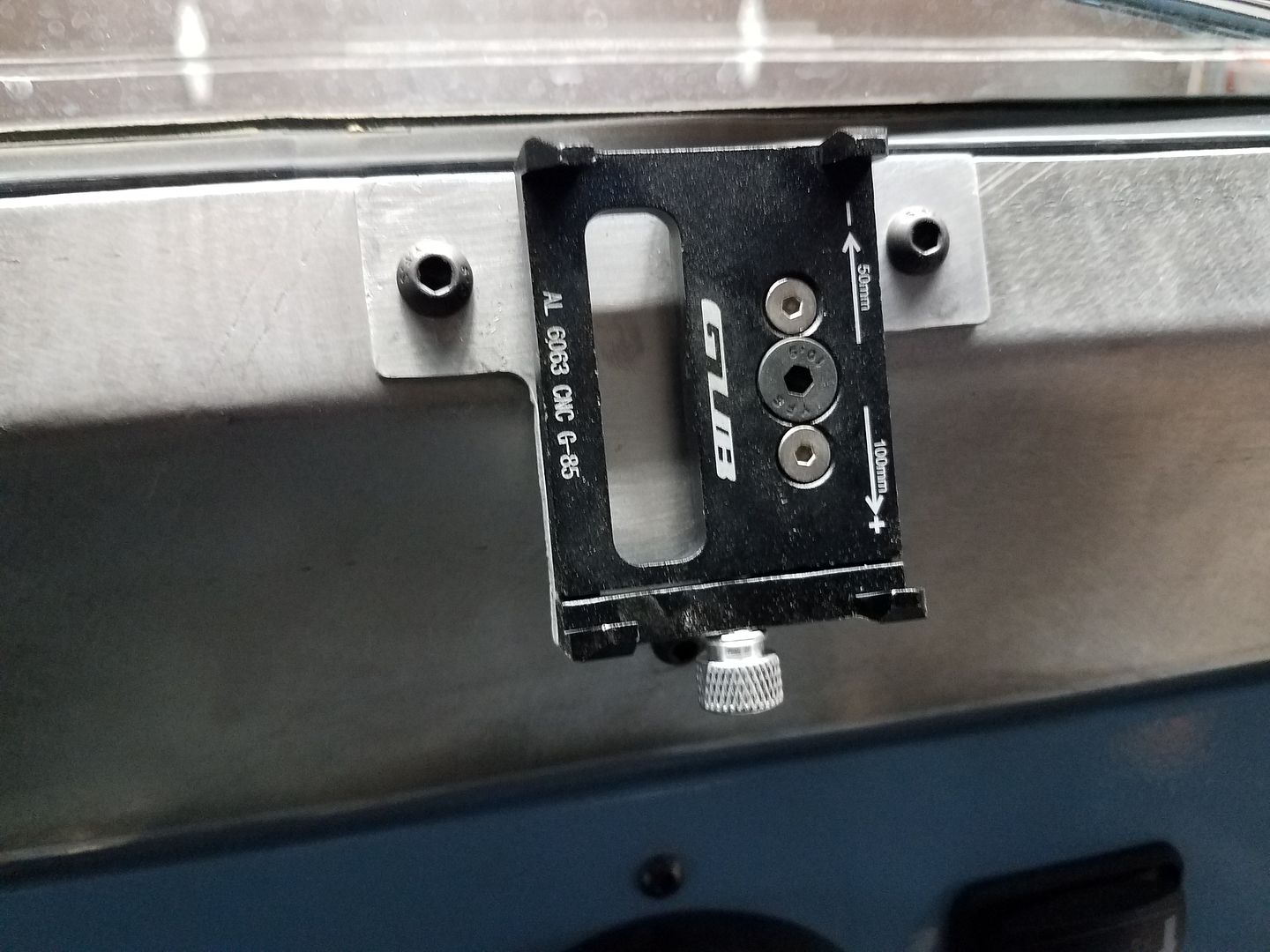

This was my other mini-project. I really wanted a simple clean solution to hold my phone in the vehicle when I use it for media or navigation. I was able to re-purpose this little aluminum phone holder for the bike world that I found on Amazon.
A little bracket I made can be removed in about 10 seconds. It is just a small piece of aluminum that I drilled and tapped for the mounting hardware that the holder needed.
The icing on the cake was the short little cord I found with the proper 90 ends on both sides to eliminate a lot of the cable cluttler on the dash when using the phone this way.
They look a little narrow, and I agree that they would look better if they where 'fatter', but they are within about 3/8" of overall width when mounted to the ProComp MT2. Most of the difference is that the Patagonia don't have large square overhanging outer tread blocks.
The Patagonia MT goes down the highway fantastic. I run them at 80+mph for hours and hours. These are also the 'Black Label' version that is a softer tread. I have about 7500miles on them now and they are down to 14/32 ( new is 19/32nd ).
