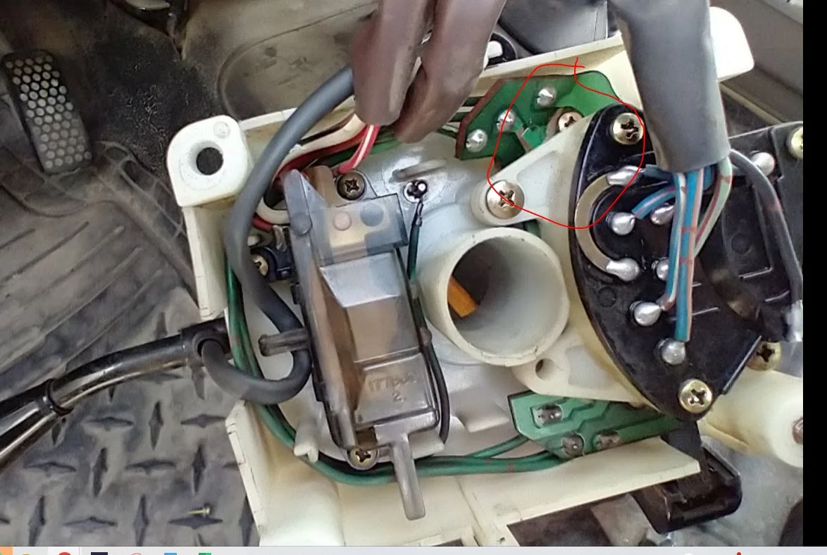

My turn signals quit working...using my arm for now. Took the steering wheel off and looked at the assembly and it looks like I managed to break the board when I was replacing the horn contact. :rolleyes:.

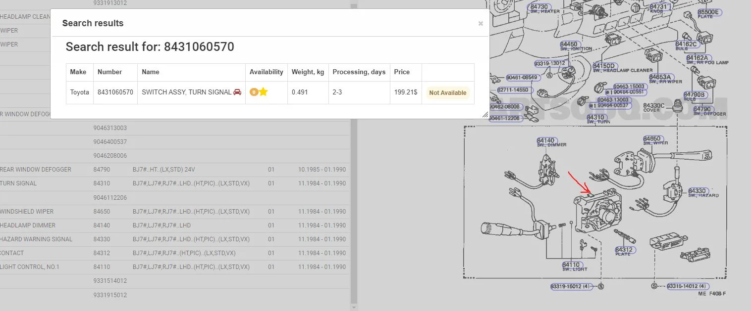

New one is not available at this time. Until one is available, I'd love to put an operable used one in instead.

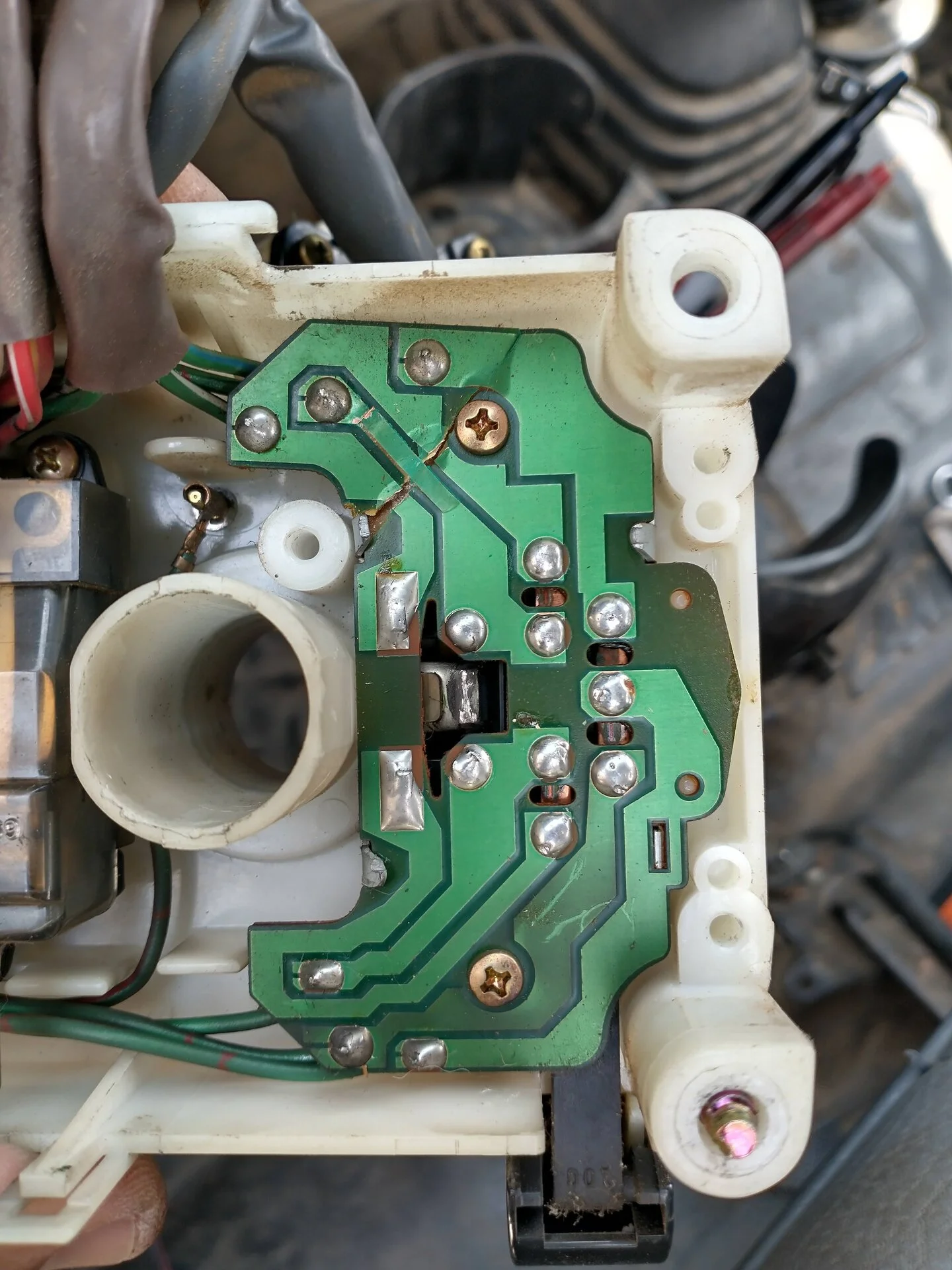

Hopefully the used one doesn't look like this...
It’s probably just a part number supersession.

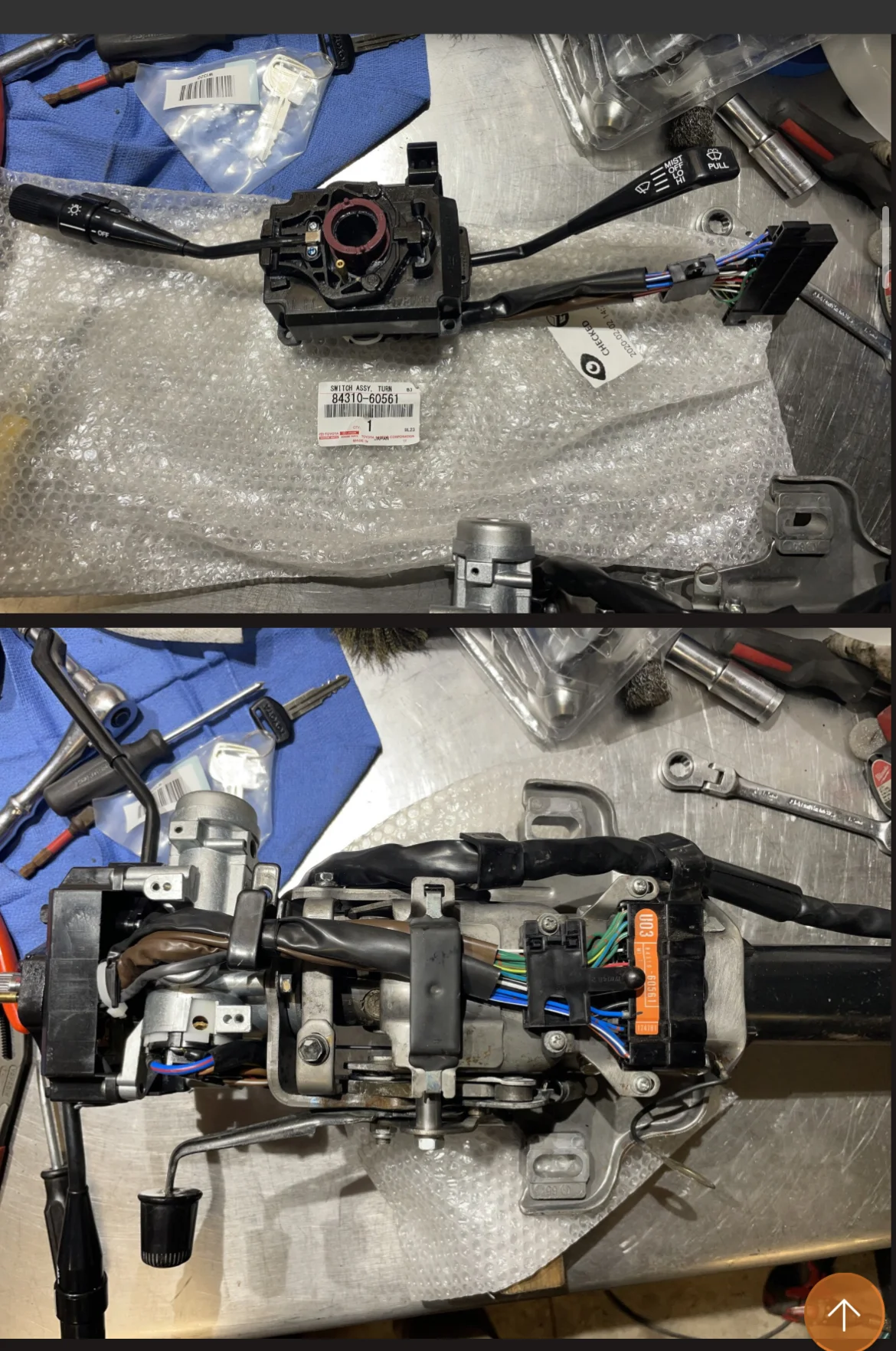

I used 84310-60561 on my 79. It has the same old school connectors in use from 1984-6/2009.
