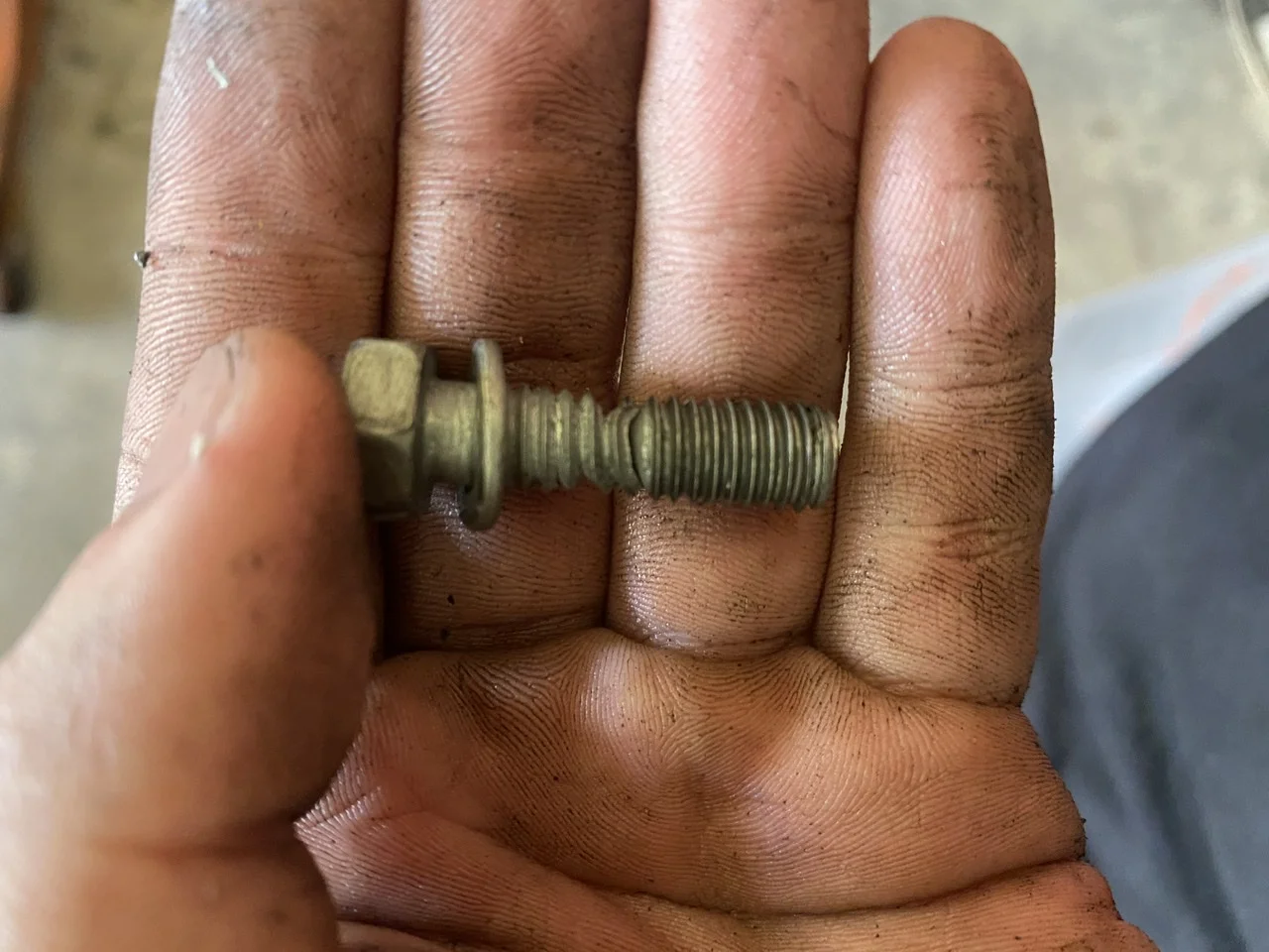

No, no EDIC. The 13bt shuts off air rather than fuel, but I think I may have found the problem. Spraying starting fluid on the intake side I found what may be the brand new intake manifold gasket to have blown out on one corner, broke the bolt trying to tighten it more. Waiting on parts and hopefully it’ll fix it.

I think it’s this intake gasket, vacuum pressure is good as it actually maxes out my gauge, and the VSV closes fully. Waiting on parts and hoping that the bolt broke rather than the intake manifold!

Hey guys, just wanted to give an update! Replaced the intake manifold gasket and added some high temp spray sealant on it to hopefully help it not blow out again. While I had it off I went ahead and gave the injection pump a couple turns on the screws right there under it that help the midrange fueling. Seems to boost a little faster now, need to mess with the boost compensator. Surprisingly, the bolt I thought I snapped wasn’t totally broken and pulled out just barely holding on to a thread!
