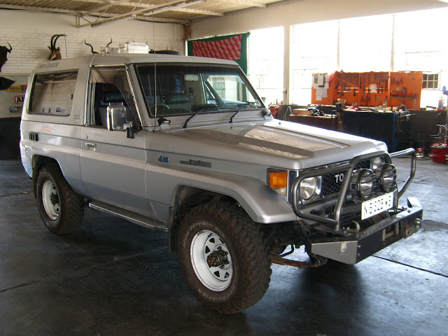

I just bought this beautifull 1987 BJ74 with PTO Winch and full Lockers (not sure whether this was std on all of them). I was surprised to find out that even the seats are on dampers and move up and down on bad roads.
Hence my question, are these serviceable or would they need new dampers after many years etc. Where can I find more Info??
