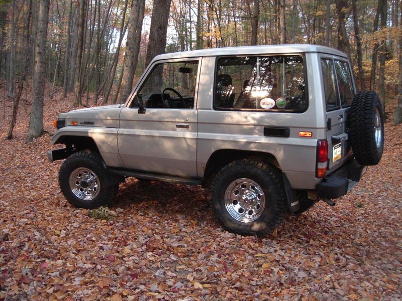

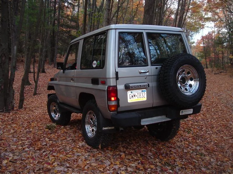

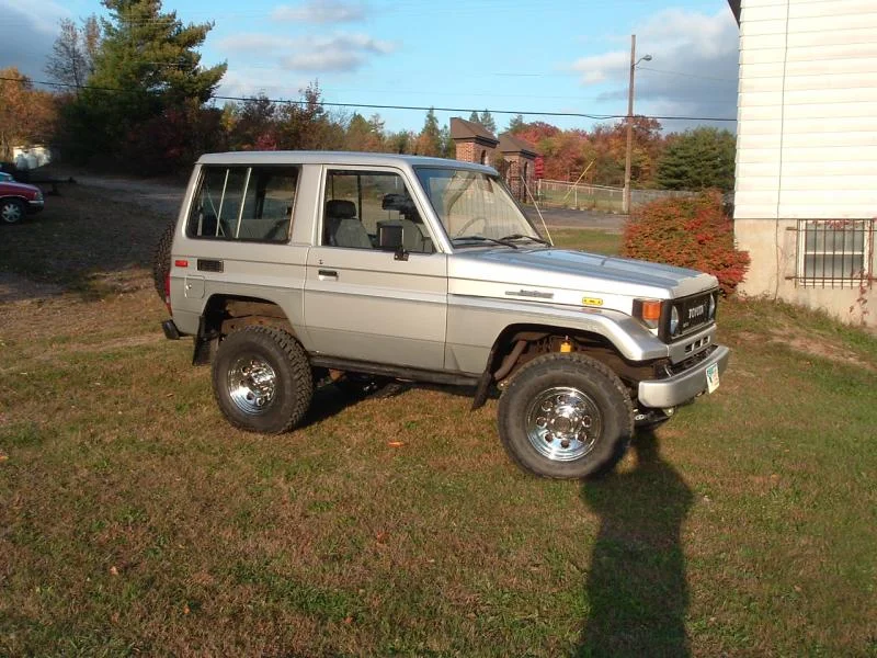

BJ70 photos
OK boys, heer's a few shots of the BJ70 as it sits today. Had her out on the mountain this afternoon, first trip for me in 4WD lo range. She works just fine. Whaddya think?
Nice 70. She looks like she will give you great service. Being an '85, she has a 12 volt system which will allow you more options for lights/radios/winches than an '86 or an '87. Congratulations on finding her.
That's a sweet truck! Nice!
