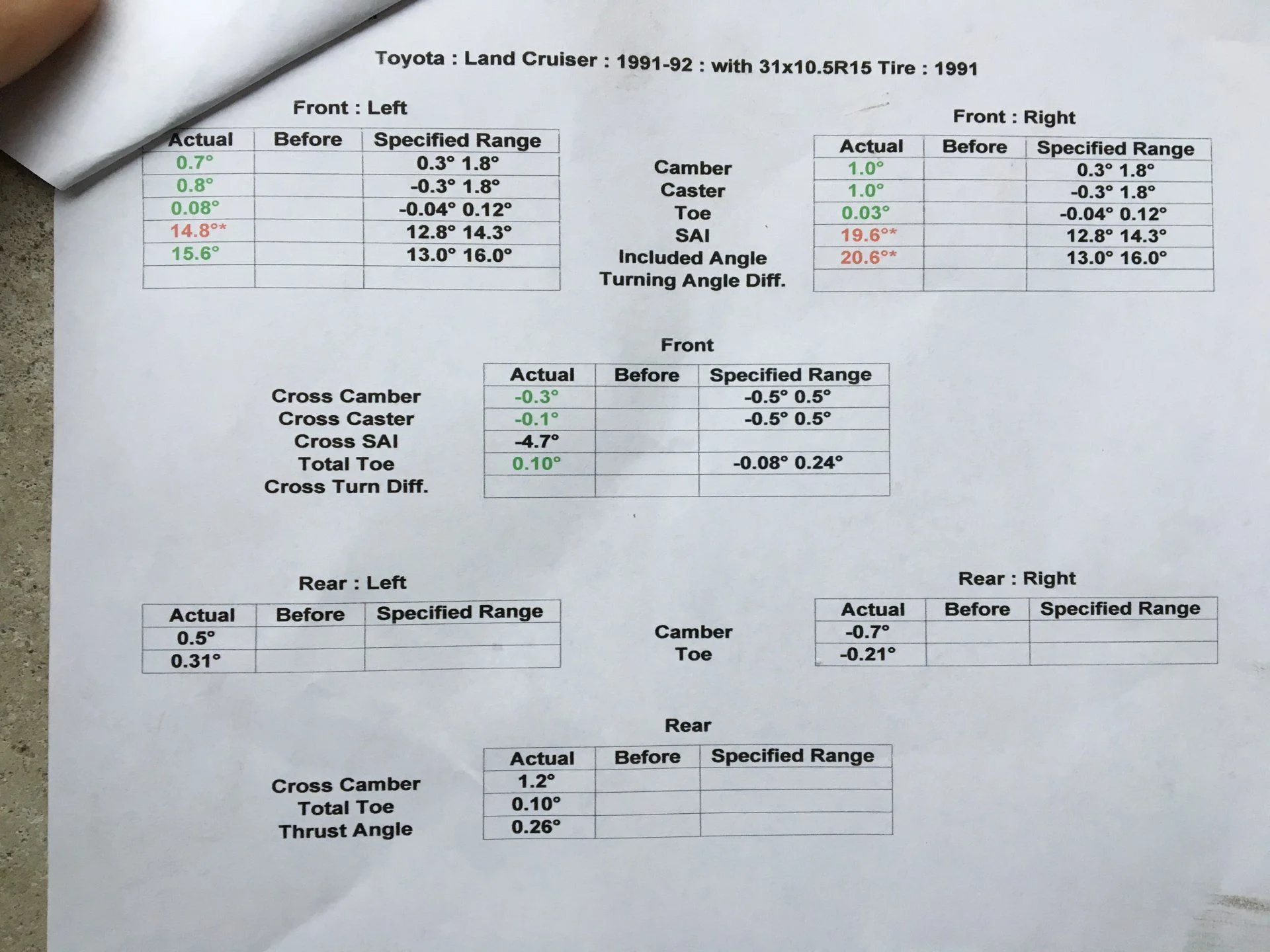

Mine. Seems to drive well. I would like the "return to straight" to be smoother. Steering is a bit heavy (which I like). There is some slop in the wheel but that is likely due to the steering column. Overall happy with the feel.

View attachment 1389894 View attachment 1389895
Good job. Being a RHD JDM model, it was aligned for left side crowned roads, which caused mine to drift hard to the right. After alignment, it stays centered beautifully. Mine is an '88 and still has under 60k miles.
So I did some highway driving and it feel phenomenal. At 90km the truck tracks straight as can be without hand on the wheel. No more wandering (which I wasn't sure if it was the skinny 33x8 tires or the doodoo steering linkage).
