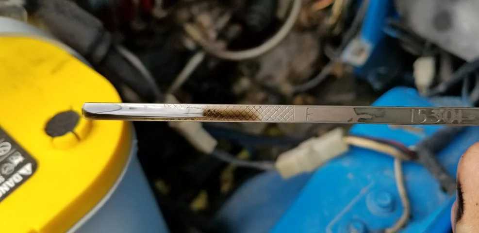

Not Sure if this is low enough to trigger the switch... Any clues?
Its not an Oil level problem that causes the EDIC to shut down the engine.. its an Oil pressure problem.
You should get a oil pressure test gauge on your engine to verify oil pressure, if its OK then the oil pressure switch may be faulty or the EDIC controller.
