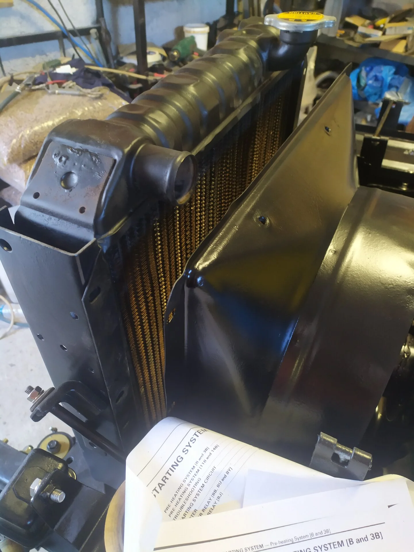

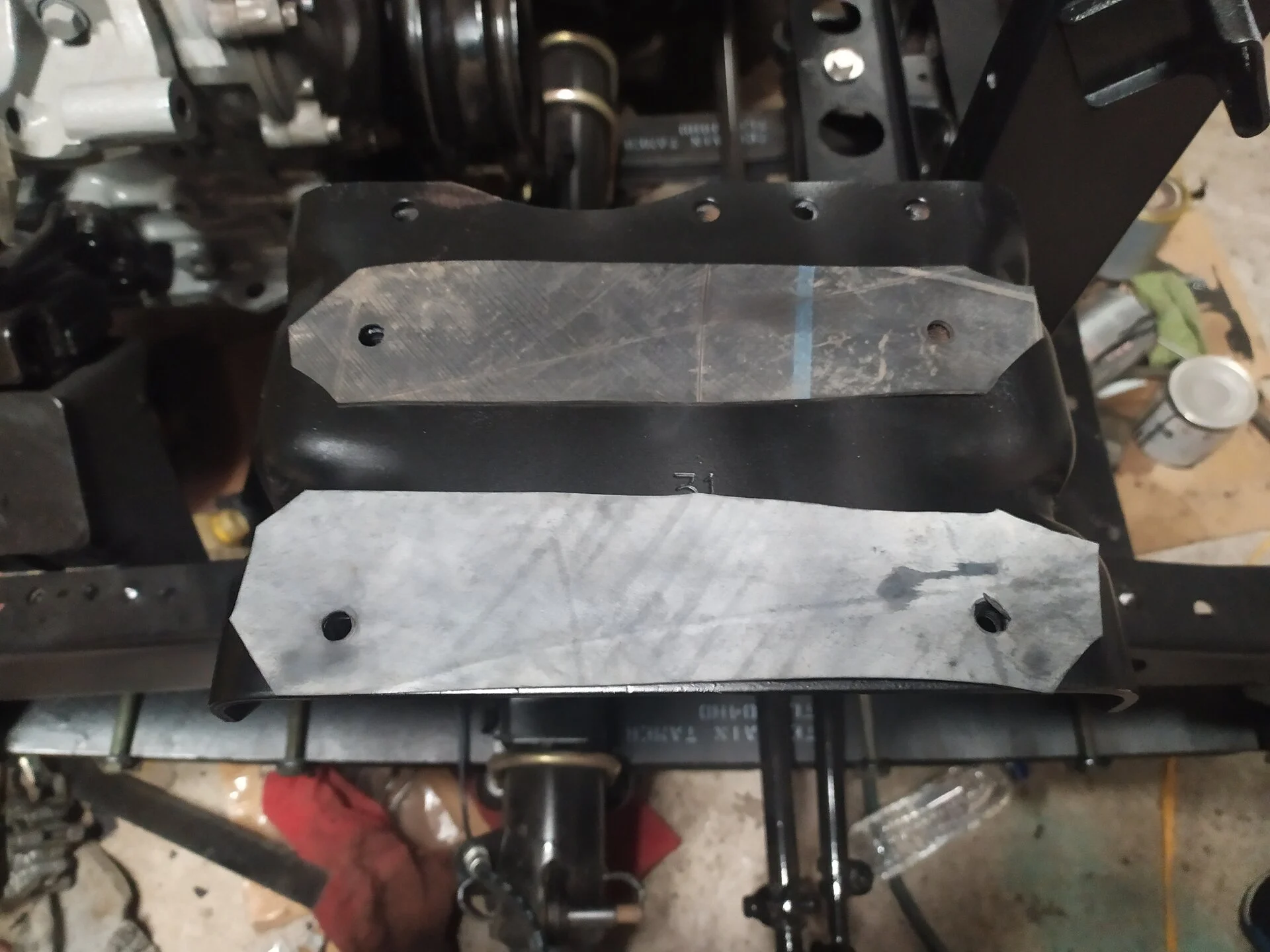

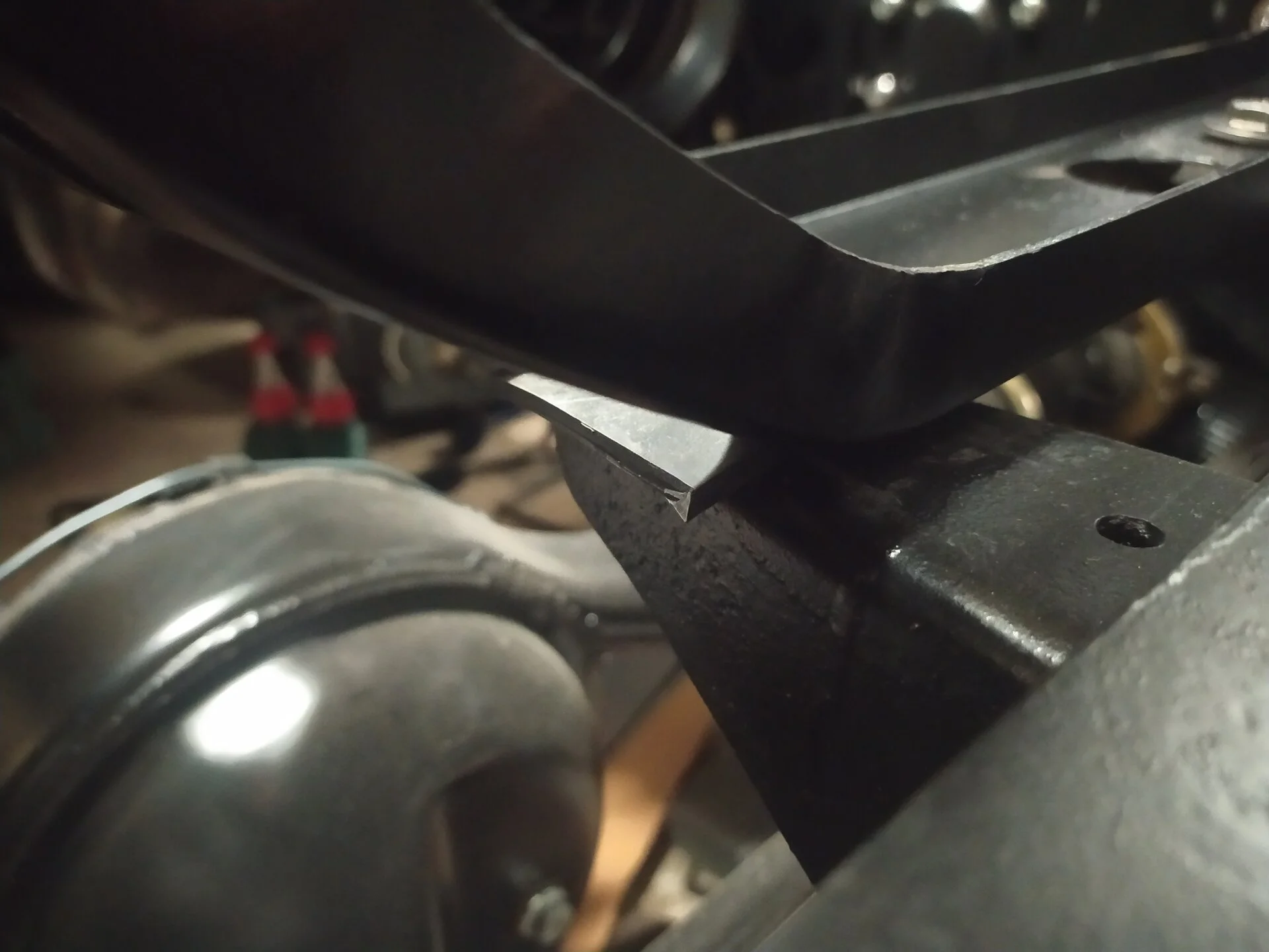

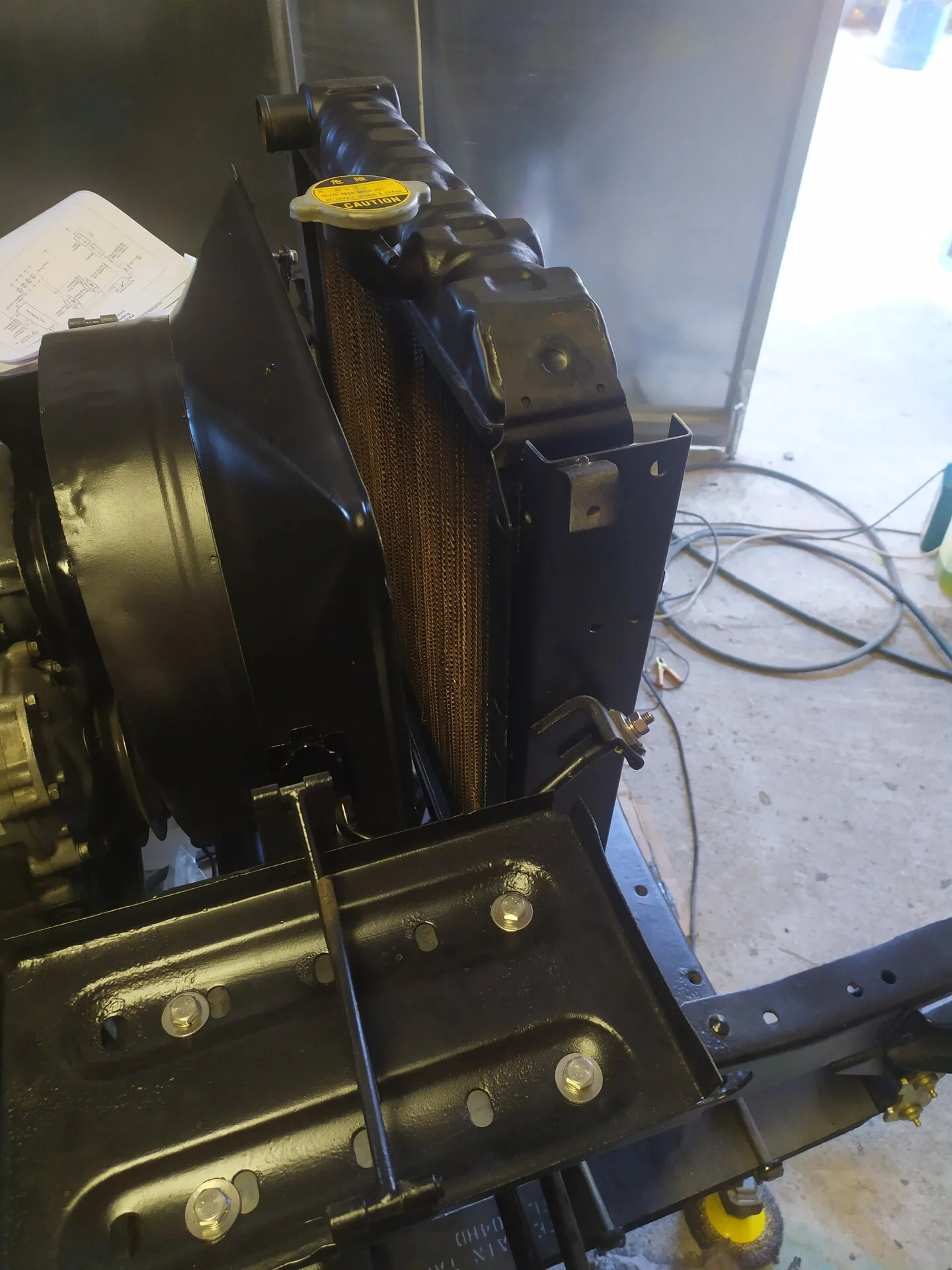

And i installed the battery and radiator bases. Under the radiator base i put a rubber piece to replace the mats it had from the factory, and between the battery holder and the bracket, i put two rubber pieces from rubber inner tube. From the factory it had a rubber paint on the battery holder that did this job.

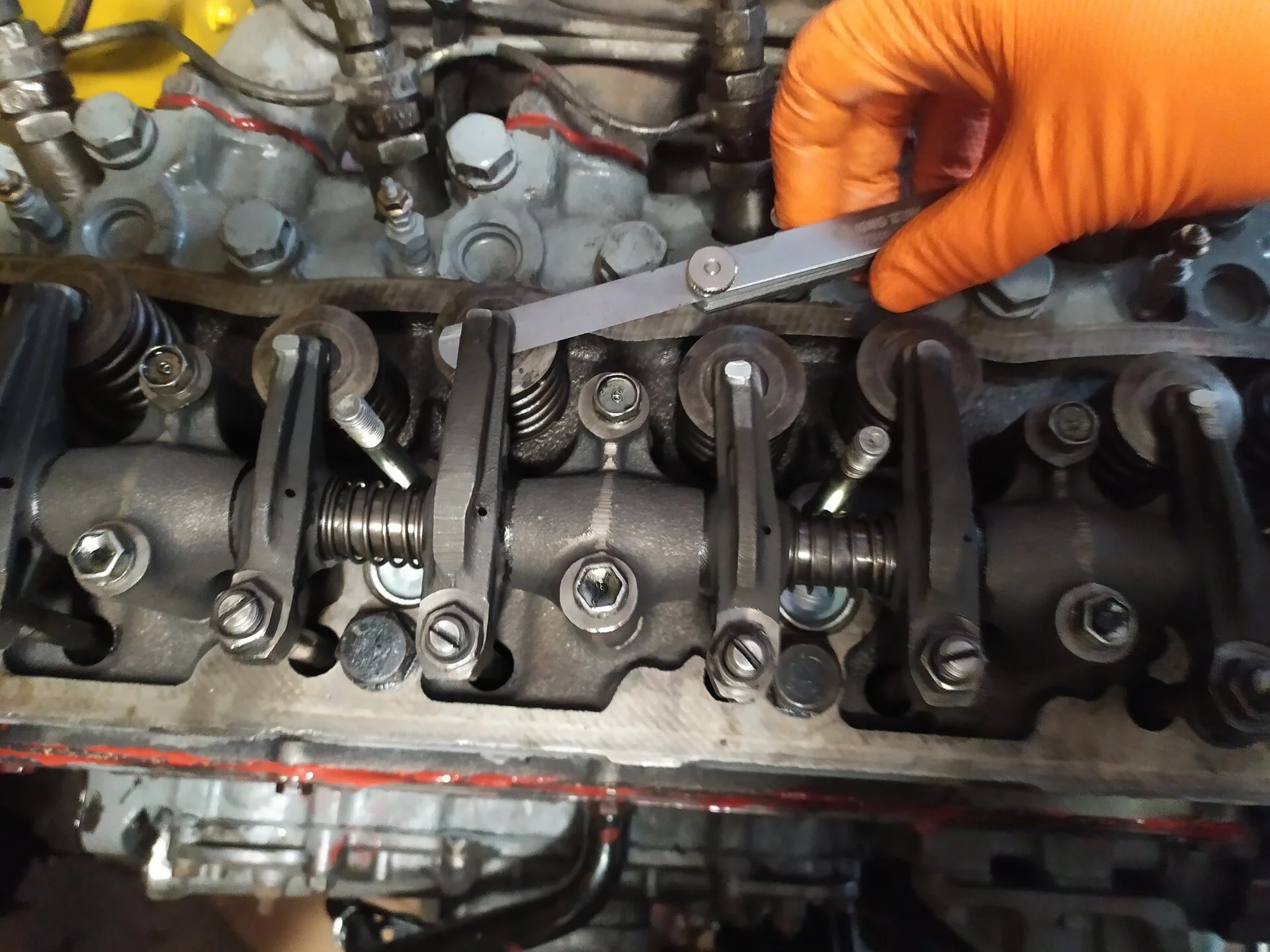

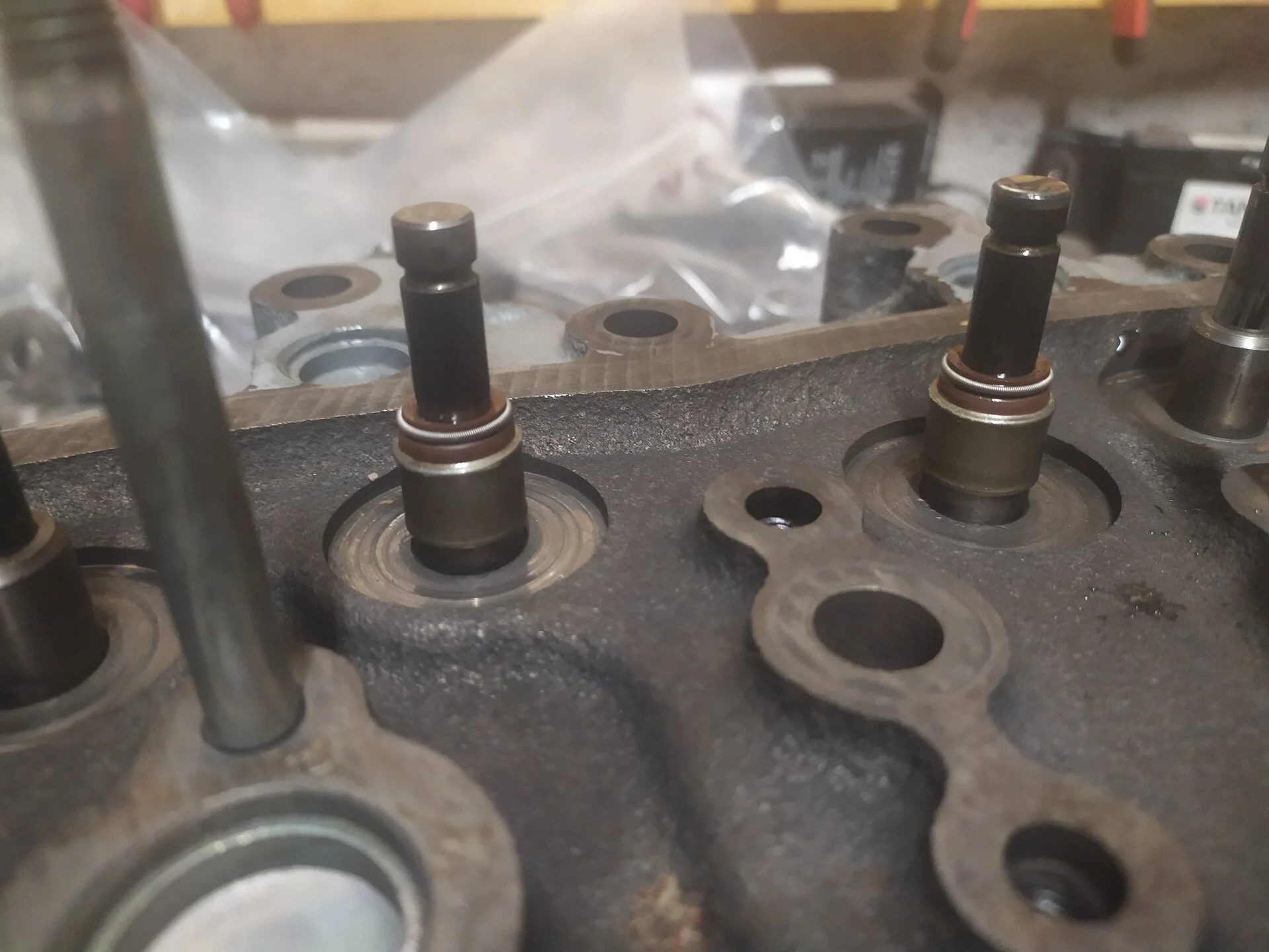

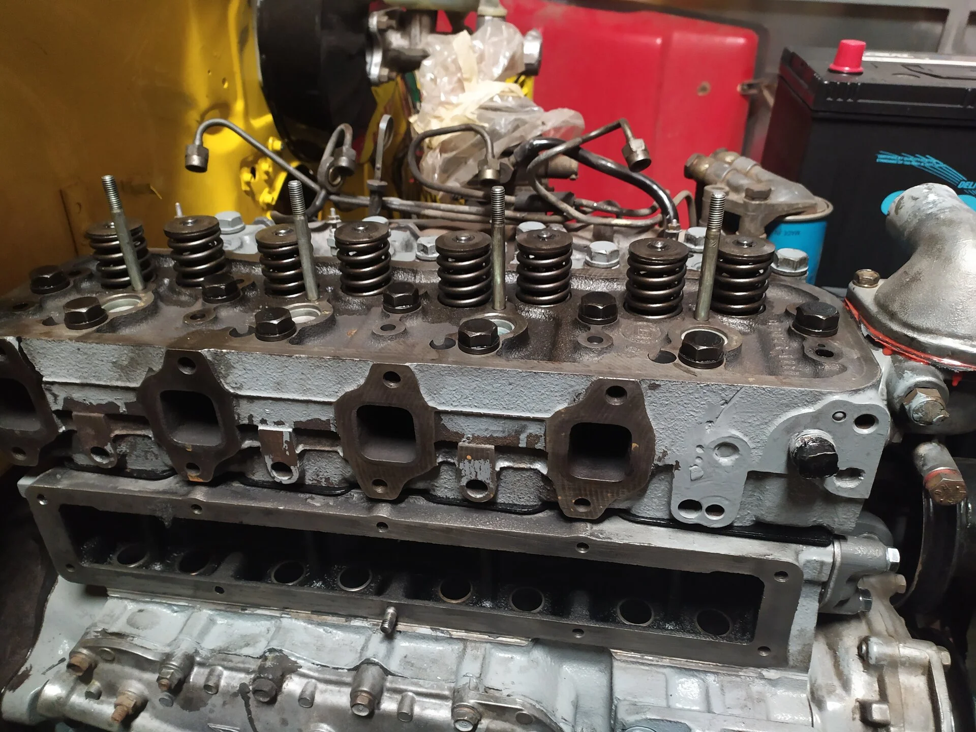

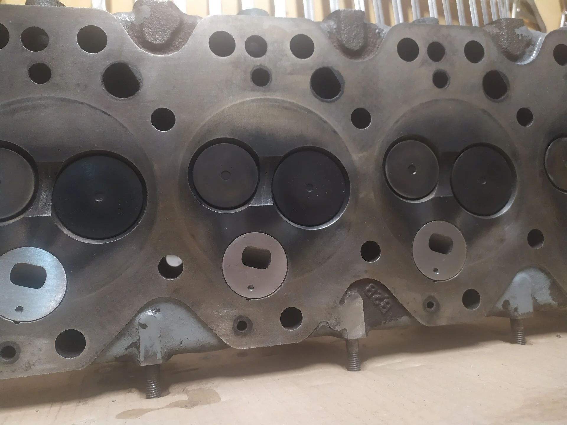

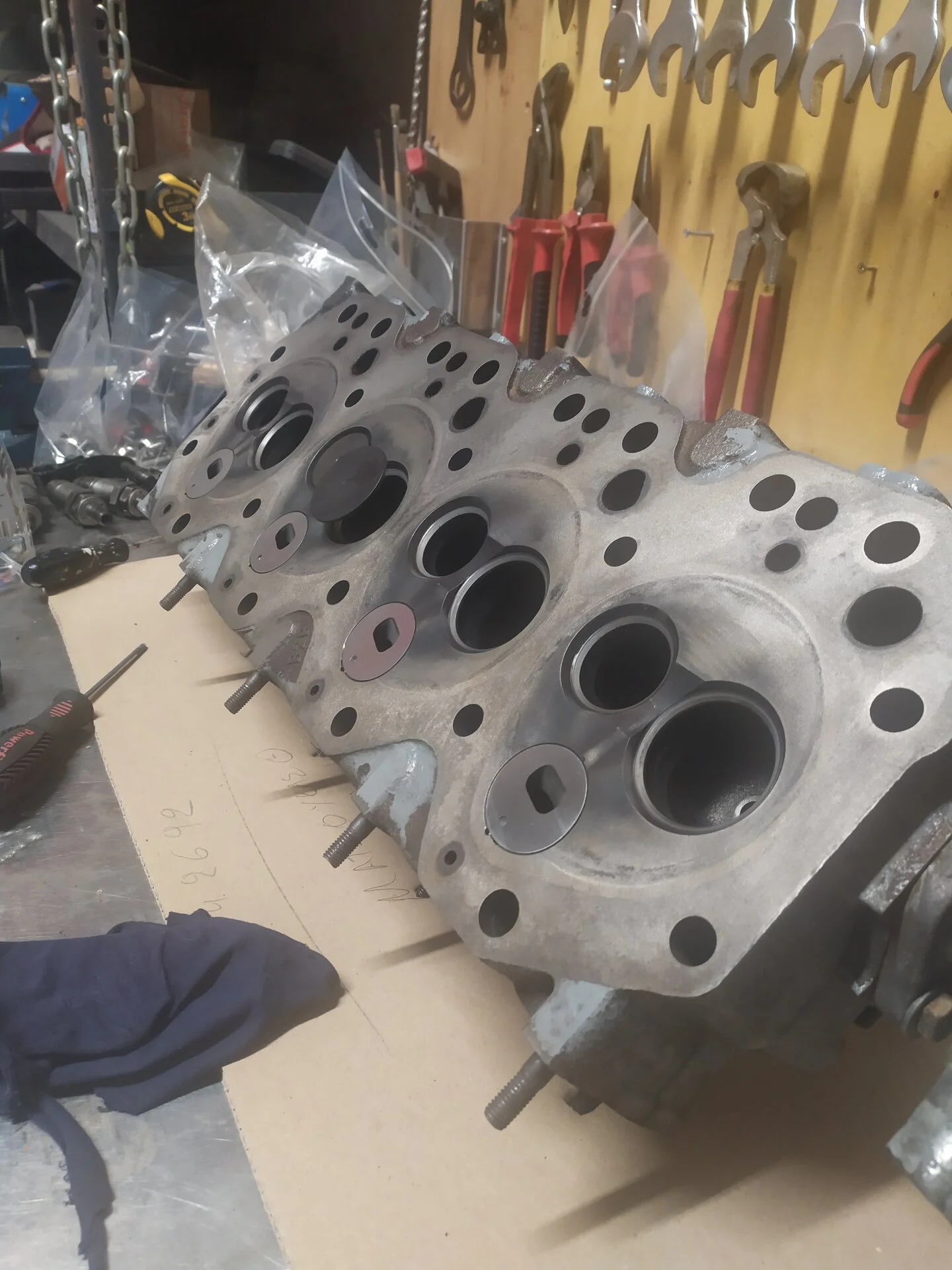

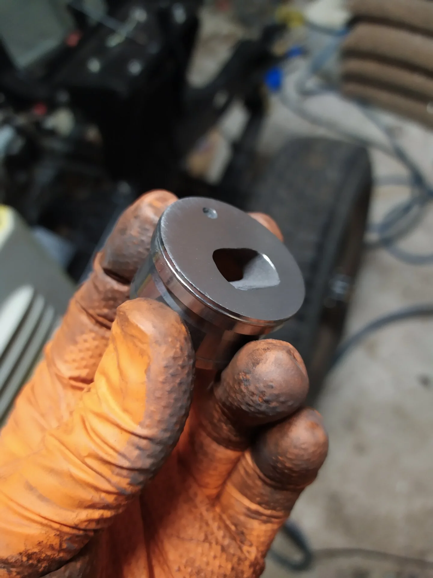

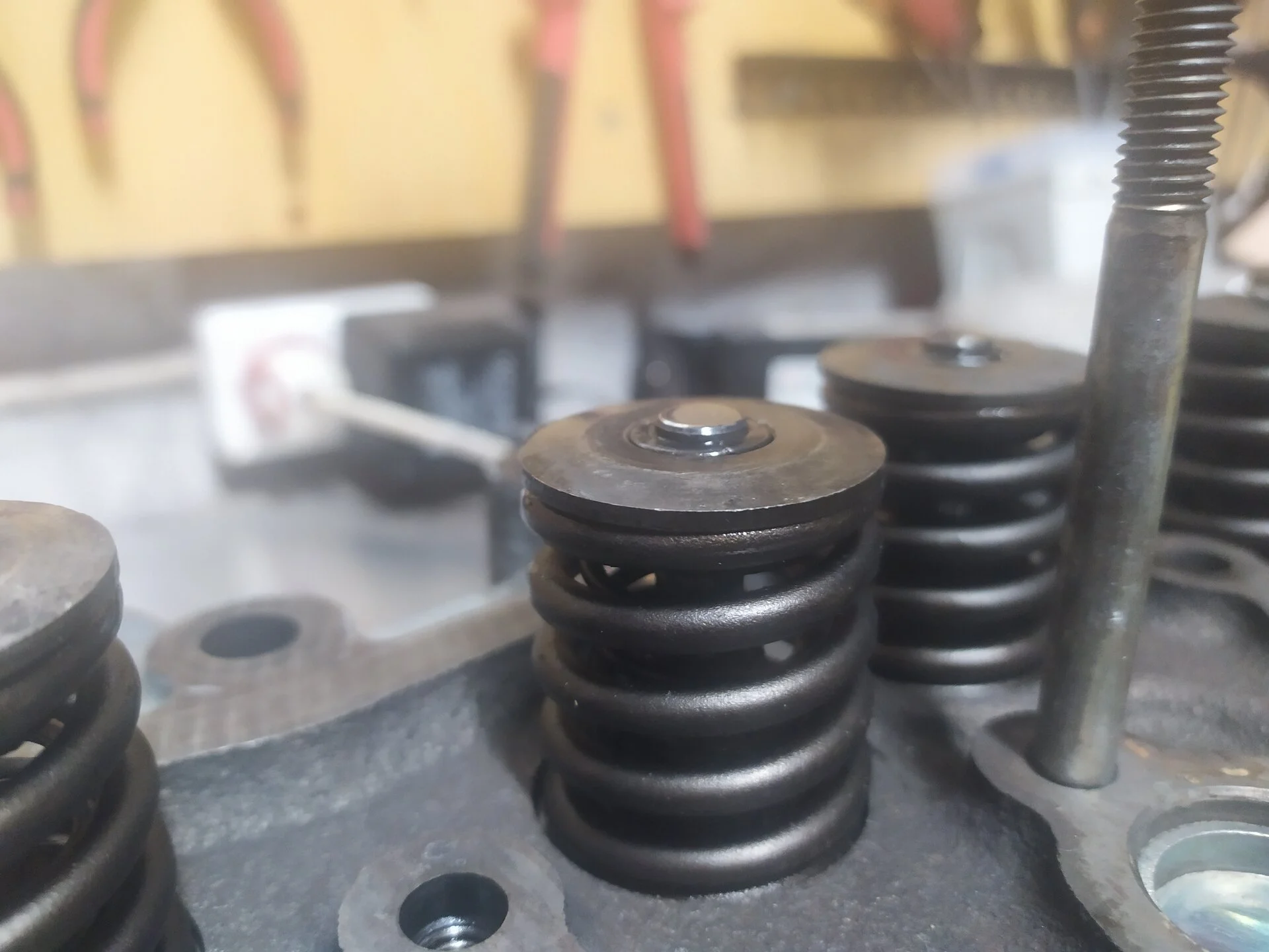

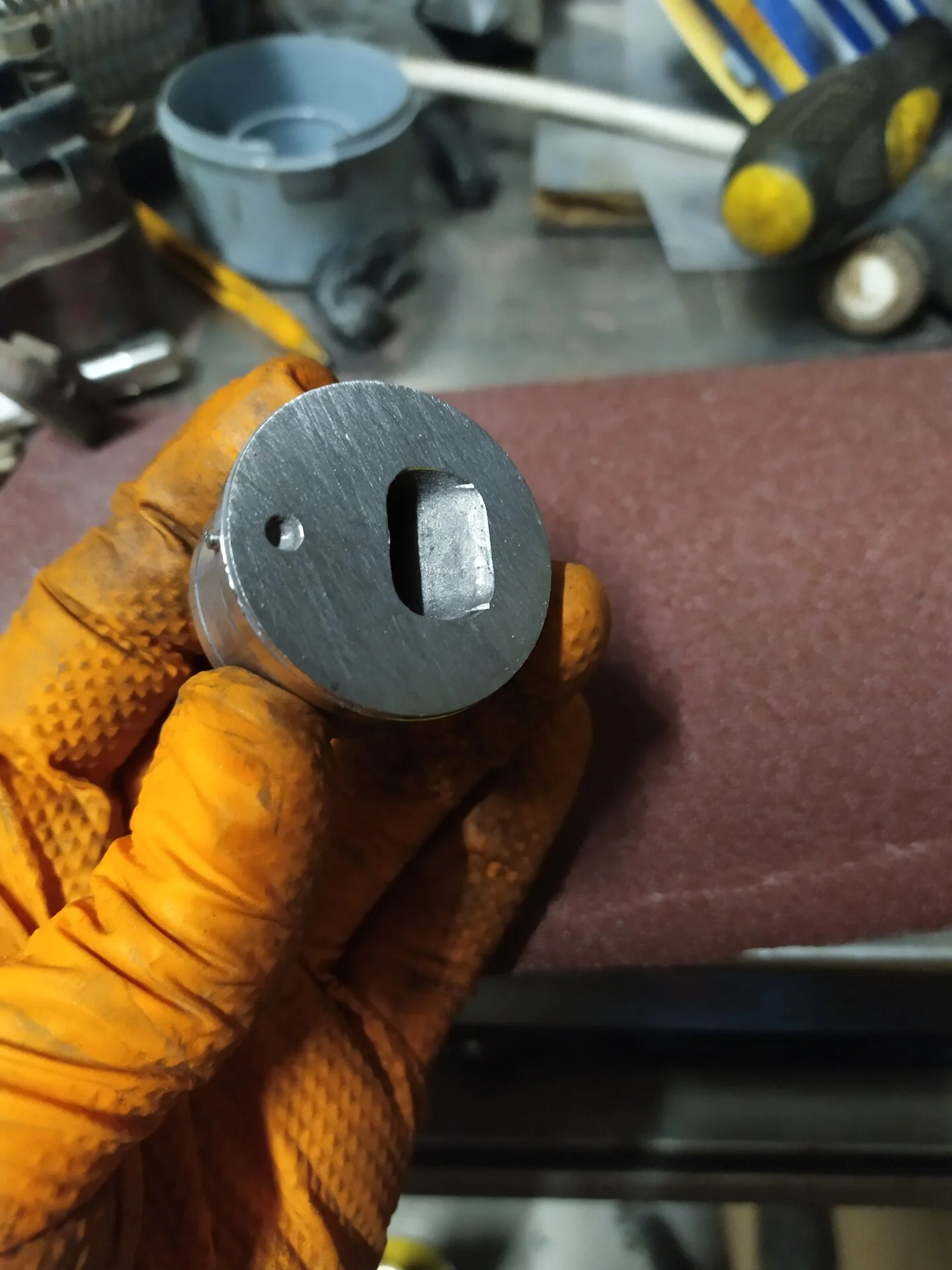

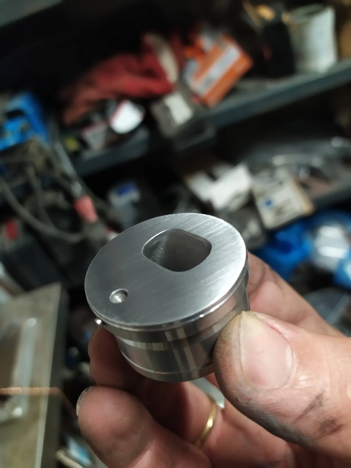

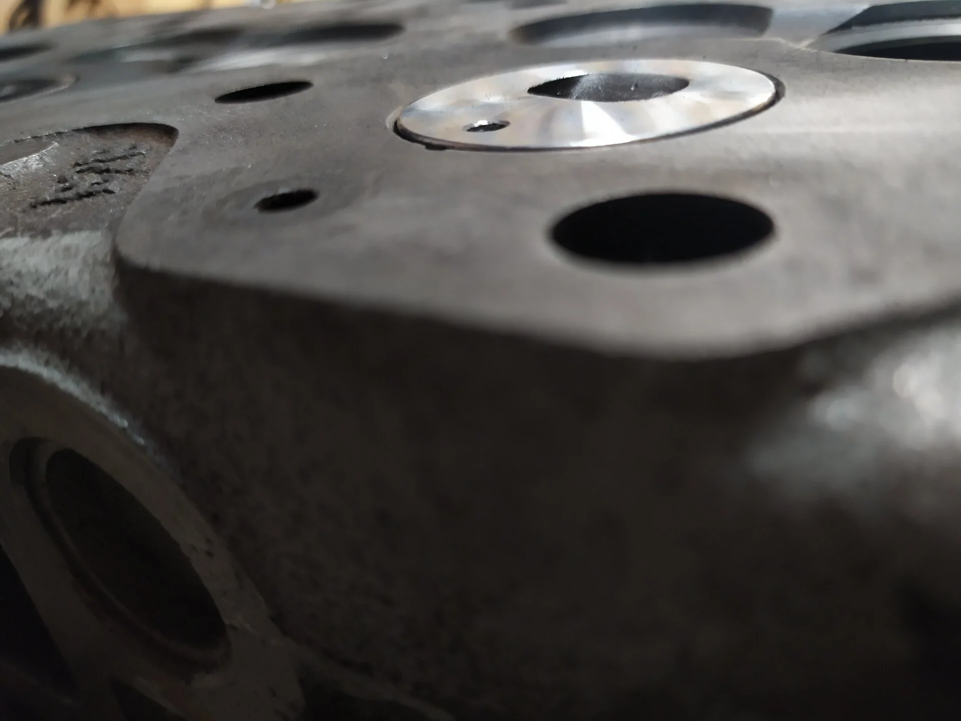

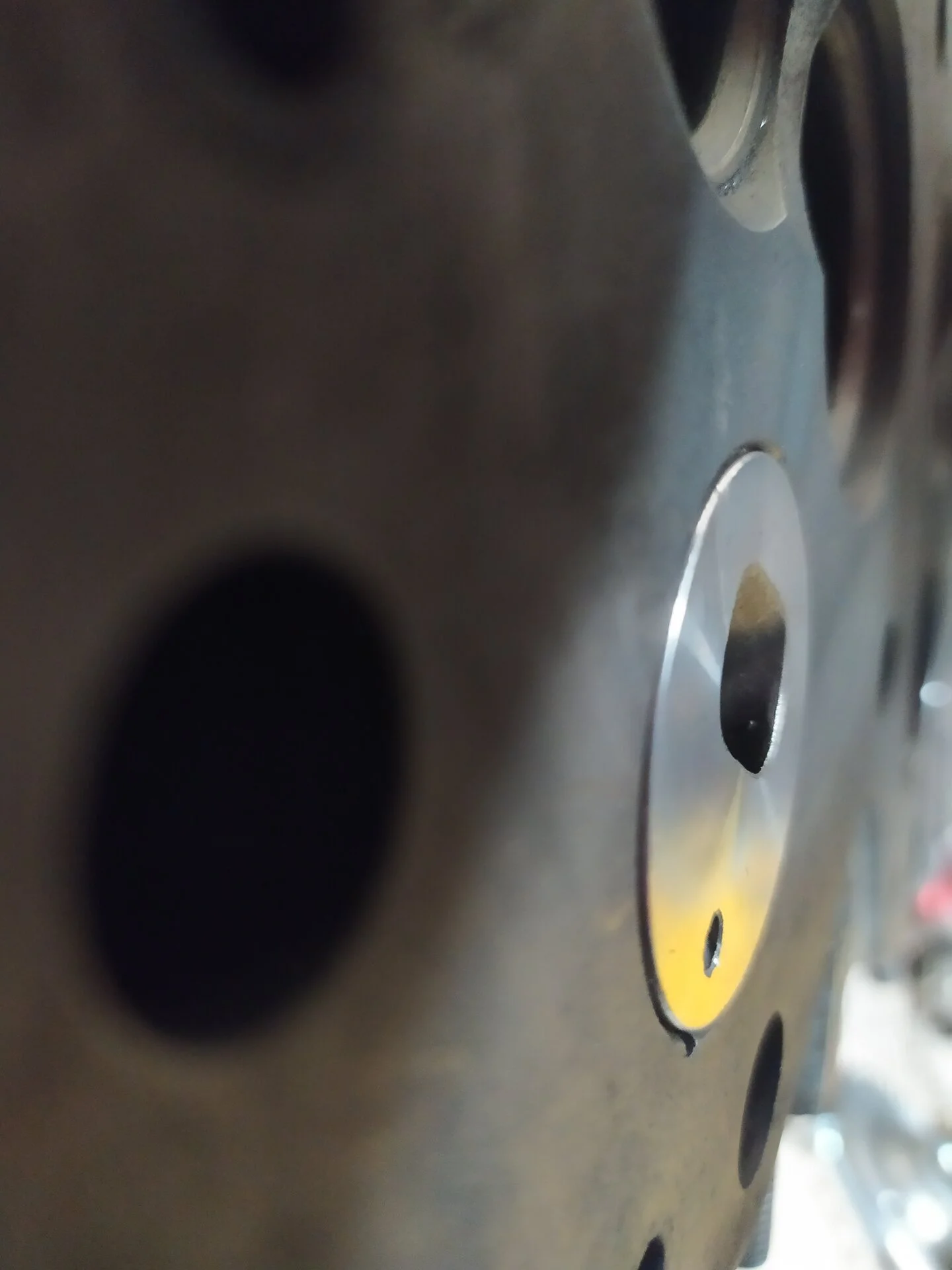

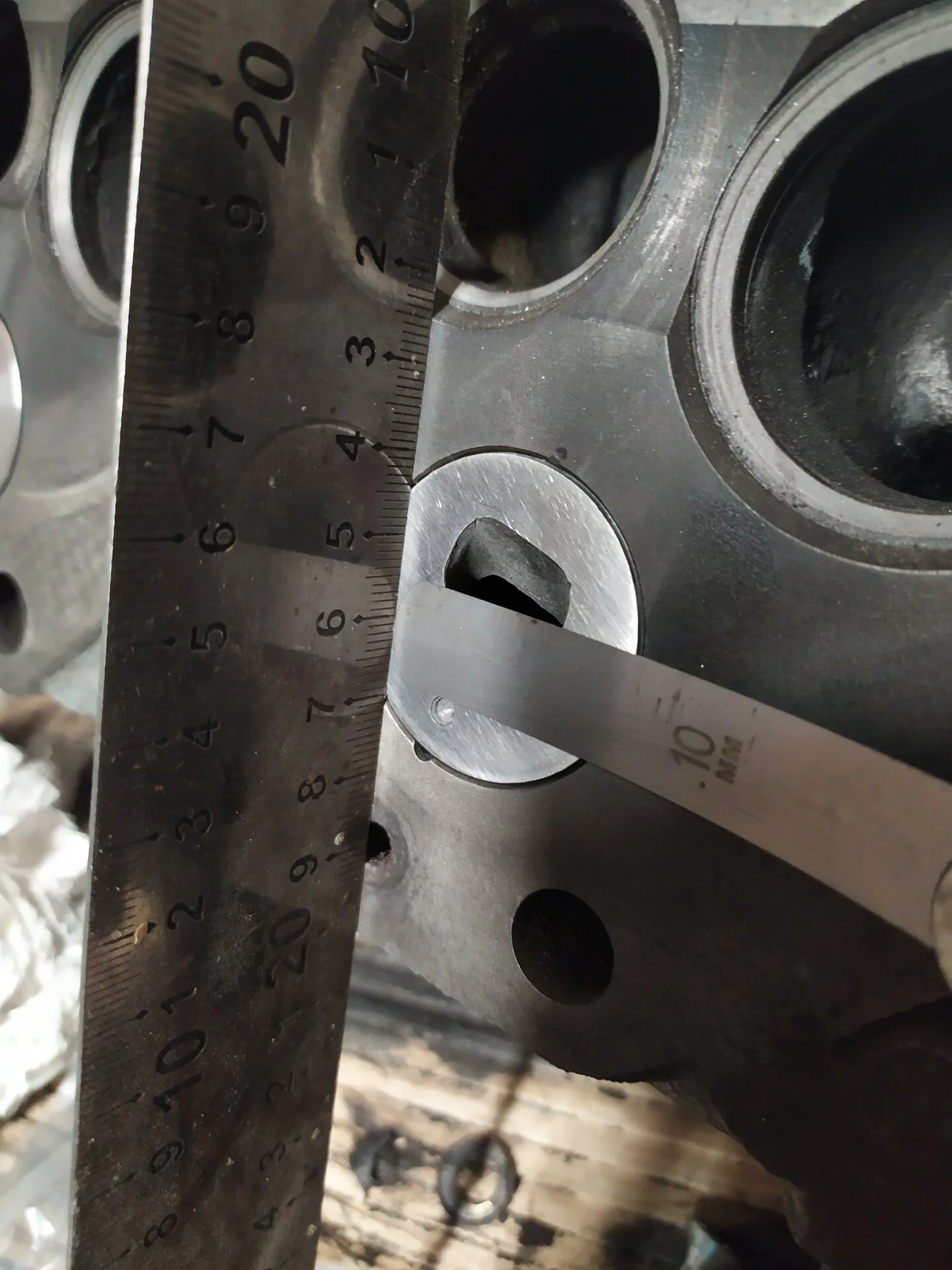

Finally the chambers came.. They were a little taller and they exceeded the heads surface...

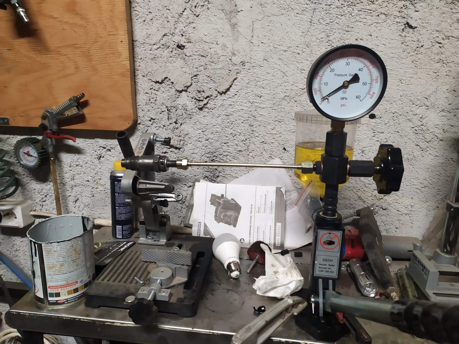

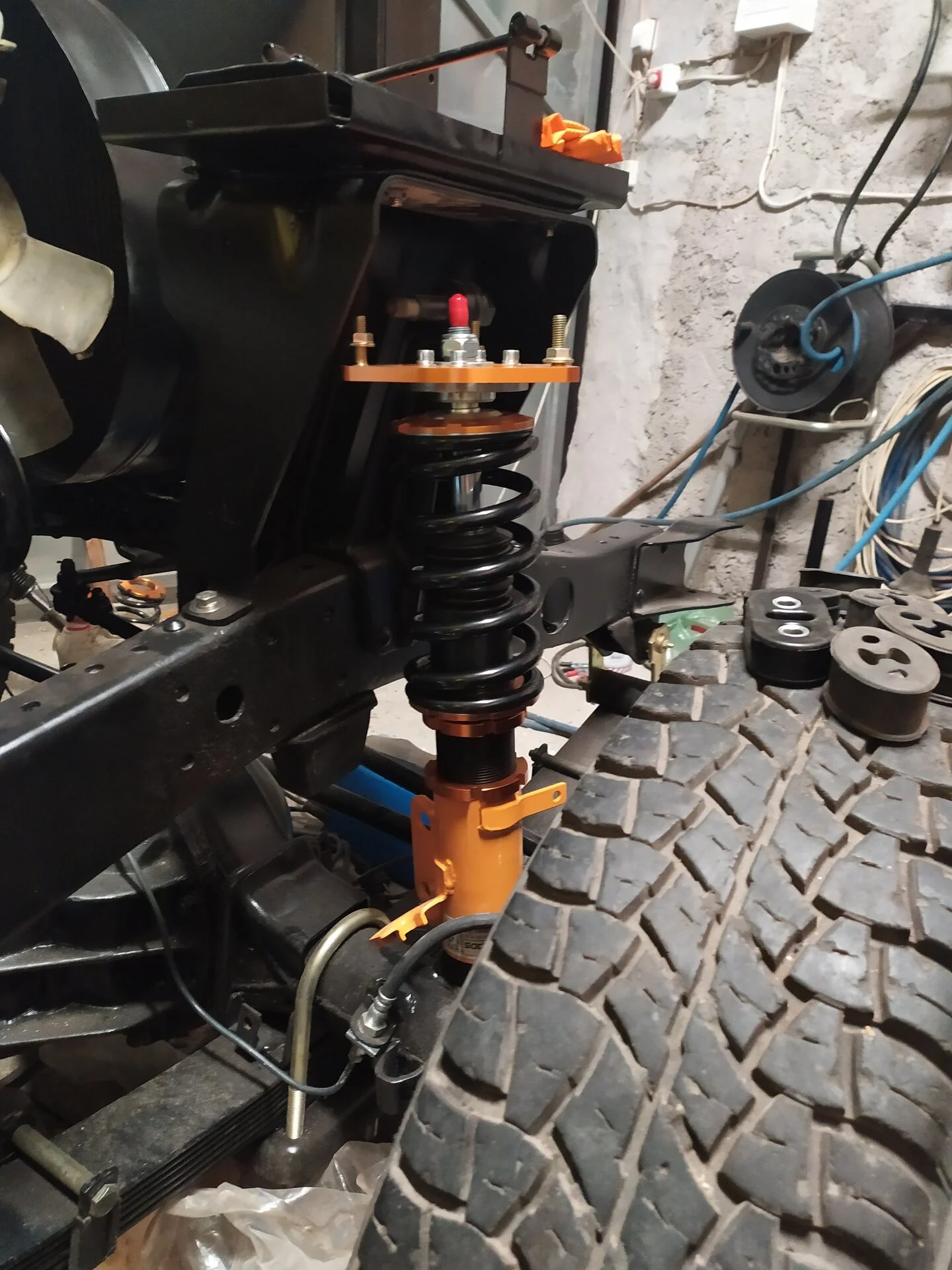

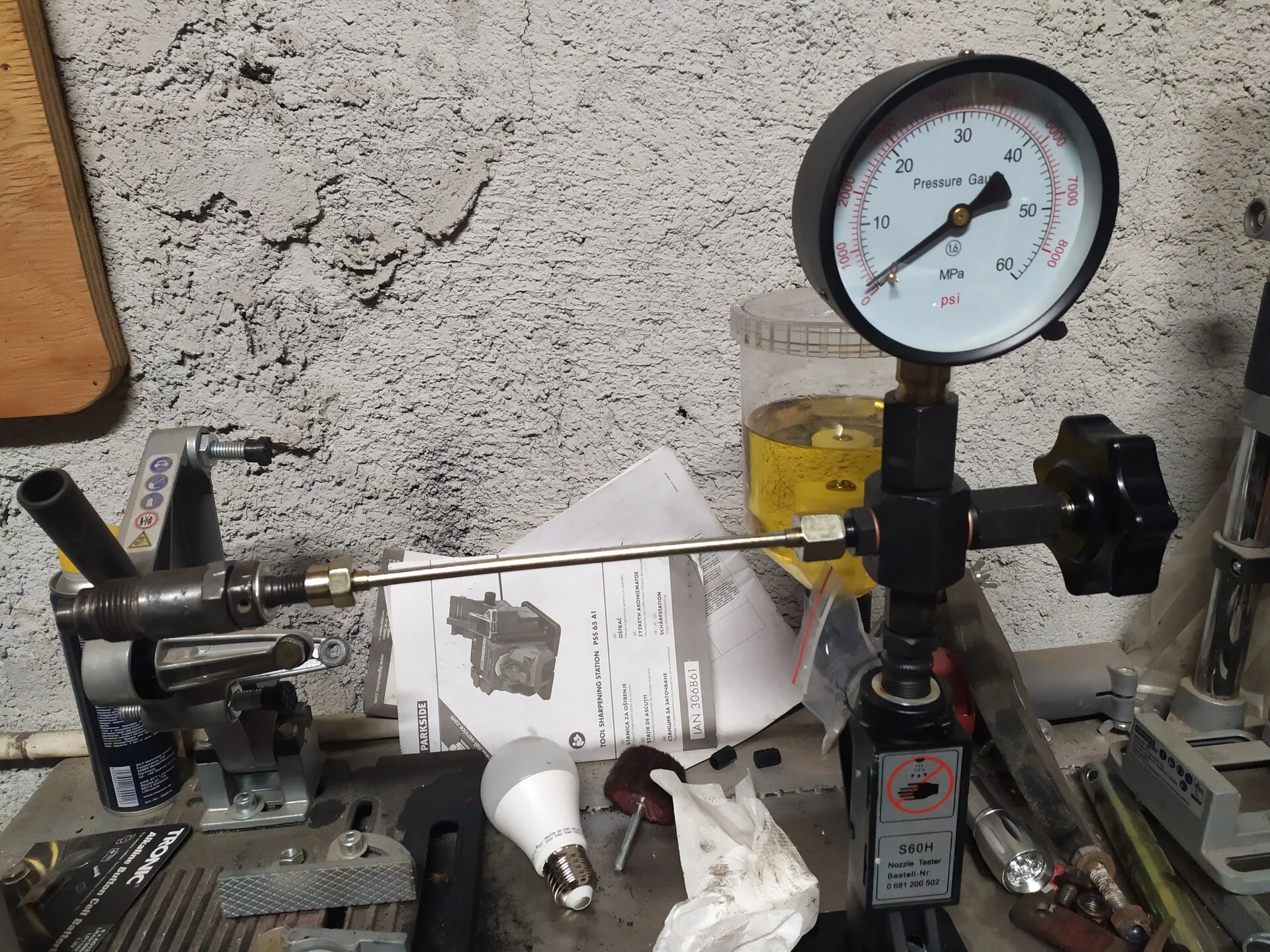

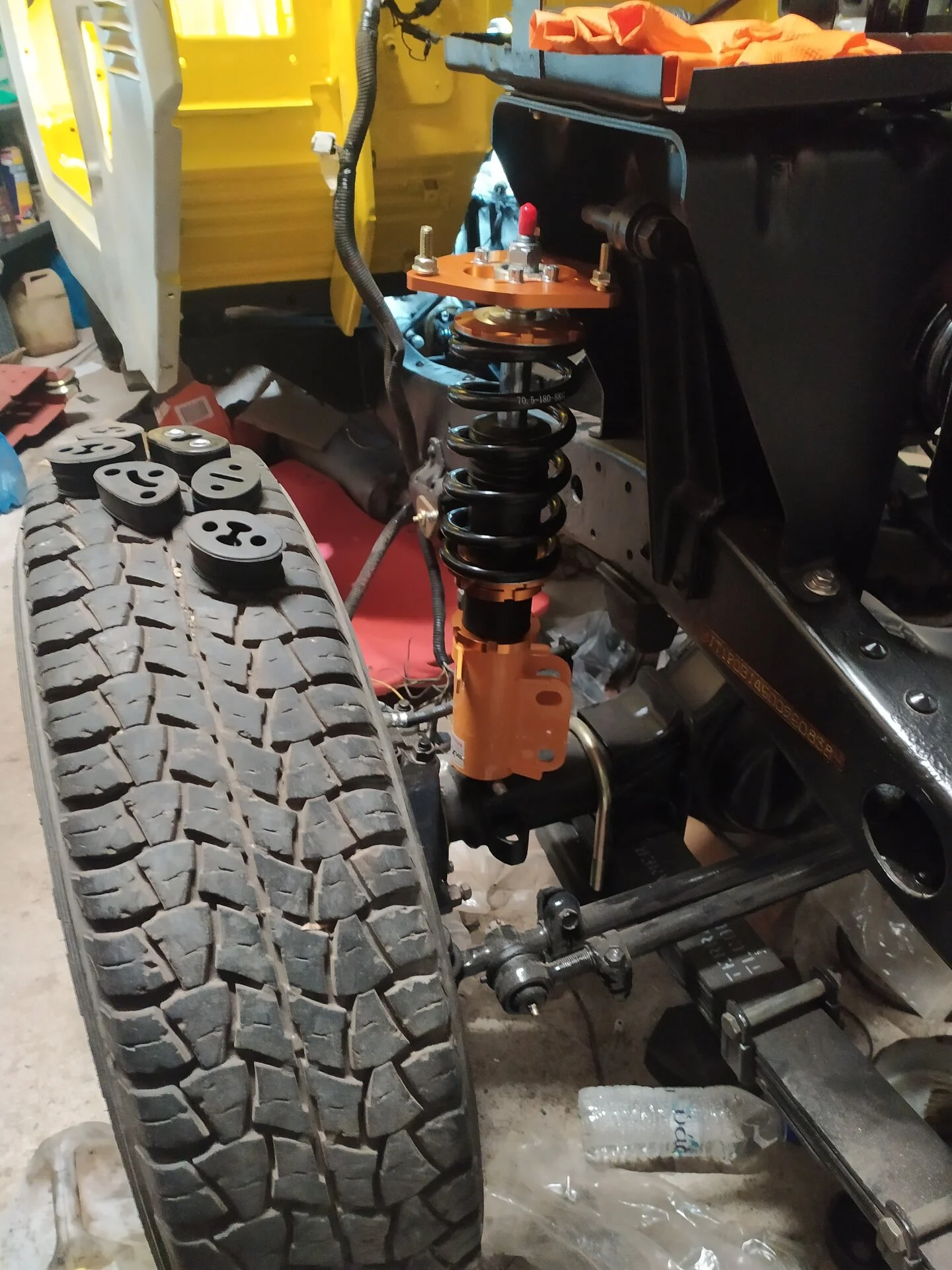

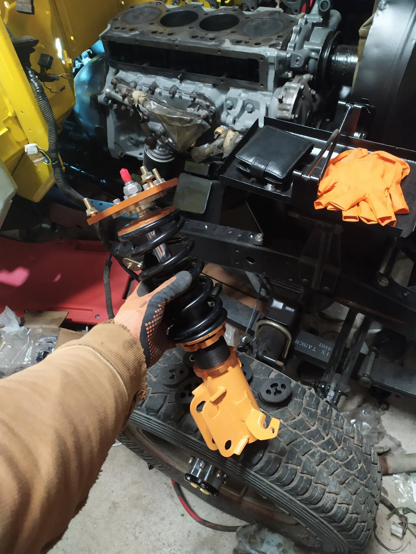

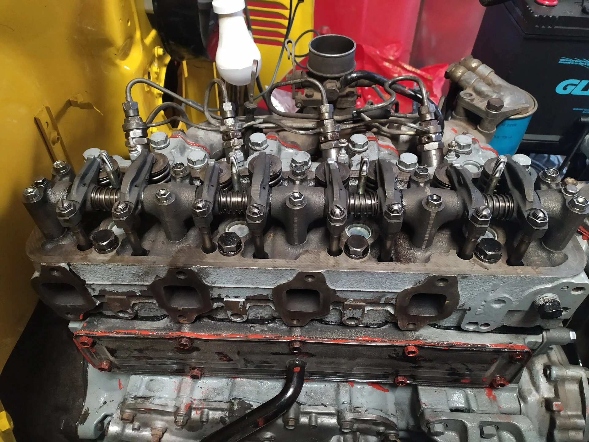

I bought an injector nozzle tester. After i cleaned the injectors, i tested them and they were working perfect. I bought some new coilovers but they didn't fit... 😋😋😋. These are for my corolla...

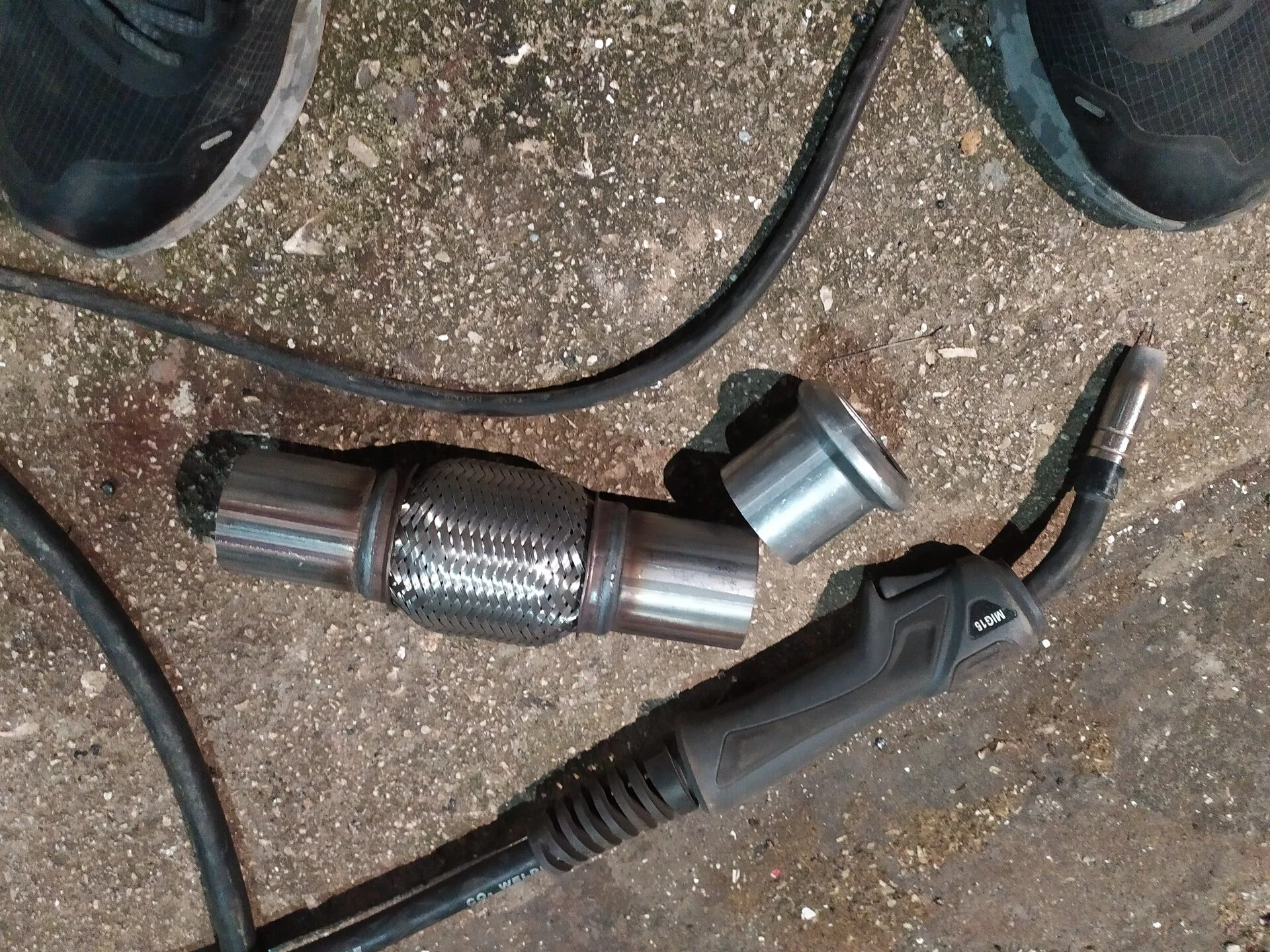

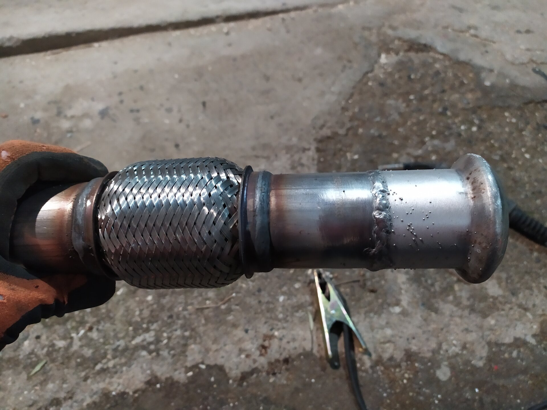

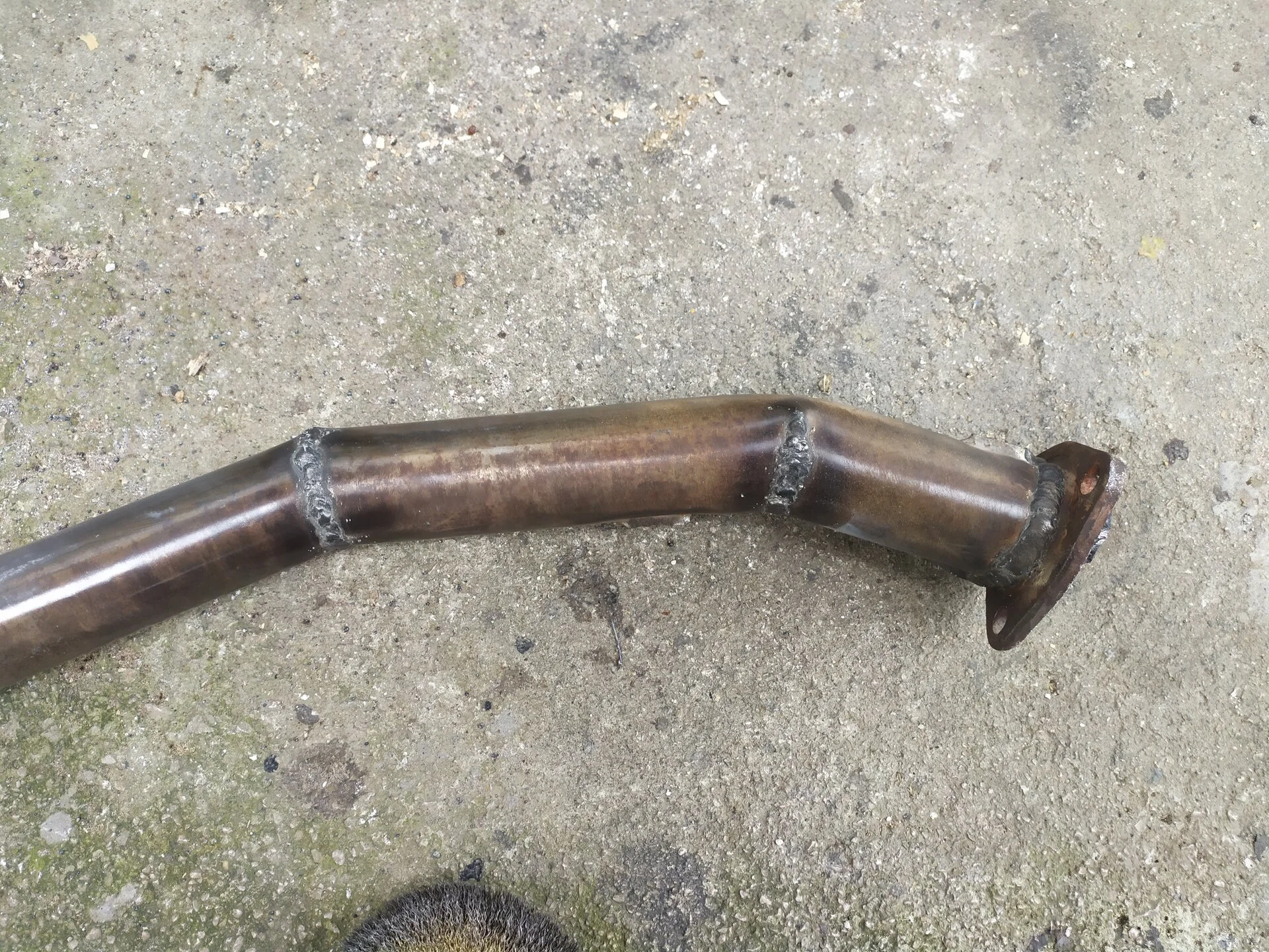

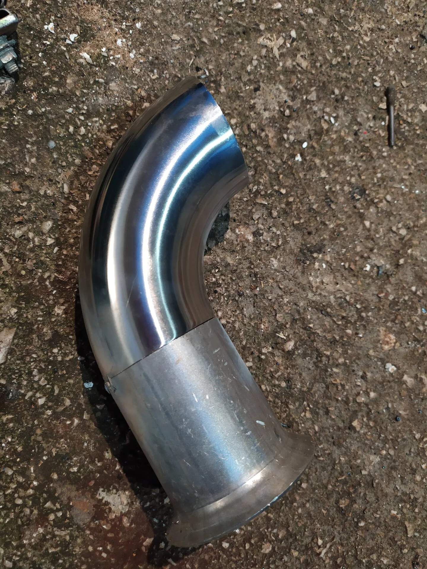

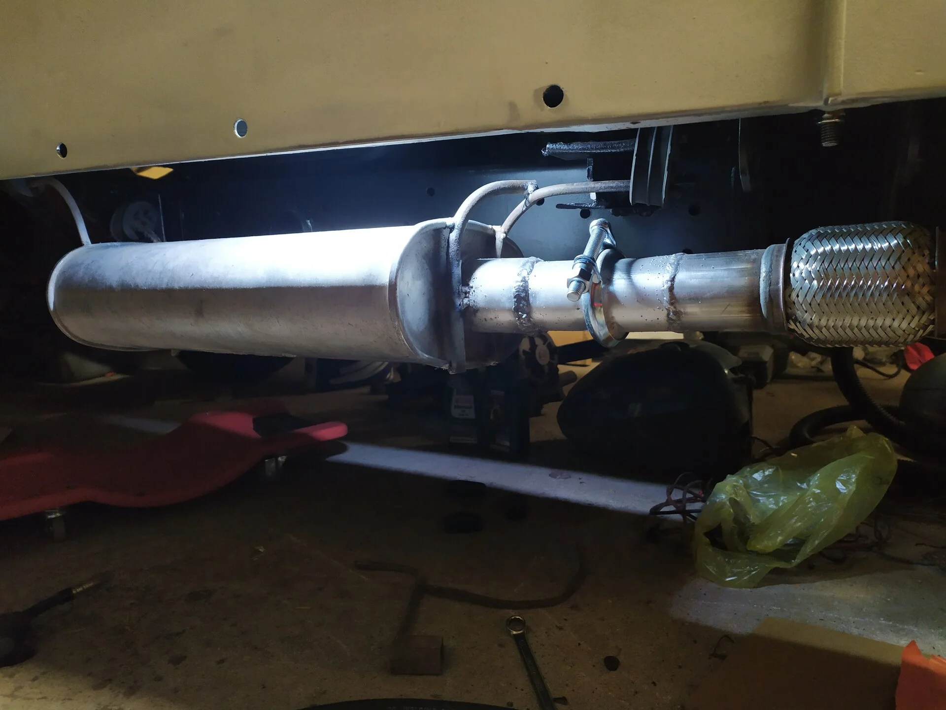

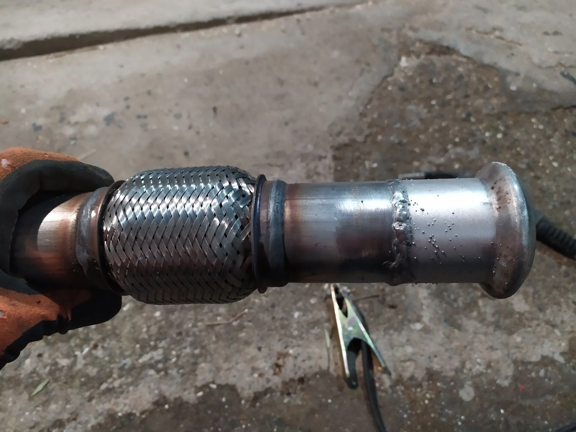

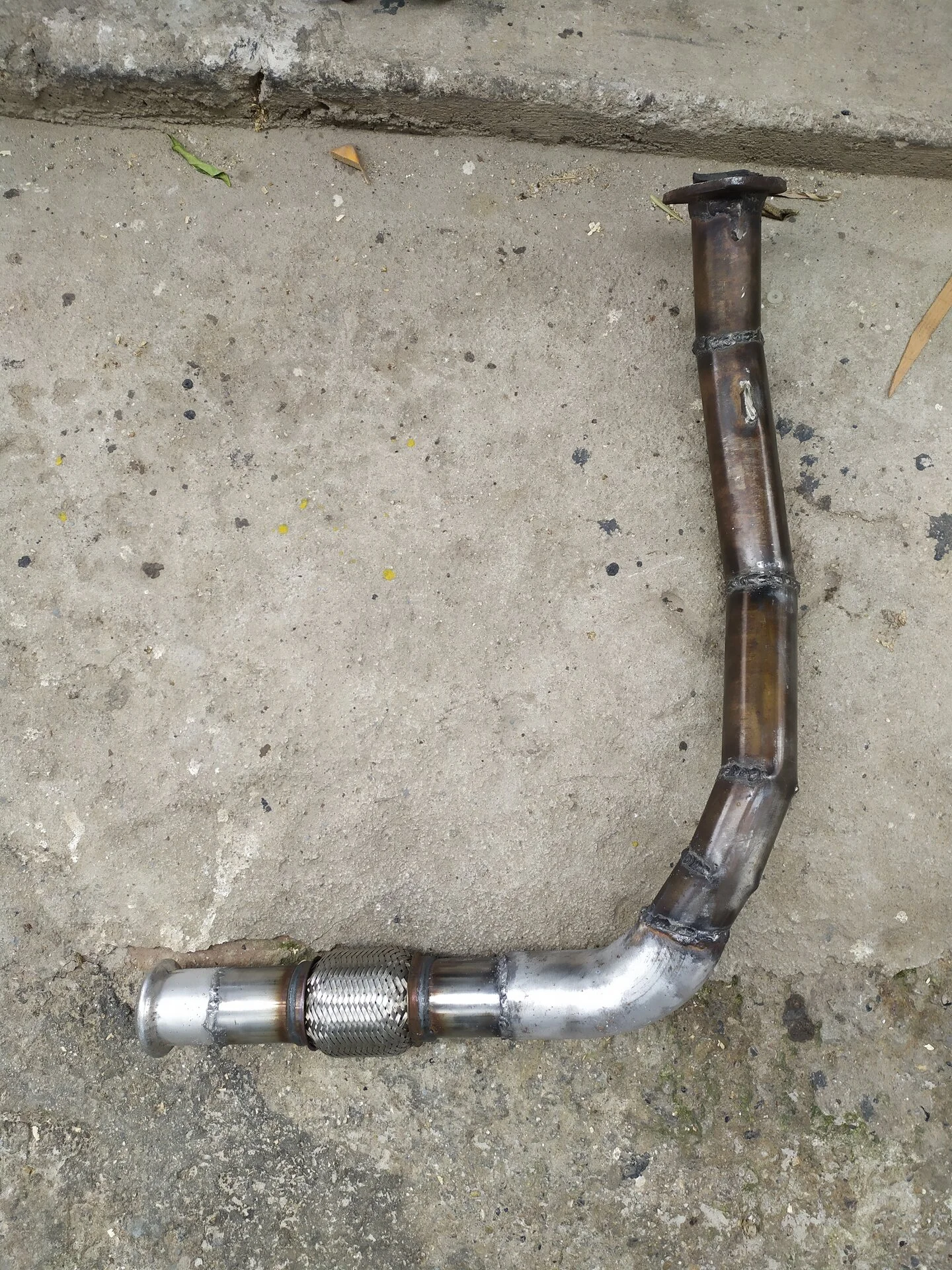

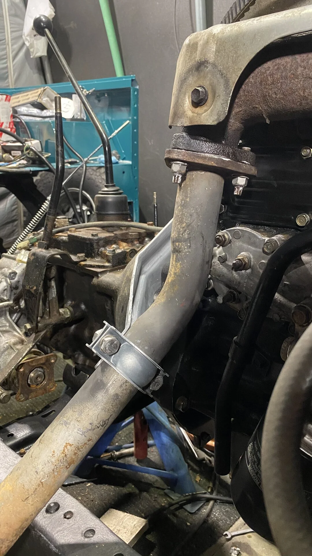

That’s the right way. Shown’s would work if the bracket to the transmission bolts would been installed (painted silver in my picture):

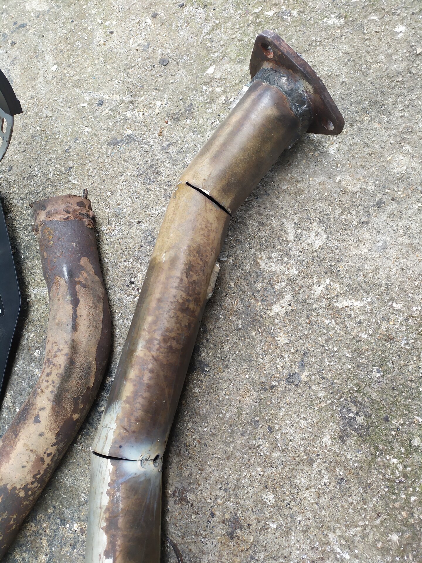

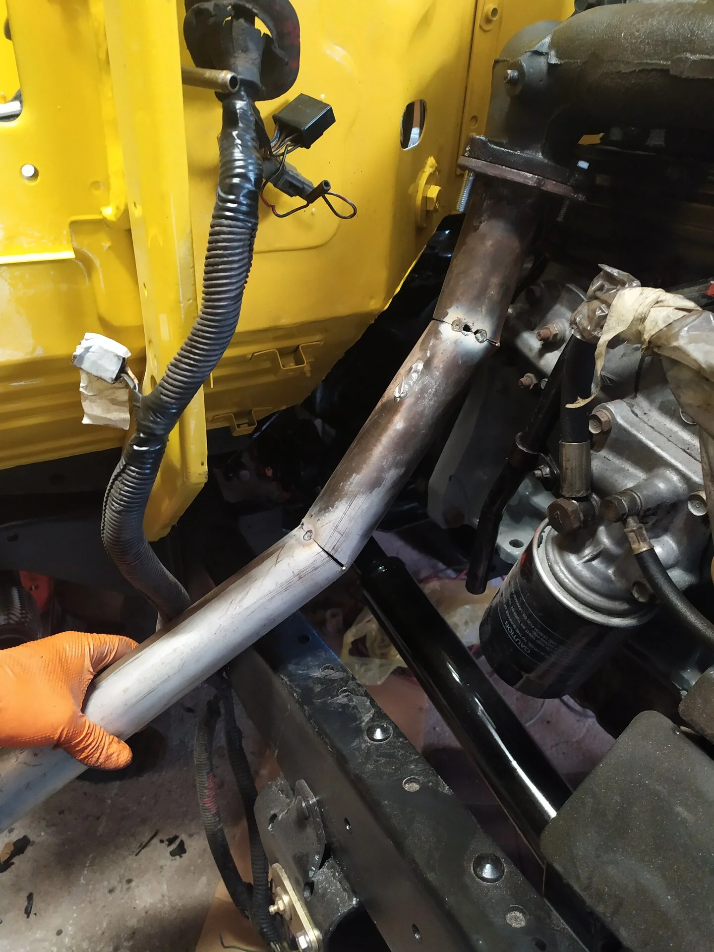

Thanks for sharing... I didn't knew that there is a bracket for this point. I might try to build one. Seems pretty logical to be there. Mine old exhaust, was exactly as i build the new one...
A flex pipe on these 3b's is essential ! For years the exhaust would crack on mine due to vibration until I welded in a flex joint. Mine is intalled just after the manifold near the firewall. great work !
Thanks mate. Maybe yours is the best way as maTTi says. I'll try to build a bracket...
