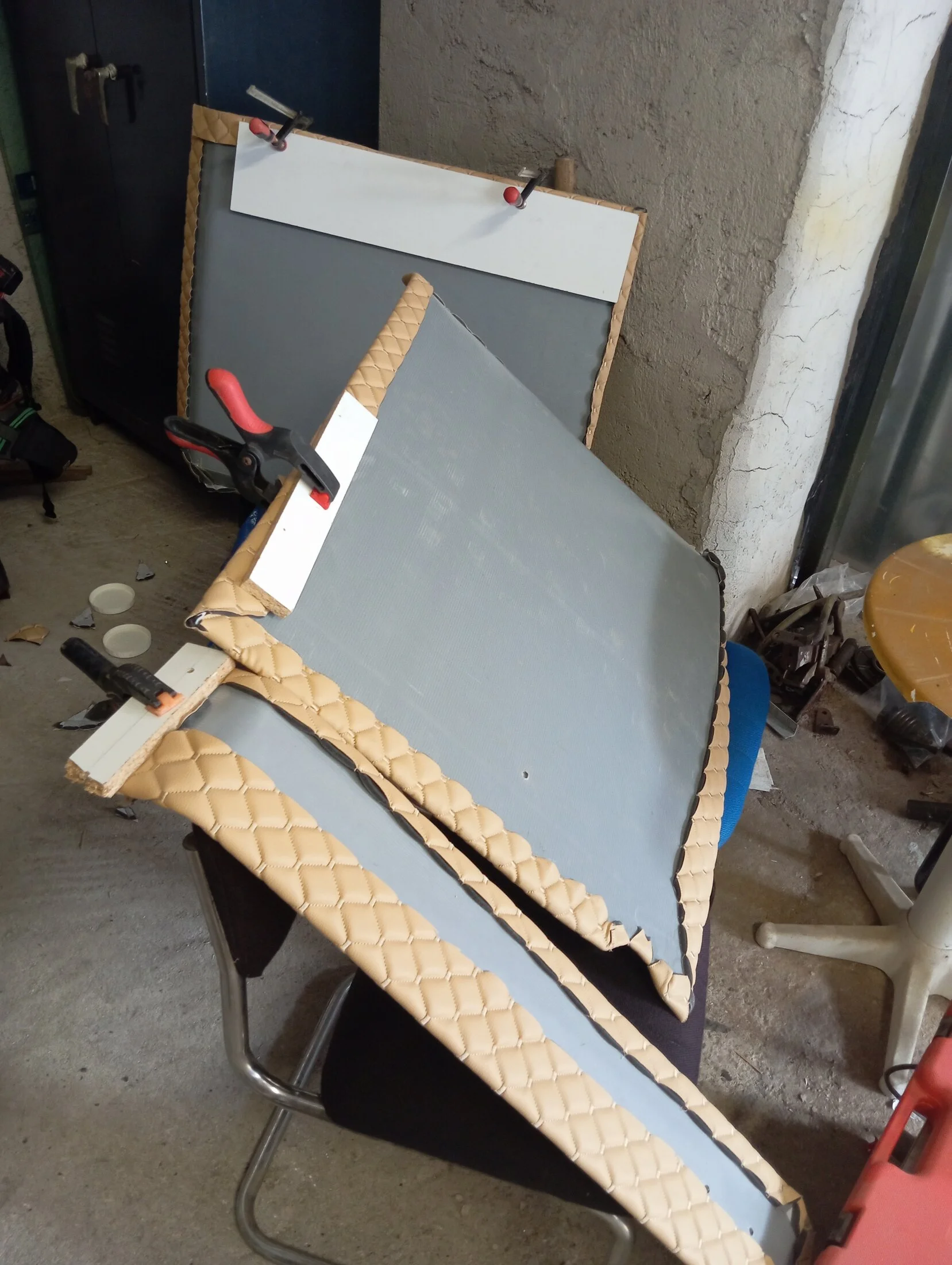

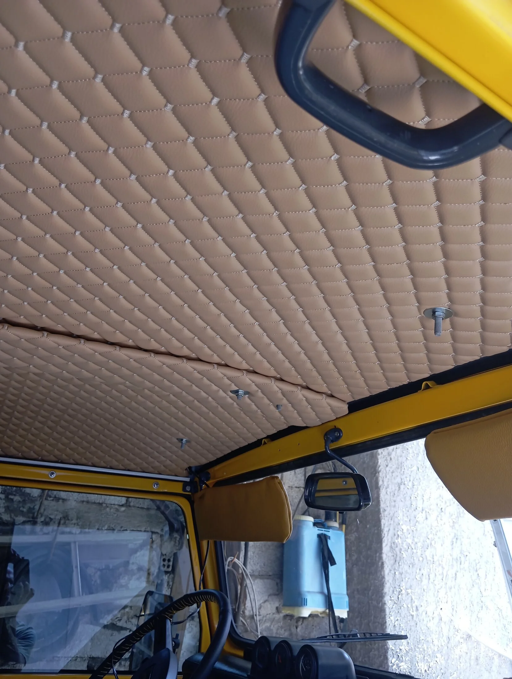

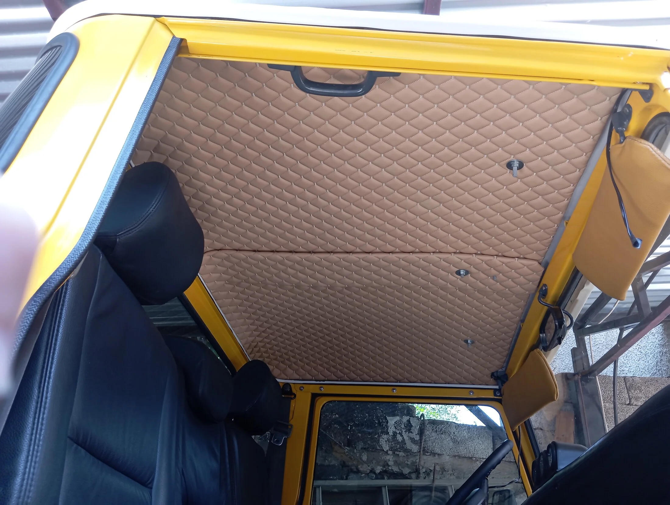

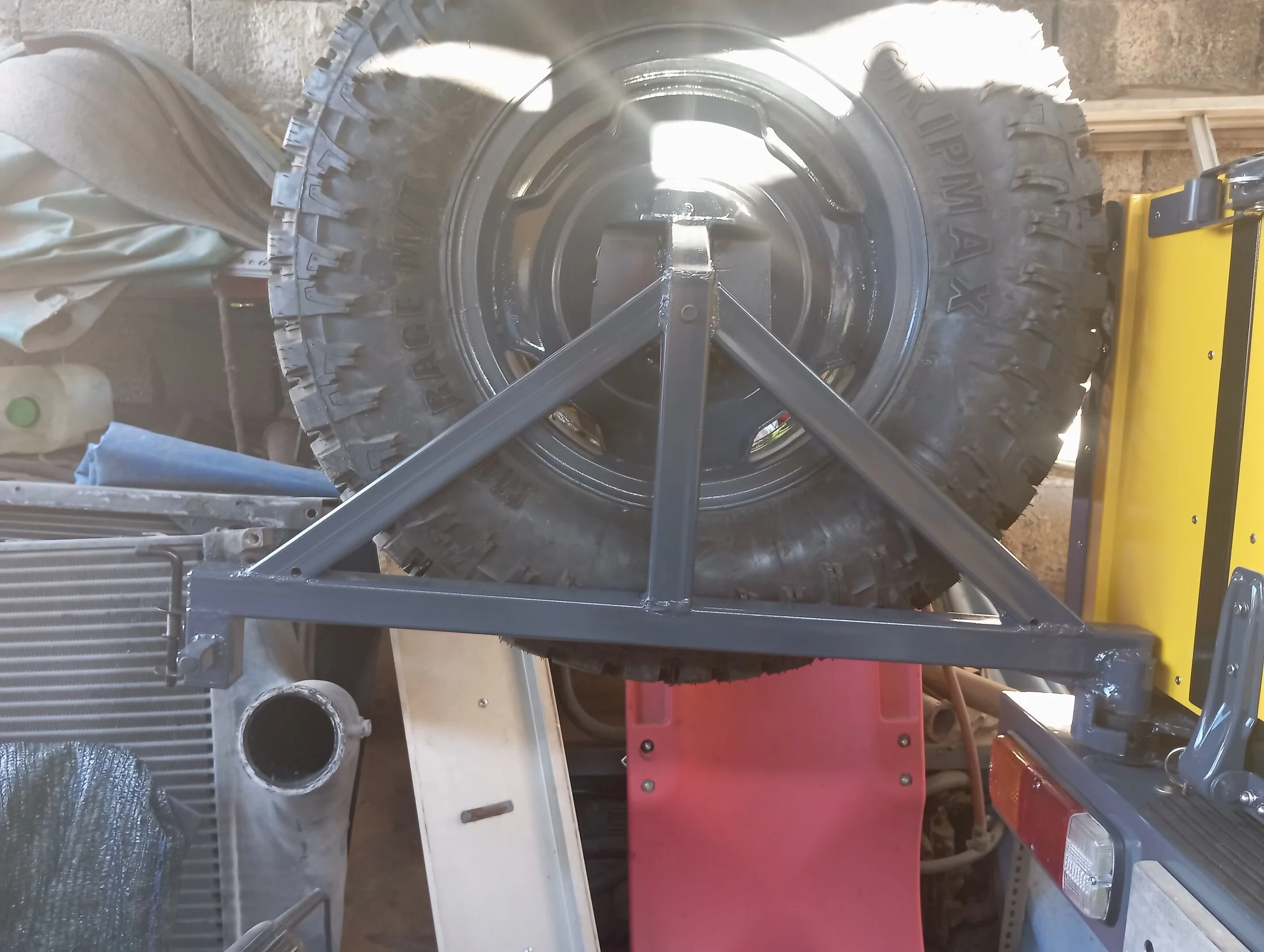

Some of my latest builds... The roof panels... Made from plastic that is used as a separator in cargo pallets. I first cut them and made the curves by heating them. After that i glued this leatherette fabric and attached it to the bolts i had install during the roof restoration..
