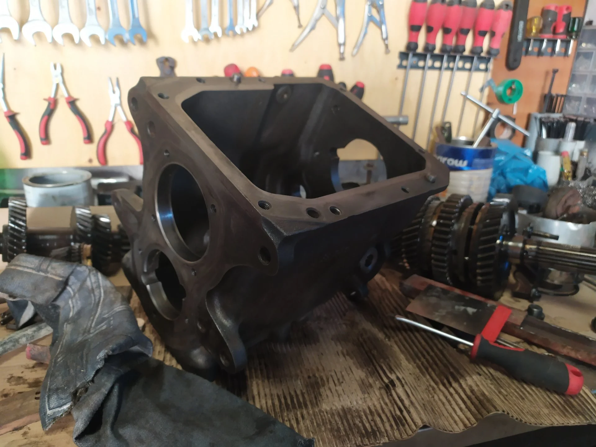

As i am waiting the paint to completely get dry (7 days says the manufacturer ⏳😮) i stated to disassemble the gearbox and the transfer..
But sadly at this point i realized that the manual i have in my hands, is referring to older models (pre 1980 i think). So i started to wonder, where are the bolts the manual showed to me. Luckily, i found some information about the disassembly at a video on YouTube (dusty ep15) that has my version of transfer. In mud i couldn't find any information about my transfer. Maybe i haven't search correctly, so if anyone has a link in mud for lately transfer models i would appreciate it if you could help me...
Your truck is, as mine, a late model (1983) and the 1980 manual does not cover it.... :(
We have to source the right TOYOTA supplement (if there is any).

The last two days were very busy... First thing I wanted to do, was to remove the bearings from the gearbox. It's almost impossible if you don't have the special tool (or something similar). I wouldn't like to hit it, so i decided to build something...
