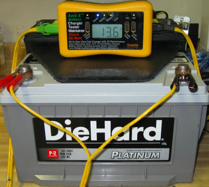

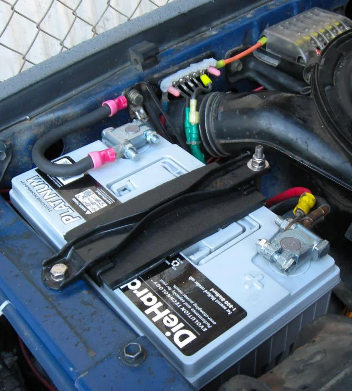

I'm running the P2. At the time I bought it, to go larger, I would have had to get the deep cycle. The Deep cycle cost more and only has a 3 year warranty.
So that P2 fits in the stock battery tray correct?
TK
Length and width are fine, but spacer is needed because it is about 1" shorter than oem. I put a couple pieces of wood 2X4 under mine.
