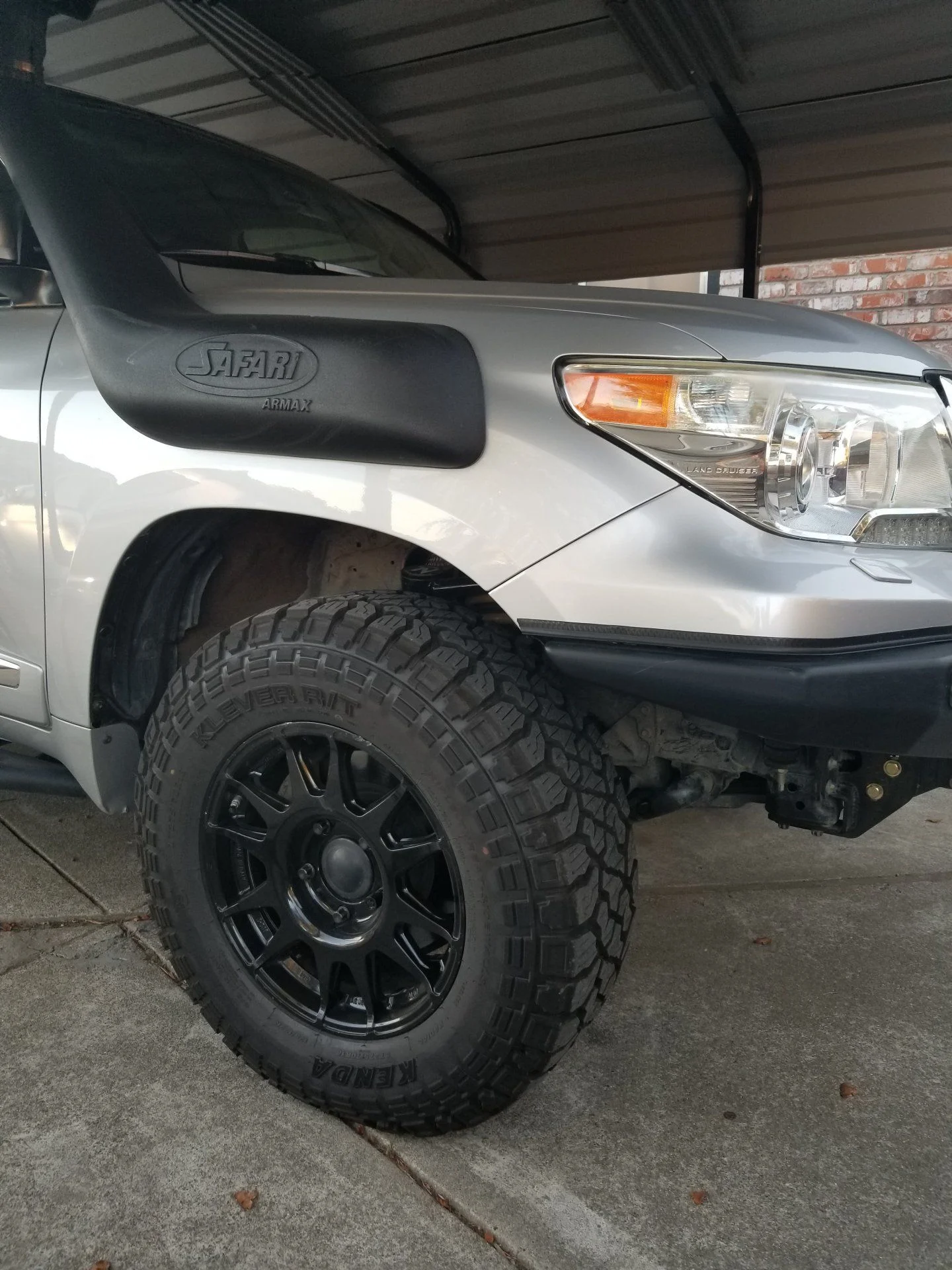

Couldn't agree more LT285/65r18 are way over priced. I switched from the general grabber atx in 285s to the kenda klever rt in lt275/70r18 and saved over $100 a tire. I like that the kendas run wide for a 275 tire. Doesnt look noticeably narrower then the old 285s. Juries still out on the kendas but So far so good on road with slightly more road noise then the atxs. Ride actually feels a little softer with the kendas. Off road should do better then the atxs, digging the tread pattern and sidewall. Have a trip planned in a couple weeks to get them aired down and dirty.

I see Evo Corse wheels! 👍👍 I like look of those tires and that size. I’m thinking about getting something in a 275/70-18.
