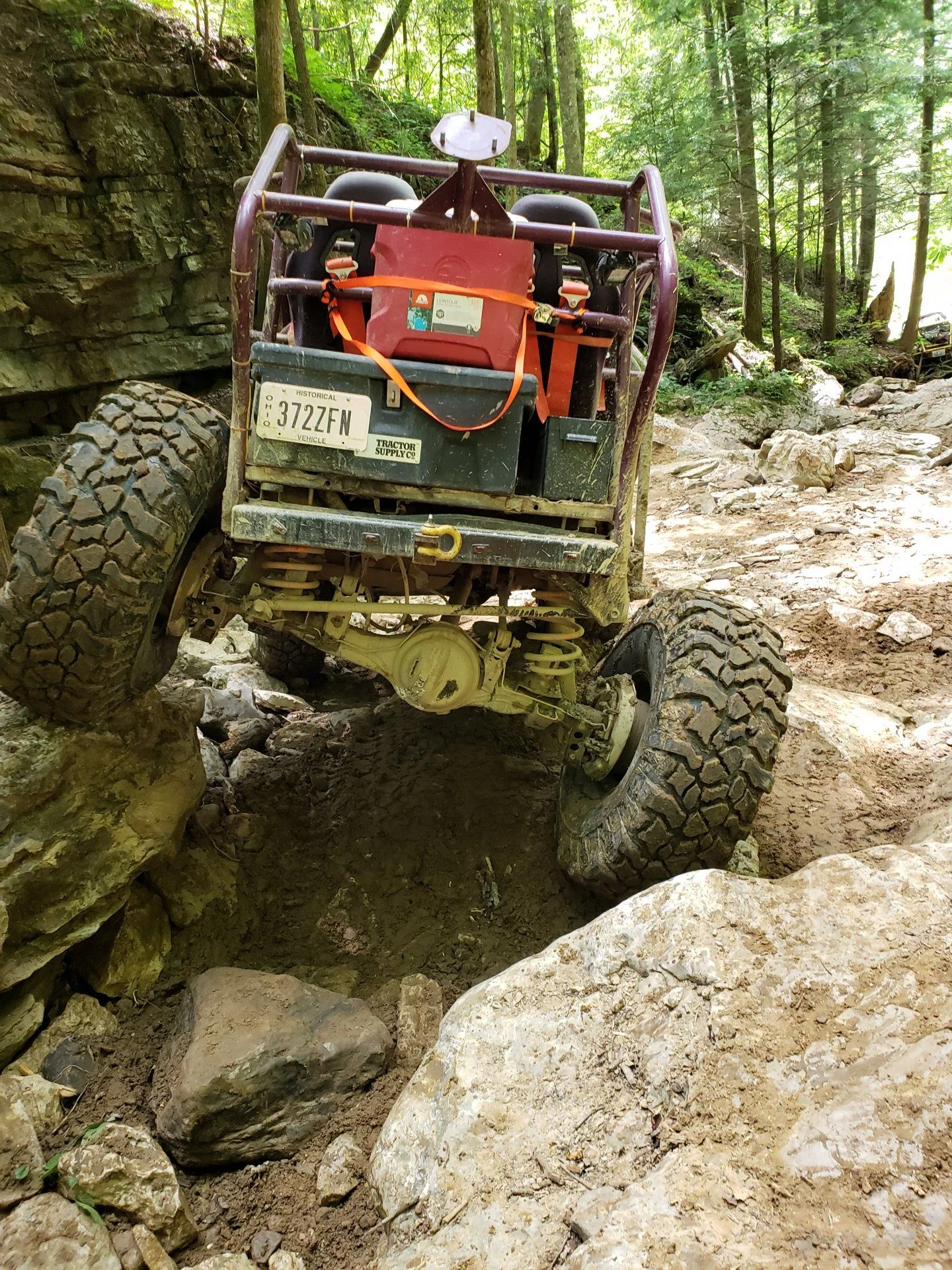

I put hydroboost on my 40 that has 80 series axles under it and 37 HMMWV tires. I can lock up the tires now but it is probably going to wear brakes faster.
Compare that to my daily driver 80 with 285/75R16 which I can't lock up unless on ice...
Did you go with the busted knuckle kit?
I found their webpage. I used hydroboost out of an older Chevy Astro Van coupled to a stock 80 series master. I had to make an adapter and bits so it was a fair amount of work.
