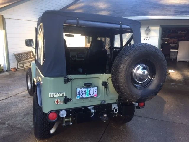

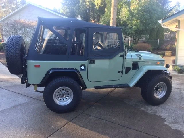

No complaints on mine, minor leaking at doors . Installed snaps to hold back flap down
1902983
1902984
