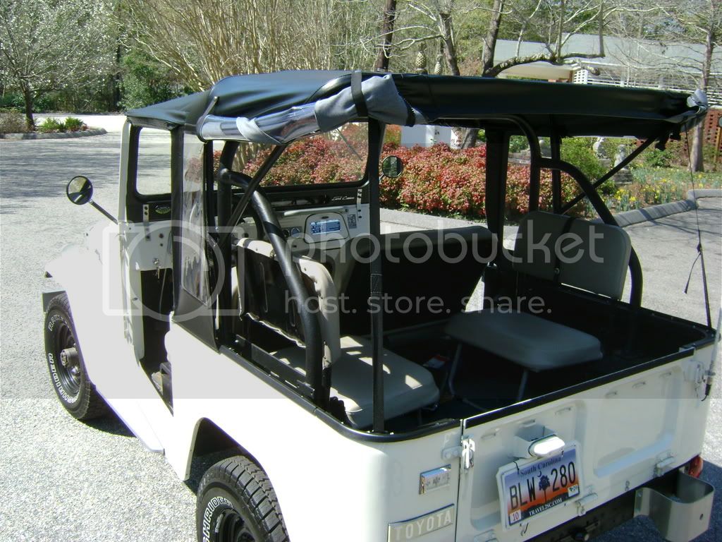

I was running in to that too....Its warm here for a few more days so I'll probably roll them up again and I'll take some pics....

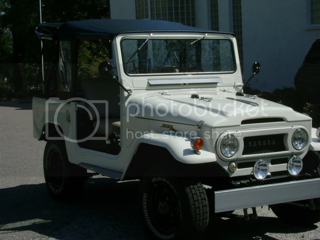

Great pics and really nice looking truck!

Actually I never got to rolling them up....I'll try to do it soon despite the cool weather...I saw a picture somewhere with the supertop rolled up...I'll try to find it as well.....

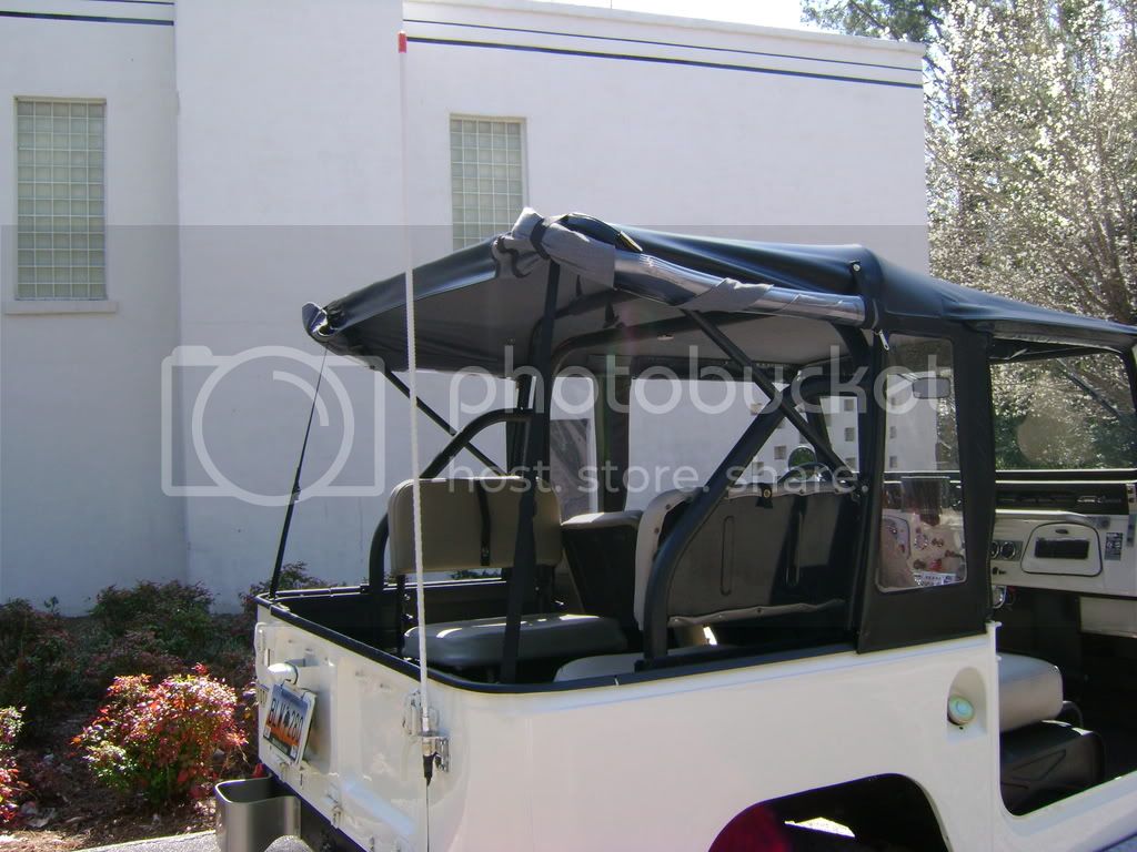

No Prob...When you put on the windshield channel you'll see it looks too long....Try to resist cutting the middle out to make it shorter...You'll end up with top that has no channel to go in....At least put it together first and see how it works...After reading the ih8mud threads and calling Bestop, they insisted it shouldnt be cut ...
The top works very nicely at speeds up to 65...havent gone faster...Looks nicer than tops I see on heeps...I like the styling and ease of fit...here are some more pics...
Mine had the same problem. I believe I cut mine in the center so it would fit and bent the edges down. I don't have any issue with it but would need to confirm that. A good rule of thumb is to put some silicone where the two pieces meet in the center. In a hard rain water will flow in this way.
great job!! looks excellent! I also have a supertop on my '73. I notice you have the same open area where the back of the door meets the uprights as I do on mine. The only bummer I have with that is the wife lets me know that the wind on the back of her arm is cold..... I mentioned that she should wear sleeves or a coat..... :)
Yeah....thats a bummer....I wonder if soft doors from Bestop would fit nicely without gaps?
They do fit better but are not perfect. Best part is the soft door make it a snap to take the doors on and off and if you buy the 2 piece they can be easily stored in the back or converted to half doors.

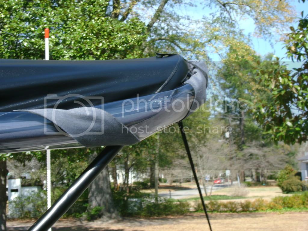

Can you tell me what that strap is for? The one that is halfway down the diagonal cross member.
As stated they are for holding the sides down when folded. I onther other hand use small bungie cords for this as they hold it tighter. I like wrapping them around the roll bar. On a tight trail they can get hung on things if not strapped tightly. I use the straps hold up the back window when I roll it up. I hate unzipping and taking the back window out. More chance for it to fly out down the road. I wish they would have put a couple straps with buttons in the back for this. But those straps with the plastic things work just fine.
On mine the sides rolled up with an odd dog leg at the back and the snaps to secure the sides to the top seemed to be placed too far forward. They barely held the sides up.
Have the same problem. Nothing like going down the highway and having one come undone. I've found if I telescope the roll forward it won't come out. Had they moved the strap back 6 inches we wouldn't have this problem.

Only pics I can find.
Probably one of the coolest features of having the top is being able to roll almost all of it up.
