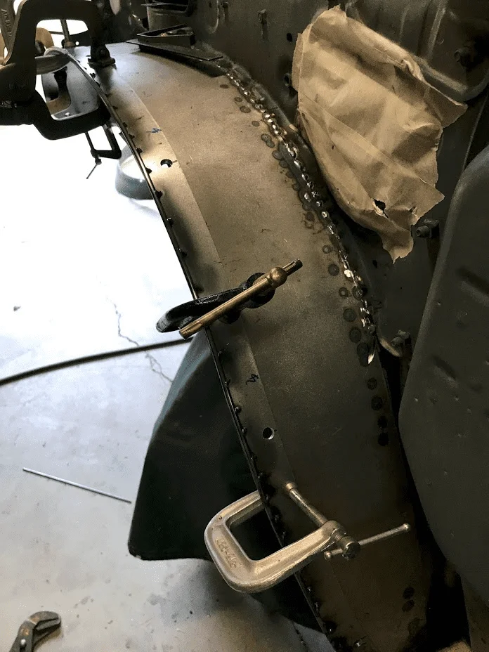

.023 wire and a used fender or land cruiser sheet metal of some sort so the thickness is the same. You won’t need to be a master fabricator, but will be a master tack welder by the time you’re done. Small tacks to not heat up the area and blow through until all of the gaps are filled. 90 degree die grinder with various grits to smooth it and prime paint to your taste. I did a road race car i built in high school with this method and 15 years later it’s still holding up.
Welding is by far the strongest, But unless you can get to the back of every weld the you have to worry about a rust spot where the paint got burned off. I have been doing a lot of welding on my reg, But I filled those holes with fiberglass impregnated Bondo. First I sanded the area then I used a metal chisel to create a small dimple down, I did this going almost side ways the chisel making little nicks in the hole in 3 or 4 places for the Bondo to bite onto. I did most of the holes two and a half years ago and not one has come out, Even with hard wheelin & banging it into rocks
You can get to the backsides of all the holes. Just have to remove door panels and rear panels. No need to insert from outside. For front fenders you can reach all the holes from under hood, door jams and underneath. I welded up all the holes on mine and my brothers. It's a lot of work! I figured we could avoid body filler but man is that paint, primer and zinc coating thick after grinding down all the spots.

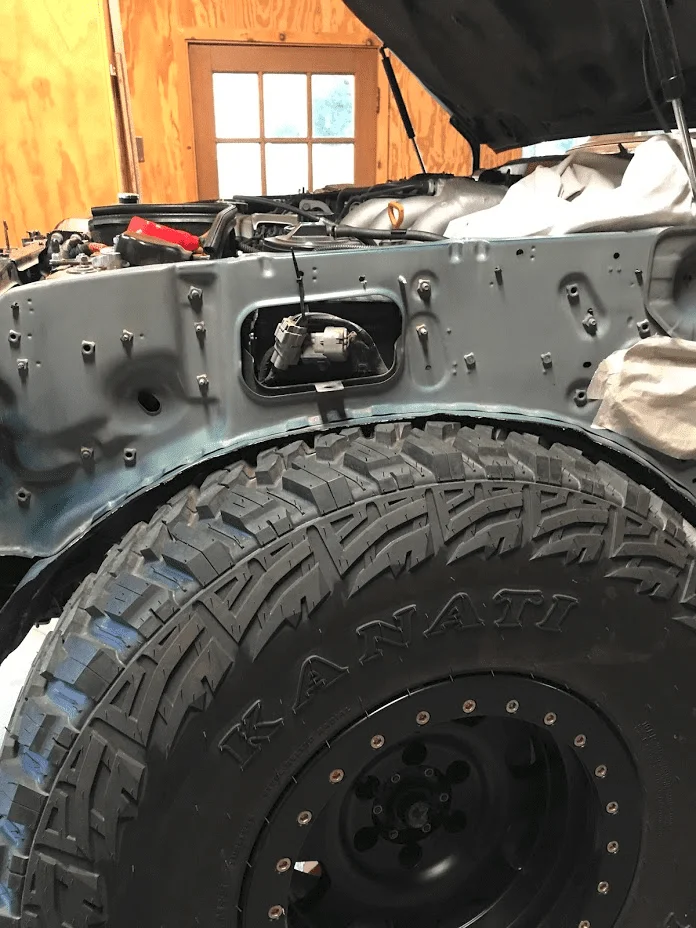

This is the what I'm working on now Fitting 39s on a 80 with a low lift. I can say with certainty that theirs no way to get to the back sides of the holes to sand prime and paint to stop Rust after welding on the front fenders with out taking them off.
As you can see theirs only 2 small hole to get to the inside of the finder and at that you would have to remove the ABS module, charcoal canister, Fuse Pane and tons of wiring. Theirs just no efficient way to rust proof after welding besides of coarse removing the finder.
