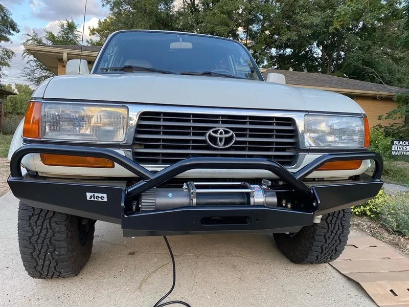

i'm looking online at used winches and wondering if anyone knows if there are good older models to look for. i've got a slee front bumper that insurance paid for. i'm planning to only pick up something that is really reliable and would be worth spending the time refurbing so wondering if there are specific makes or models i should look for.

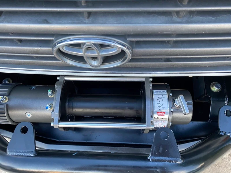

I have a shortbus with a Warn 9.5 XP. I strongly suspect that the shortbus was designed around the Warn 9.5 XP because it was the fastest and most powerful mid-frame winch at the time the bumper was designed. I don't think any large-frame winches will fit and I know for sure an upright winch like an 8274 will not fit.

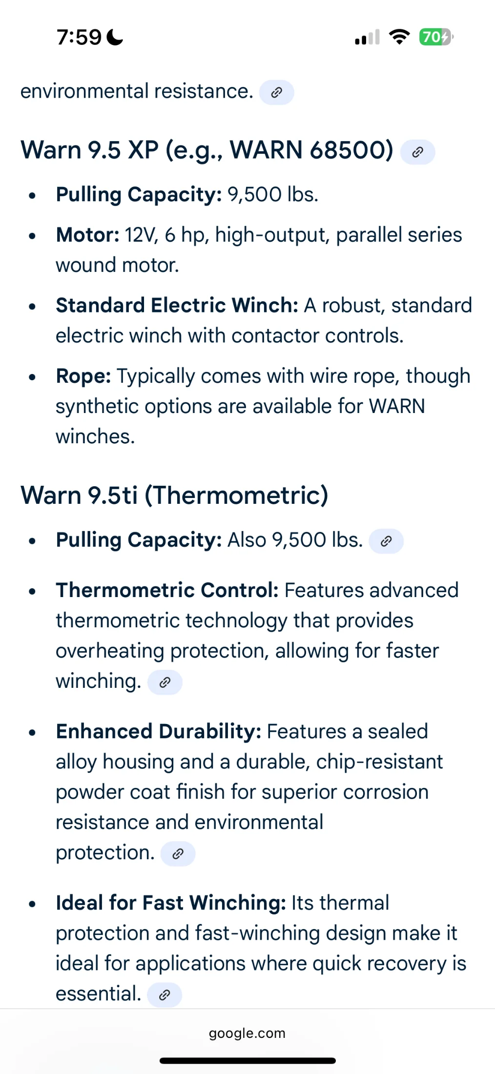

also googling here. can i do the 9.5 TI in addition to the XP?

No, the 9.5ti had an integrated solenoid and likely won’t fit.

I mounted my shortbus before mounting my 9.5XP but then the winch wouldn't drop into place past the grill, I opted for disassembling the winch slightly and carefully fishing the parts into place and then reassembling, but in hindsight I would recommend installing the winch in the bumper and then installing the bumper on the truck.

I cannot say for sure but I would NOT suggest to try to put a winch with an integrated solenoid housing on a Shortbus. Its likely not going to fit without modification to grill area. You need to use something with an external control pack.

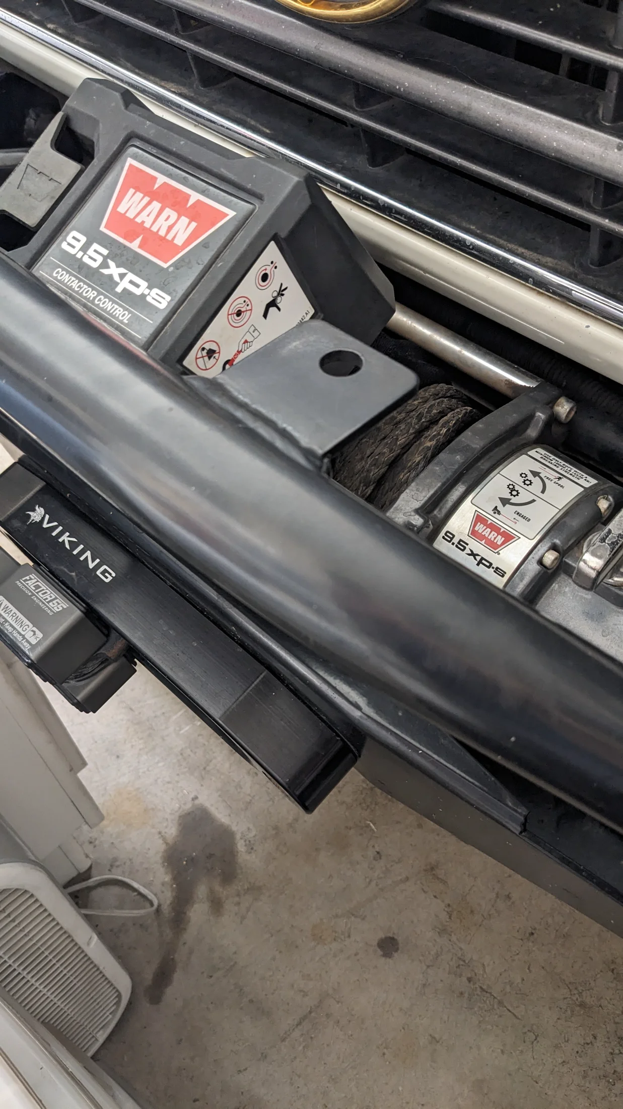

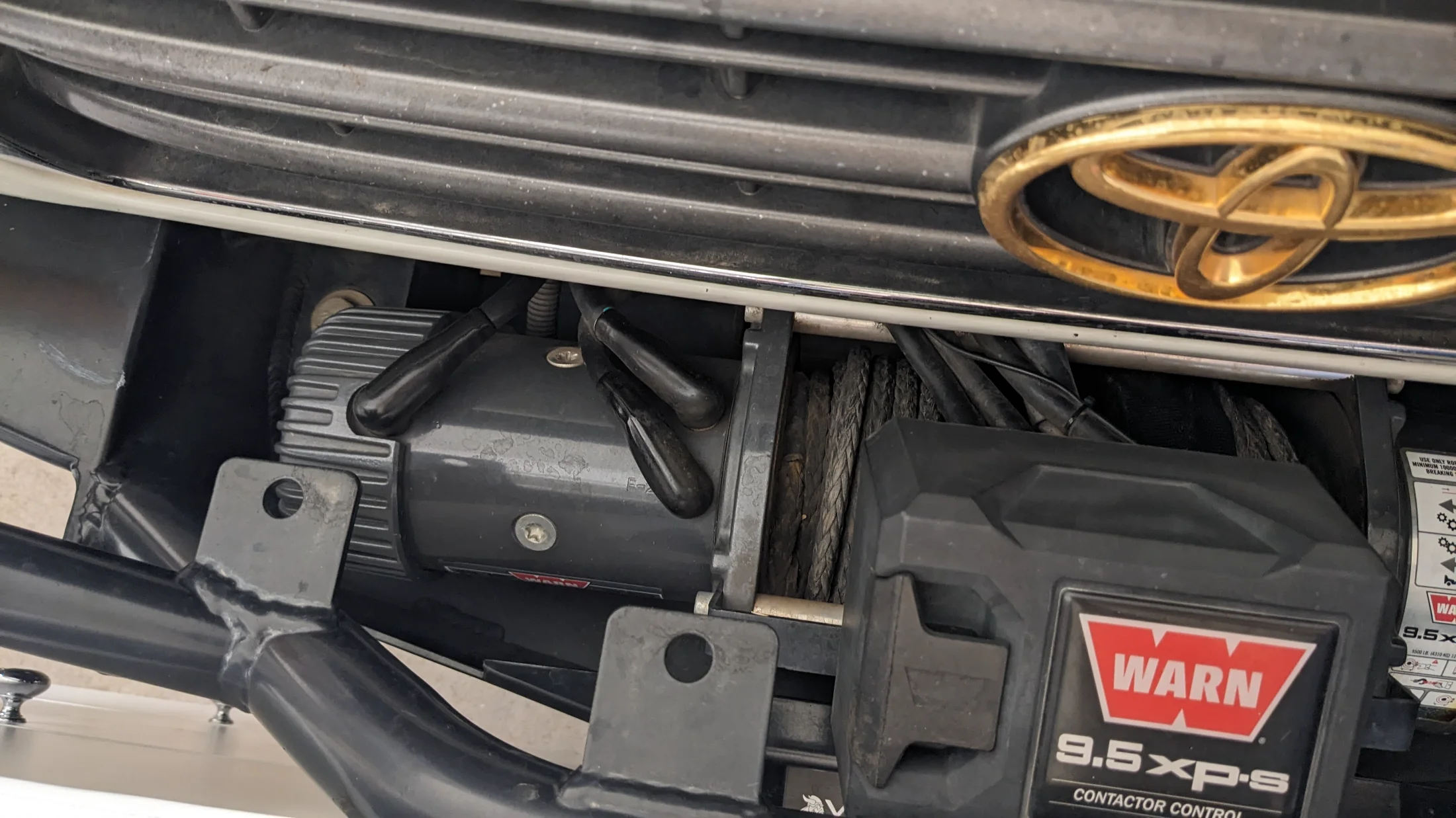

Newer warn winches come with Albright style solid state contactors which are an improvement in reliability and performance over the old style solenoids. If you find one of the above that comes with the new style contactor pack choose that over the old style solenoids. You can tell the difference by the black box and by the winch controller and plug. It's also possible to upgrade the control box on an old winch to the new style contactor pack. A custom upgraded control box might be harder to spot depending on whether the person kept the old control box and remote and just swapped internals or bought a whole new box and remote.
New Style Contactors:
Recessed plug with rubber cap on left side of control box, control box has some complex molded in shape. Remote has a D-Profile for the plug/connector.
Old Style Solenoids:
Control box is a pretty simple box shape and remote has a round profile plug/connector.
