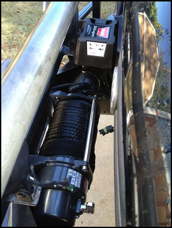

Well after 4-5 years since I ruined my last 9.5XP, I just got a new one for Christmas. The first thing I did was take the motor off to address the drain issue. there was no silicone in either drain hole but it does have a paper gasket all the way around. When I pulled the motor off, the paper gasket was loose around the top but on the bottom it appears that is the only place some type of sealant or adhesive was used at the factory. I went ahead and turned the drum feet forward and siliconed the upper hole or slot, put a little on the gasket in the same place and bolted the motor back on. I checked while tightening that I had some sealant squeeze out from that upper slot, then smoothed it out with my finger. It looks good but I was wondering if I should apply a thin coat all the way around the motor/drum contact area except for the bottom drain. The sealant goes on white but cures clear so it would still look clean but sure no water, at least from rain and washing, would be able to get inside. I read some posts where someone sealed both slots with sealant but he knew he was going to be taking on high water crossings where the wince might be submerged. I don't think I will have my winch submerged so that shouldn't be an issue. I think that the bottom should be open to help drain any condensation that may develop inside. It might also be a good idea after using winch in very wet conditions, to perhaps spray some WD-40 with the red tube up into the bottom drain.
Also I was wondering about the cap end on the motor. I didn't remove it but of course it was loose. Should any sealant be applied around that cap where the open end and motor housing come together? Since that is not a tight fit and there is a small gap. it seems that water could enter there as well. That seems like it would have been a good idea for Warn to made an internal groove and an O-ring…….. Or did they since I didn't remove the cap all the way? I want to do everything I can to keep this winch in working order for many years and not have water and corrosion be an issue.

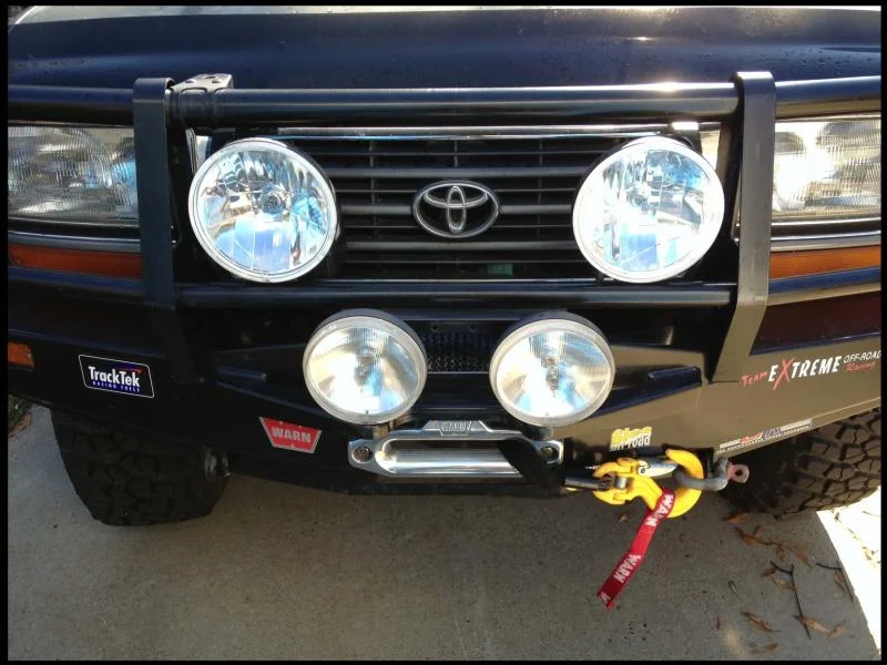

Well I see that no comments have been made so I just did what I thought was best. I ensured that the paper gaskets on both ends of the motor made good contact and seal, left the bottom, 6 o'clock drain open and the 3 0'clock hole sealed with silicone. After I got the winch installed with feet forward, then it was not possible to use the supplied control pack mounting bracket. I thought about making one that attached to the two cross bars on the winch which were now facing to the back but that seemed like a lot of trouble. So what I did instead is used the light mounting tab and used a piece flat steel, drilled a big hole for the light to still mount and then the two small ones for the control pack. I made it long enough so I could place the pack as close to the grille without touching and still leave enough room for the light to to mount in the same location.
I spooled the rope on and attached the hardware and its all done. Here are a few pictures if the finished install.
