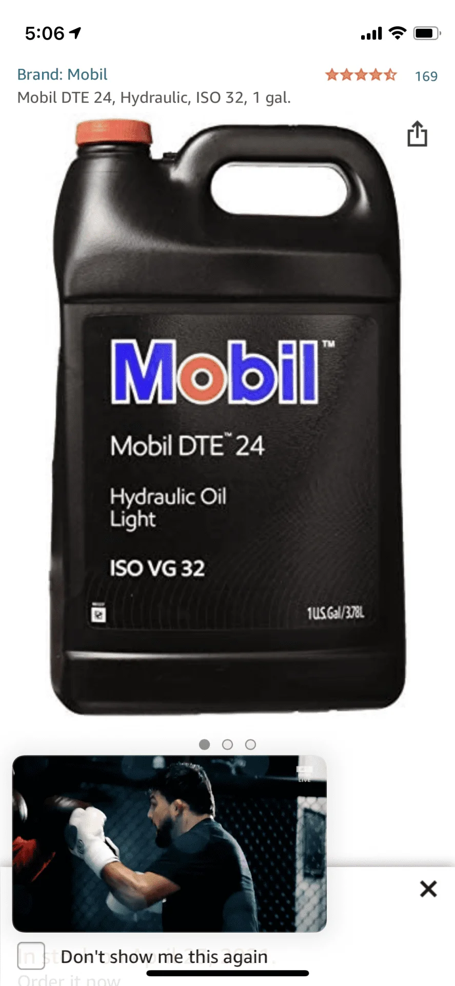

My power steering whined a bit and progressively got worse until I had a shop rebleed the system. Upon some good advice after searching and reading up a bit on this subject, I made sure to use this fluid. No issues since.
