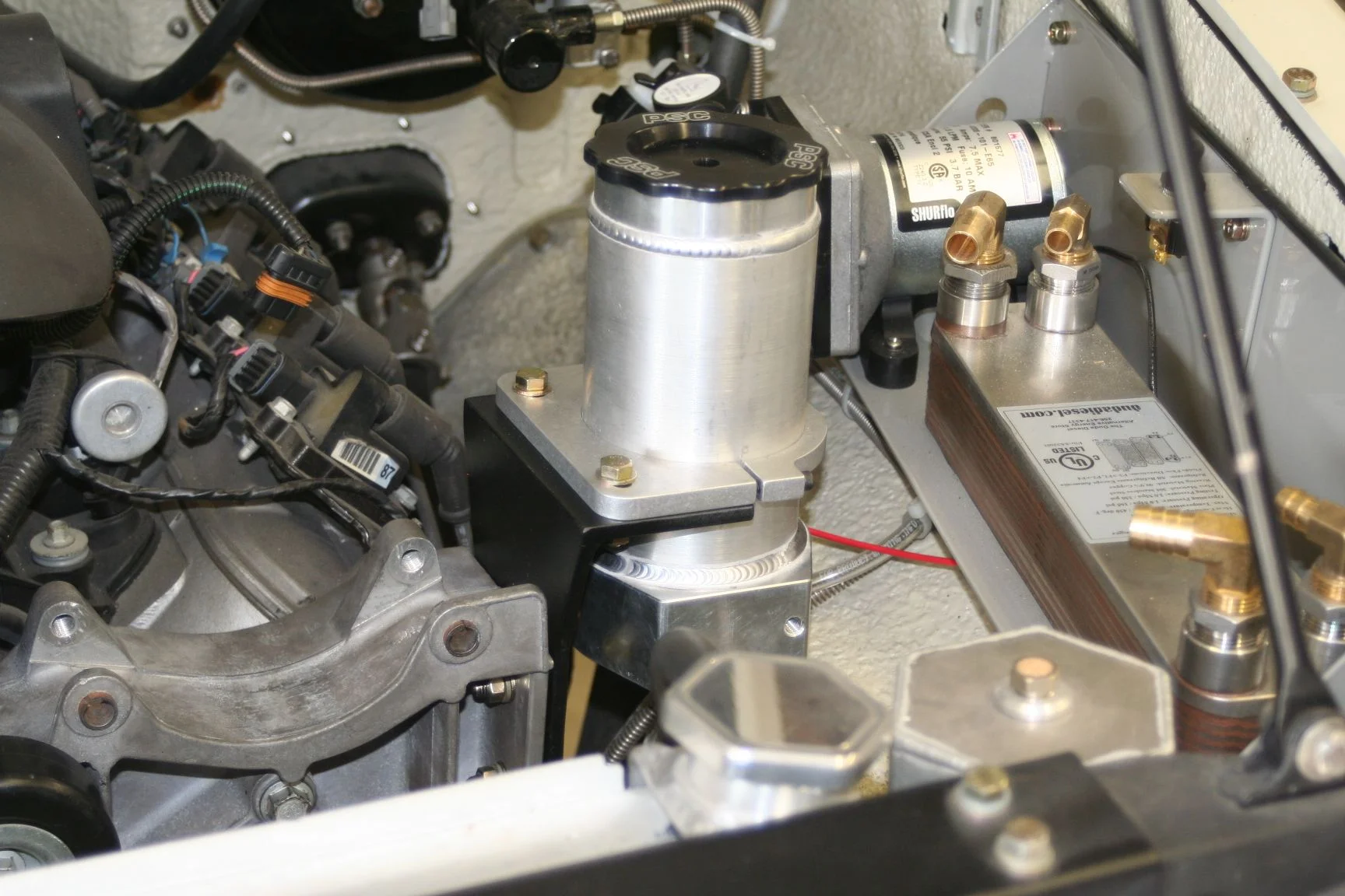

I built a hot water heat exchanger system that works off the motor's hot water. The exchanger and pump are mounted in the engine bay with hoses running down to the front bumper area. You stick the cold water hose in whatever water source you have and the hot hose has a shower head with shut off mounted to it. My Wife can go through 3 to 4 gallons real quick, so be prepared.
Here's one before it was plumbed. Exchanger and pump behind it on the right. It works very well for a group of people, keep the motor running and supply the water...

Well, I'm way past not altering what Toyota did. :) Toyota did a great job on all the different systems, but even if we change tire size we mess with what the engineers did. I felt more than confident in tapping into the coolant line and adding the heat exchanger, but everybody has their own level of comfort with their decision to alter anything.
