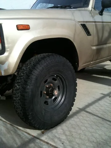

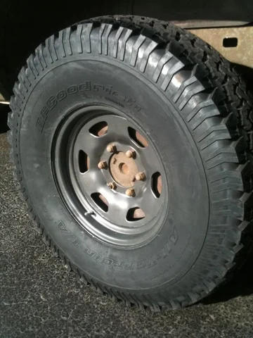

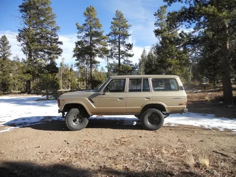

These are just cell phone pics, and hopefully I'll have better ones later today or tomorrow, but....
The new tires finally came in (and my evil overlords of bosses let me off to go get them).
BFG AT TA/KOs, 33x10.50R15 on stock 60 series wheels (painted graphite).
Not only do I think it looks a lot better with skinnier tires on it, but my goodness did it handle badly with 33x12.50s on the stock wheels. I thought I would have to replace the TREs and whatnot, but it turns out that with the new tires it handles PERFECTLY. Seriously, it drives just as straight as my '91 little truck, and maybe even a little less shimmy in the wheel.
Moral of the story? Don't have silly wide tires on skinny wheels--it drives REALLY badly.

I found that out years back with my 85pu, that fat tires on stock rims is a no no.
I'm now running 9.5 wide on 8" rims, works really well.
