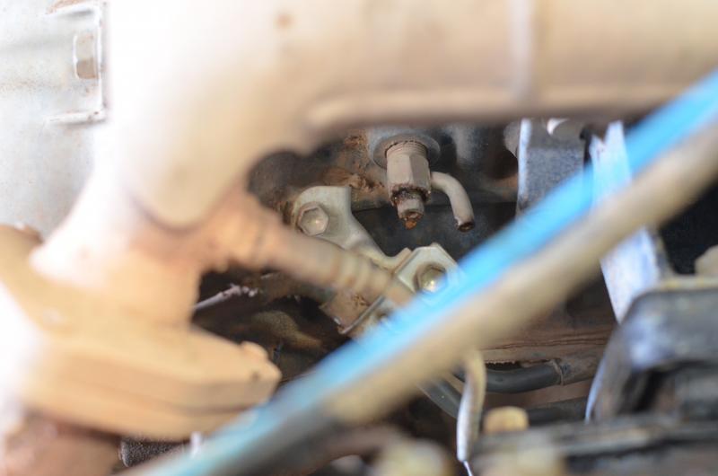

First thing found was this leaking petcock valve, leaking coolant. There are two, one on each side of the engine block? Does anyone have an Idea what it is? part number for replacement?

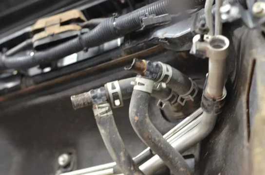

Heater T broke during removal. FWIW: 2005 model year with 120K. Always garaged. Will be replacing with the MMC SS ones.
That's the T end that always breaks first on mud.
First thing found was this leaking pet-**** valve, leaking coolant. There are two, one on each side of the engine block? Does anyone have an Idea what it is? part number for replacement? View attachment 776299
Yep, coolant drain. Left/Right. It's weird that it's leaking out the stem. And it's weird that the shop didn't drain all of the coolant before lifting the body (radiator). They work pretty well. I just slip a hose on the stub and route to a bucket. No mess.
If it's leaking then Sam/CDan should be able to get a part. If it were running, I'd just try to re-seat it, but since that's not an option you could either replace now or wait and mess with it later. They're not that hard to get to.
Speaking of coolant, would be an awesome time to replace all the minor coolant hoses.... 'while you're in there'.
Thanks for the input. I'm def replacing them while I'm in there.

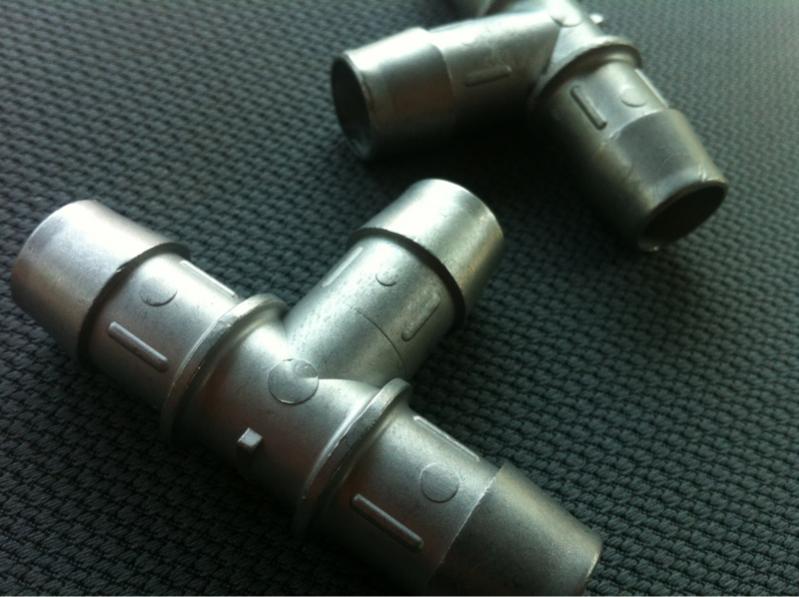

Taking the opportunity to replace the heater Ts with these beauties.
What are they made of? Are they compatible with the components in the 100's cooling system?
The cooling system consists of brass, iron, aluminum, plastic, and rubber in OEM form. The only thing I would worry about would be incompatible rubber, but if you stick to OEM hoses there's no worry. Galvanic corrosion typically occurs when there is dissimilar metal:metal connections. Phenolic unions or flange kits are used there to eliminate that risk. As long as there's rubber isolating the part there shouldn't be any worries.
Stainless Steel. MMC sells them. You can just as easily and much more cheaply use brass or the OEM plastic but I figured this was a small price to pay for a solution that will outlast the truck.

I bought the 5/8" and they are a good snug fit.

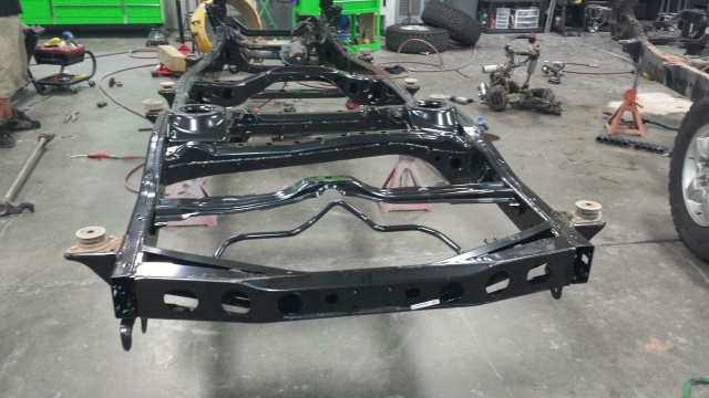

New frame in!

Out of curiosity, how many shop hours did the insurance cover for the R&R?
I'm still amazed your insurance went this route. Did the body relax all the way when taken off the bent frame? The door looks straight in the pictures.
