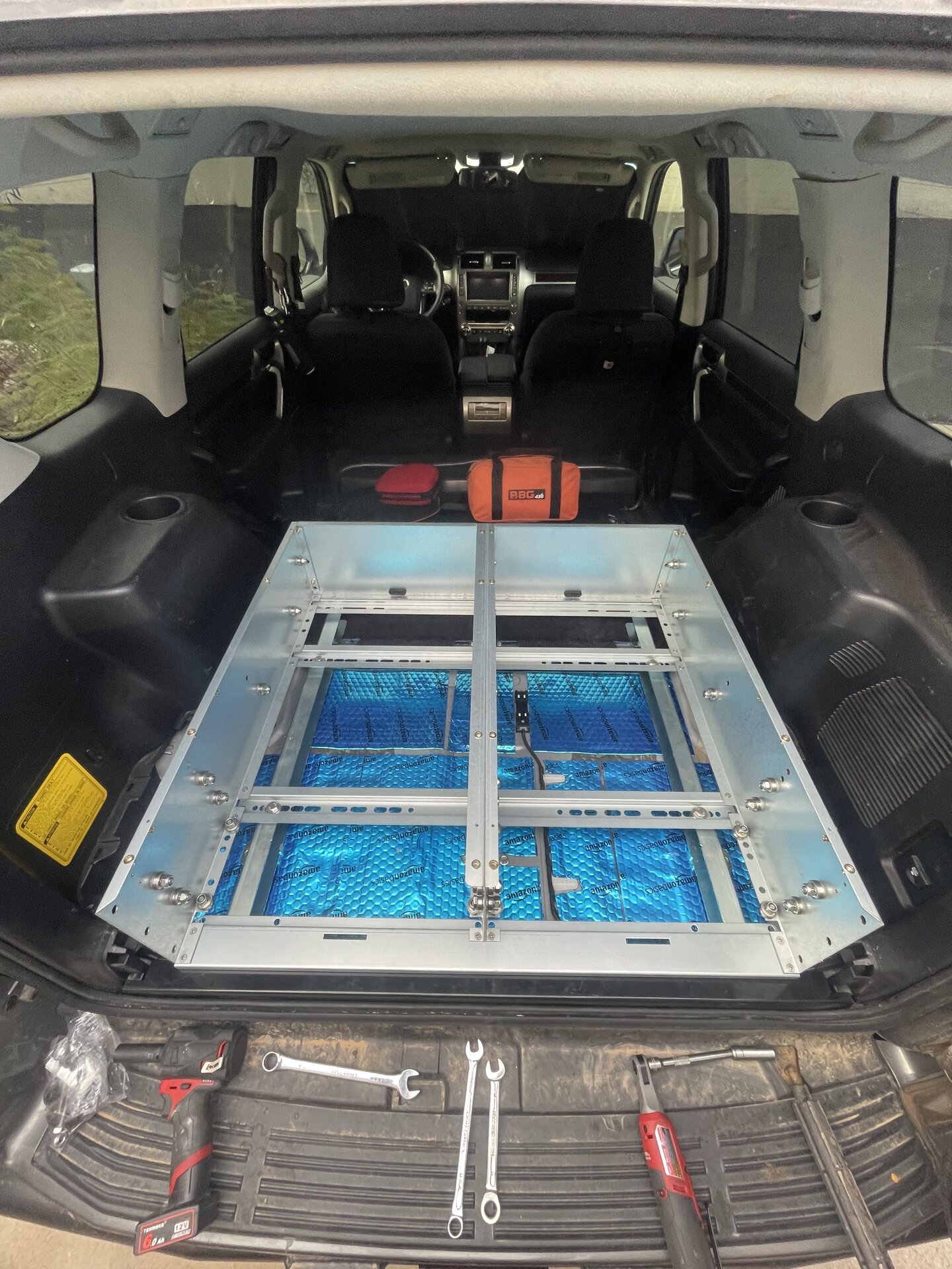

I installed some Ironman drawers and my iceco fridge w slide. Fabbed up some fold down tables for the swing gate, deleted the second row seats and fabbed up a nice cargo area in its place. Installed a remove 100ah lifepo4 with a 40 amp dc to dc charger and the Egon hub.
Added the Bison shelf and Molle panels to which I attached my hub and charger on one side. Flashlight, first aid kit and fire extinguisher on the other side.
Next up is lighting the camp area and maybe some spotties on the front end. Looking at adding some flexible solar panels to the rtt also at some point.
Oh yeah, Also added a Hayden AT cooler to hopefully avoid any other traumatic events in that area. 😏
This rig is ready to ROCK!🥳

It's great to see someone actually do a drawer system out of aluminum instead of MDF/plywood, etc.
You're rig will be so much lighter just from the drawer system!

Yep, I am pretty pleased with the drawers. Fit is perfect with the wing kit. Quality rollers and stainless hardware. Only thing I wish they had was a mechanism to keep them open when on an incline, but I can find a solution to that. Overall they are great and am currently figuring out just how to stuff them full of gear.
The tank is front runner floorboard tank, 10 gallons. I made my second row cargo area level with it. A bonus is my old rear cargo tray actually fits pretty well in the new space for when I need to haul a messy item.

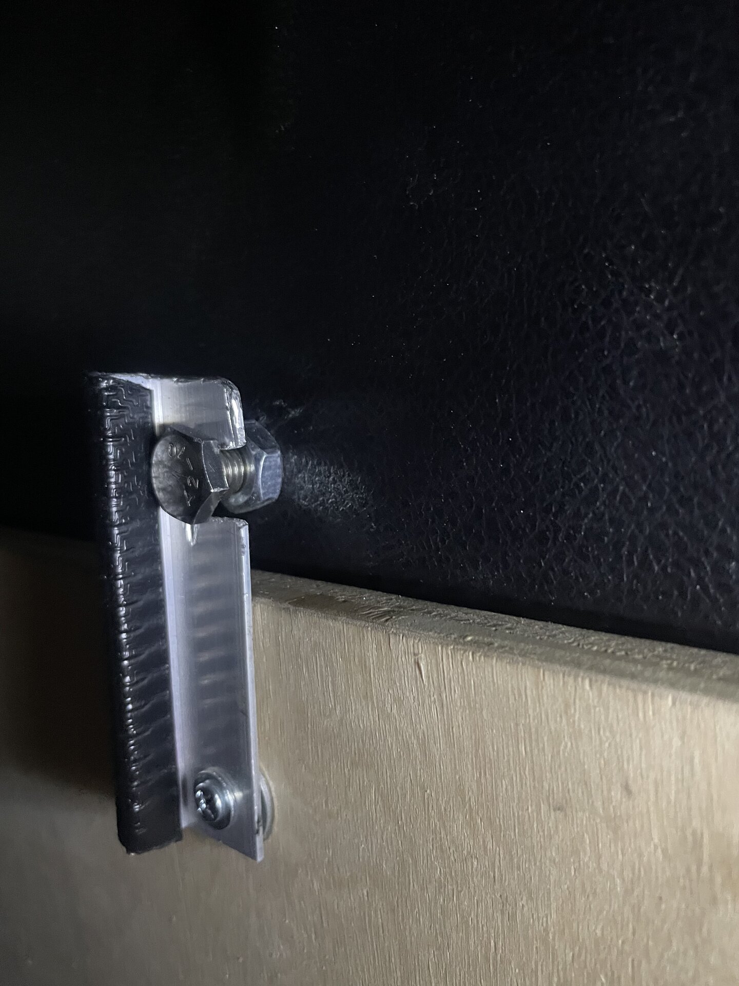

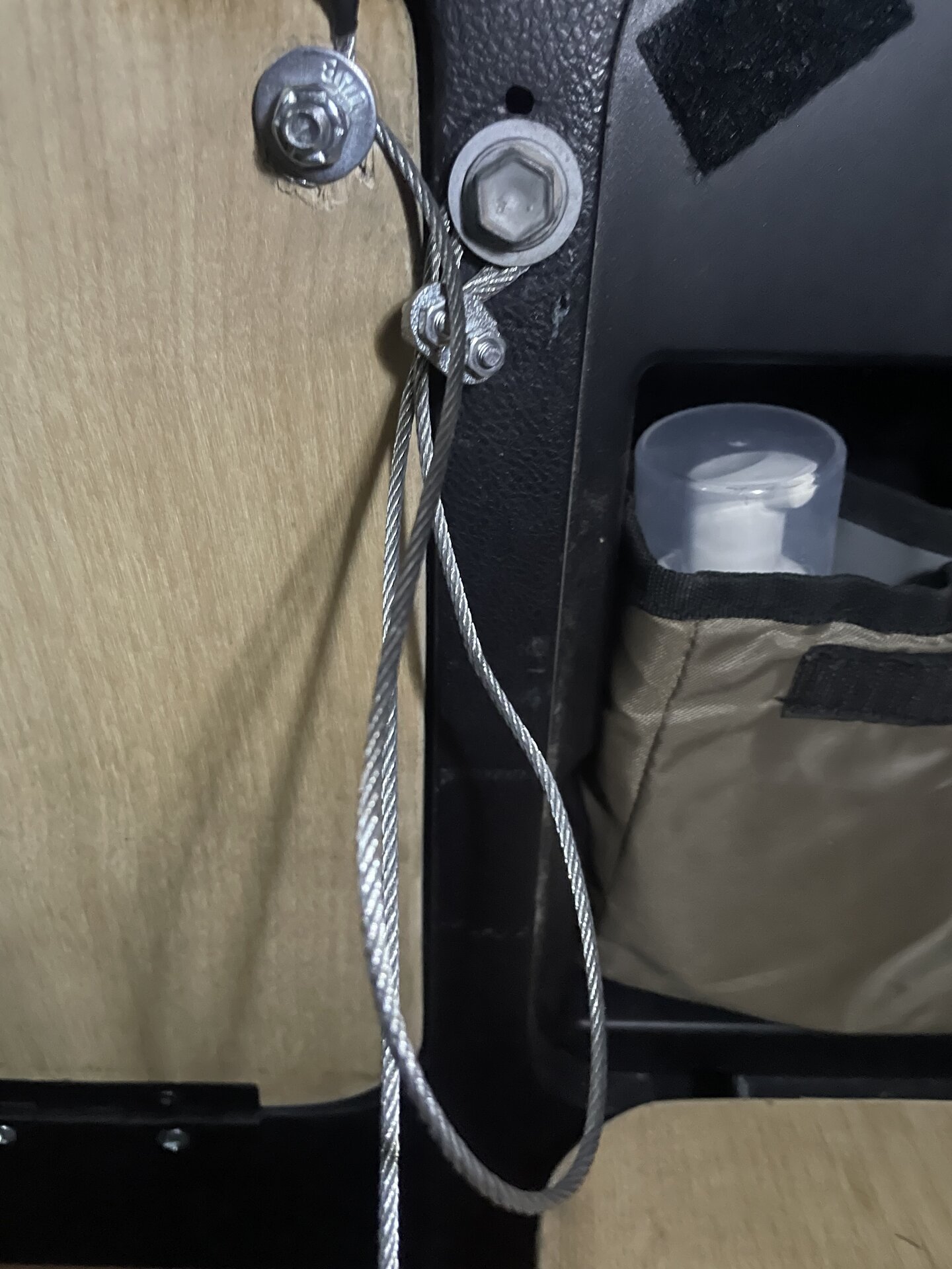

Sure, I just took off the plastic covers for the two pockets in the swing gate and used those for templates. Plywood, piano hinges, some cable I had laying around from putting up some sail shades on my patio, and some random nuts and bolts from my giant box of bolts that have come off the rig. I think the only thing I actually purchased specifically for the project was the piano hinges.
The cable attaches to bolts that are backed by some very large diameter washers so not to pull through.
The latch is super simple. Just some aluminum angle, cut a notch out to slide over a bolt
I am still looking for the right material to surface it with. Thinking some kind of plastic. Gonna put some leftover black carpeting from my second row cargo area project on the bottom side.
