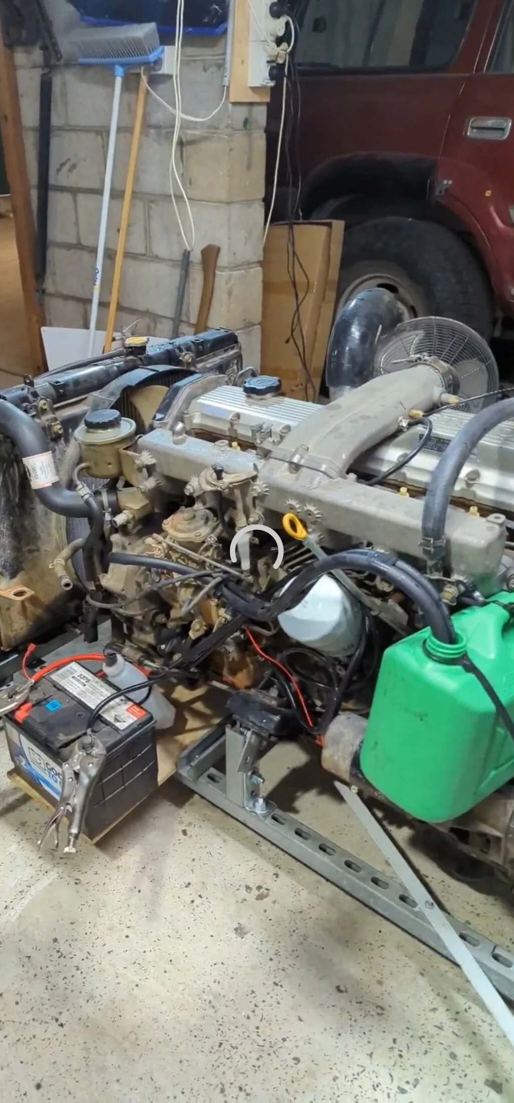

Not a great pic, it's a screenshot grabbed from video.
I used unistrut for this one. Bolted together a basic frame, added casters.
Used a strut under each engine mount, and a bracket off the bellhousing.
This one, i wanted to be able to start it and run it up to temperature as it was in storage for a long chunk of time, so i set up the radiator for it too
Beauty of a diesel, it only needed 3 wires to start and run
