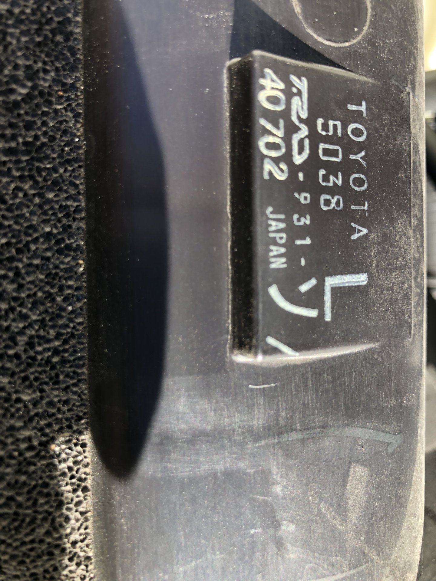

Hi All!
Just wondering if you thought this was the first little part of the fatal crack in my radiator. I've been keeping an eye on it, but today I thought I saw a new little crack on the right side of the logo. It's really small if it's there at all. The car is a 2016 LC with about 95k miles, for reference. If it is on its way out, is there anything I need to specify to my mechanic about the upgraded radiator, or will they already know to replace it with the most recent version?
Thanks,
Jack
Yes that’s the crack alright. I have a 2013 with 64k same issue. I’ll attach a pic of mine for reference. Have an apt with Toyota for radiator replacement, quoted $1000. Yay!
Bummer. Indie shop is quoting $1245 for replacement. I guess I'll tell them to go ahead and order the part. Thanks for the help.

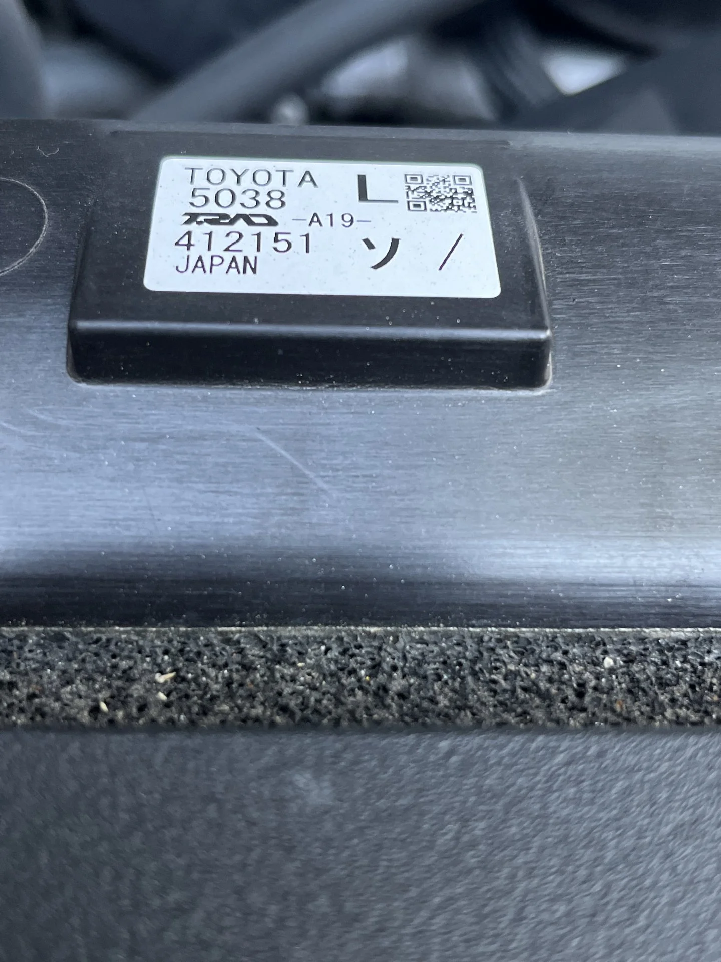

I'll mention the o-ring. Is there a way of telling the new radiators from the old ones? I mentioned to the service rep at the dealership and he wasn't sure. Or is it safe to assume that if it hasn't been sitting on the shelf for years then it's an update one?
Check the big PSA radiator thread for photos.. it is a very long thread but you can check the first few and last few pages for the relevant images. The new design has the raised flat area protruding less with more rounded edges, but it is a subtle difference.
Any Genuine Toyota radiator in the current parts system should be the new design. It was released in late 2018.
I’d avoid aftermarket. You’ll find rumors online that companies like Koyo make the radiator for toyota, that is not true. Toyota has a subcontractor type company called TRad that makes them.
