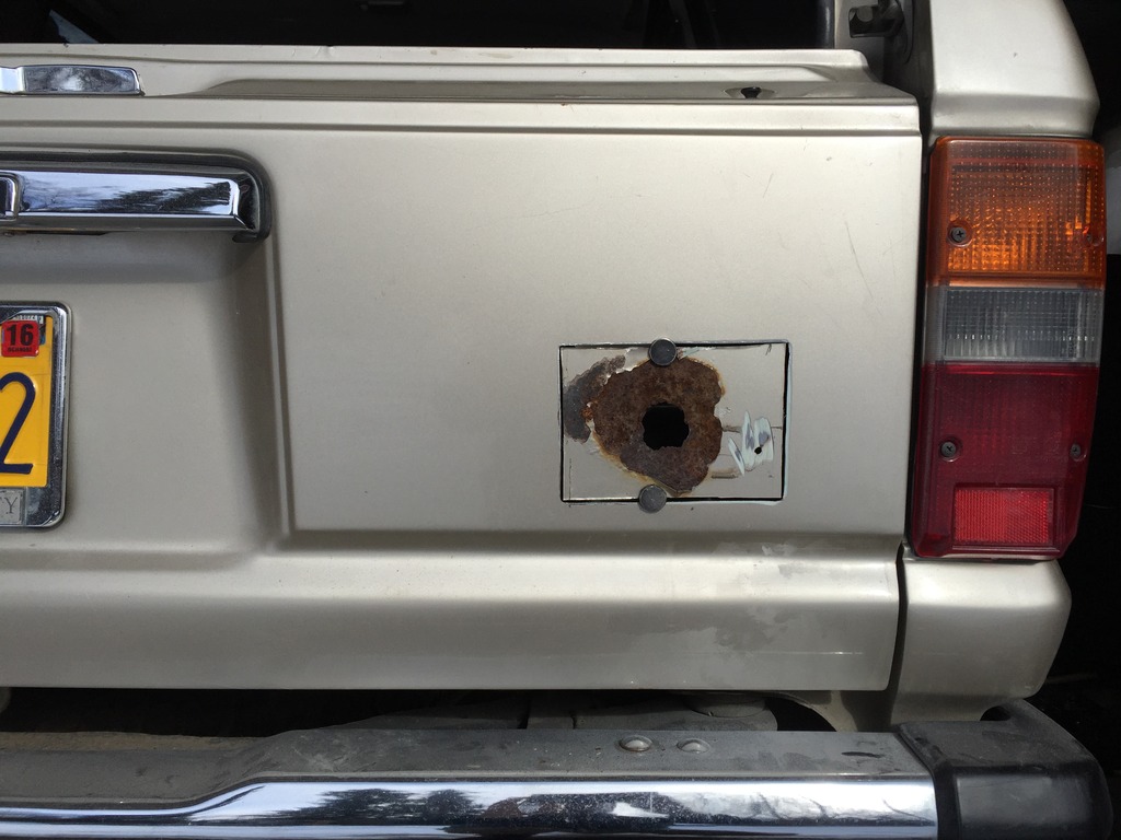

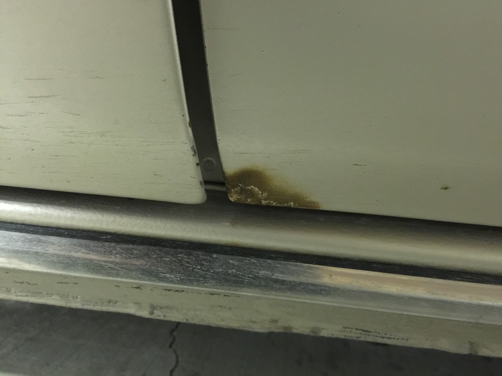

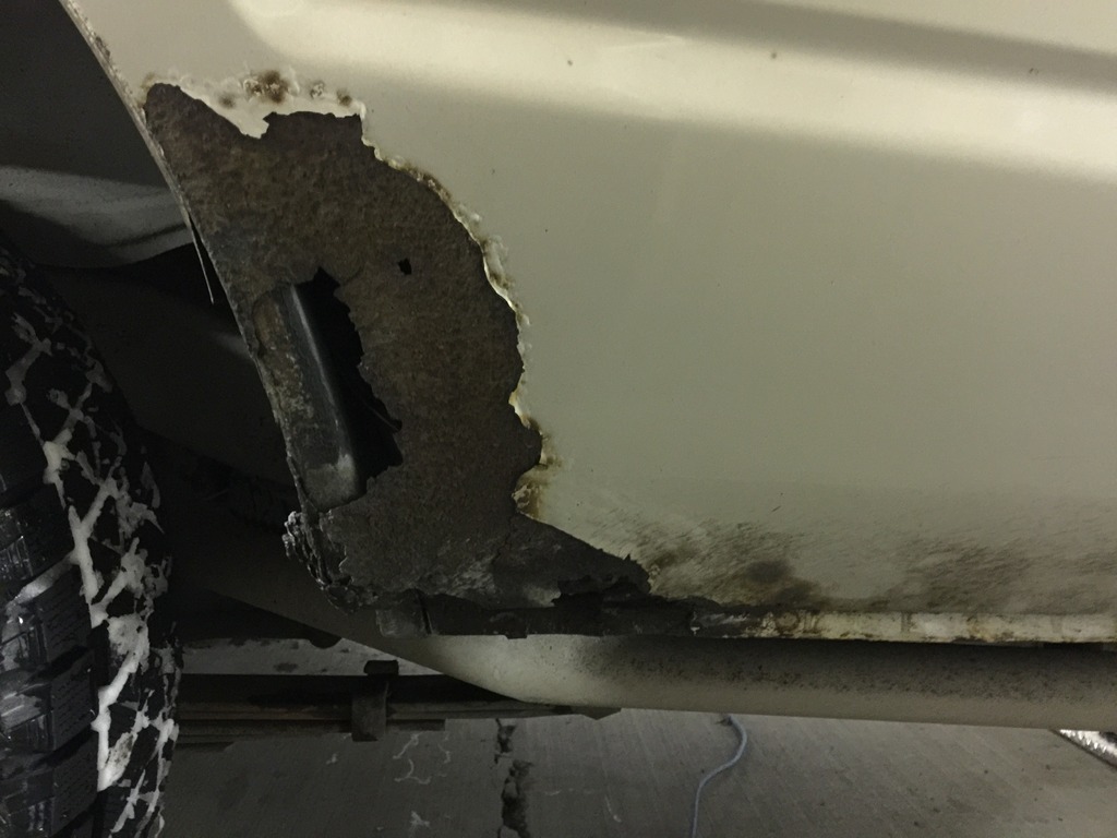

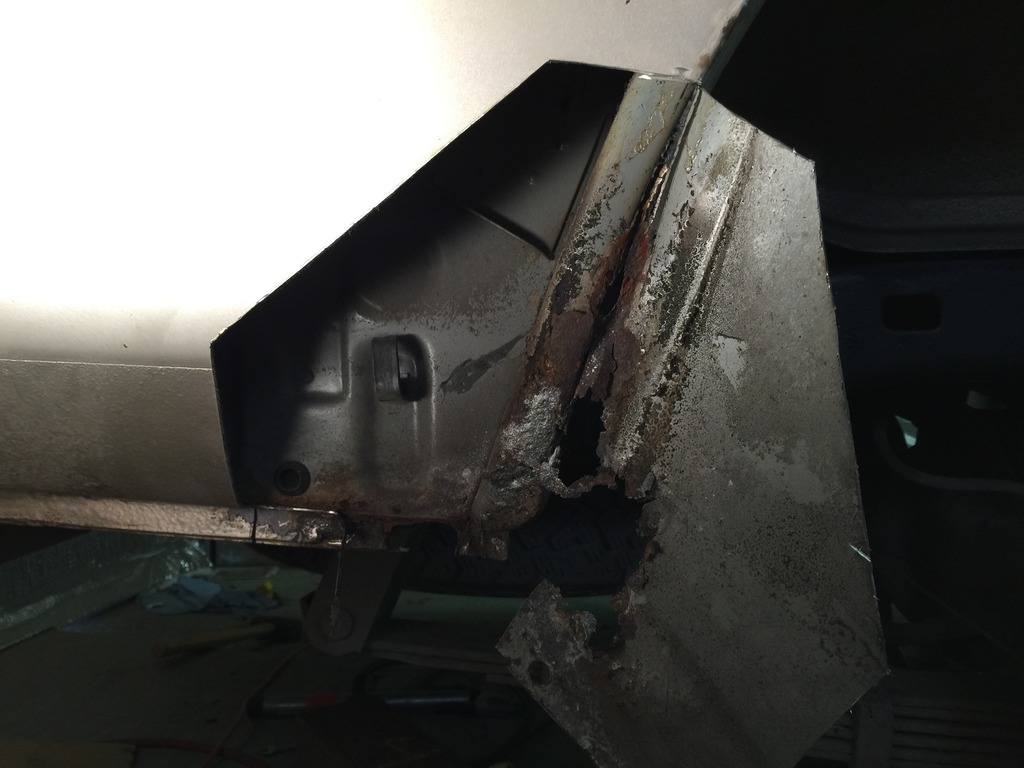

Here's a few pictures of the bad areas on the car...
Overall it looked ok until you got a bit closer

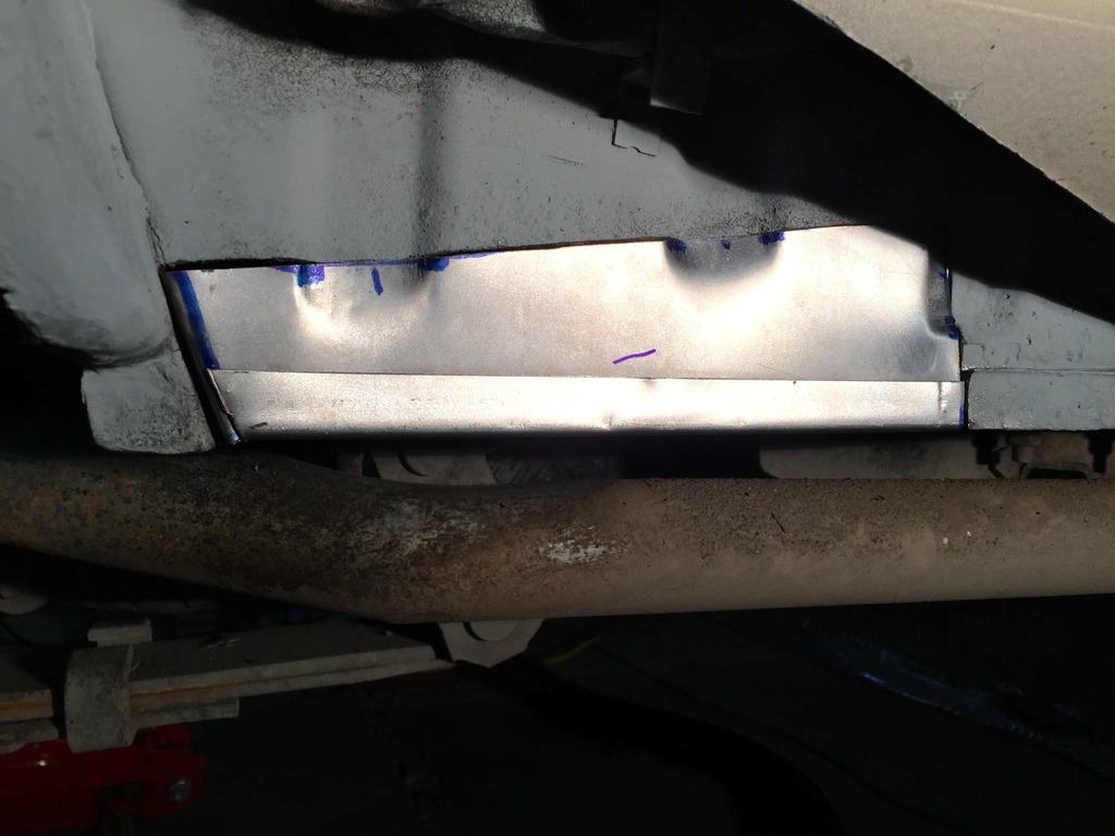

Now to more visible areas...The left rear fender had 2 exterior patches which it needed and one internal, so I started with the internal first so I'd get a bit more practice!
I was really pleased with how well the patch matched up after I made it.

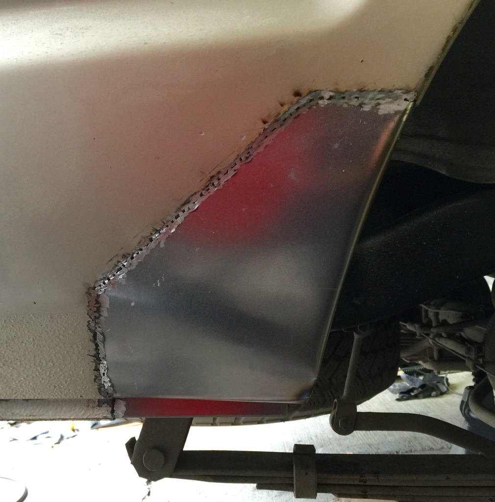

The other 2 had a lot of subtle curves and took a lot of banging and bending to make them fit, but it eventually worked...
Getting the lip to roll into the fender well was a bit tougher - I used some heat to help bend it around and make it smooth. It also required a few metal cuts to make it smooth where it made a tight curve - after cutting I trimmed and re-welded part of the lip to make it curve smoothly.
Got it pretty smooth, now onto the other side (behind right wheel)...

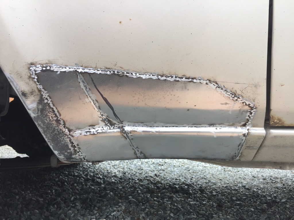

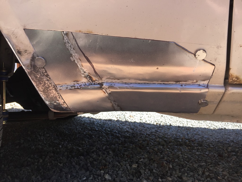

Now to the front left fender and definitely the toughest to replicate since it has a visible seam and multiple bends...I eventually had to cut the panel into 4 separate pieces to get the bends and seam correct. Thank god for Dolphin Putty to help smooth the welds!!
I also quickly learned to make sure the metal patch match the curve on the fender VERY closely before cutting away the rusty metal! Once the go-by was gone, it was certainly more difficult to get the panel bent correctly!
Lots of other rust cleaning was done and metal prep using POR15 for areas which weren't as severe.
Then the Dolphin putty was used to smooth the welded seams and improve some of the lines.

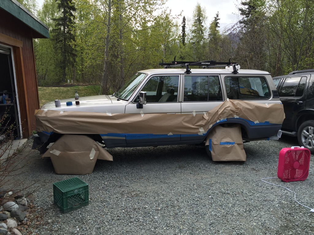

Primed the repairs, a bit more sanding and taped off for final paint. I decided to only shoot the repaired areas, since they were really low on the car and the upper paint was pretty decent...
Built my seriously red-neck paint booth in the driveway...
Luckily the bugs aren't bad up here just yet, so I didn't worry about sealing the plastic all the way, but it is still pretty cool (about 50 degrees) so I cranked the garage heater up and was able to keep it around 70 under the plastic, so that was nice for the paint!

Hi, Very nice work. Your off to a good start . We have 3 62s that color , we think it's one of Toyotas best colors. I'd also take off those chrome strips on the rockers and check for dirt and rust under there . Mike

Mike, the trim strips on the bottom were packed with mud, like most of the underside on the truck was! I don't think my buddy ever washed it, or turned a single nut on it... Fortunately there was minimal rust under them, so that was one of the few areas which I was lucky on! We like the color a lot too, but it's definitely a tough one to try and match, so a full repaint will definitely be planned for the future on this one! I painted the front end of my old Bronco a few years ago and the paint came out pretty rough (LOTS of wet sanding to make it look decent)...so I spent a lot of time setting up my paint gun on this one and really got it set nicely when shooting! I have a couple of little sags in the paint that show because of the metal flake, but we were both happy with the outcome!
