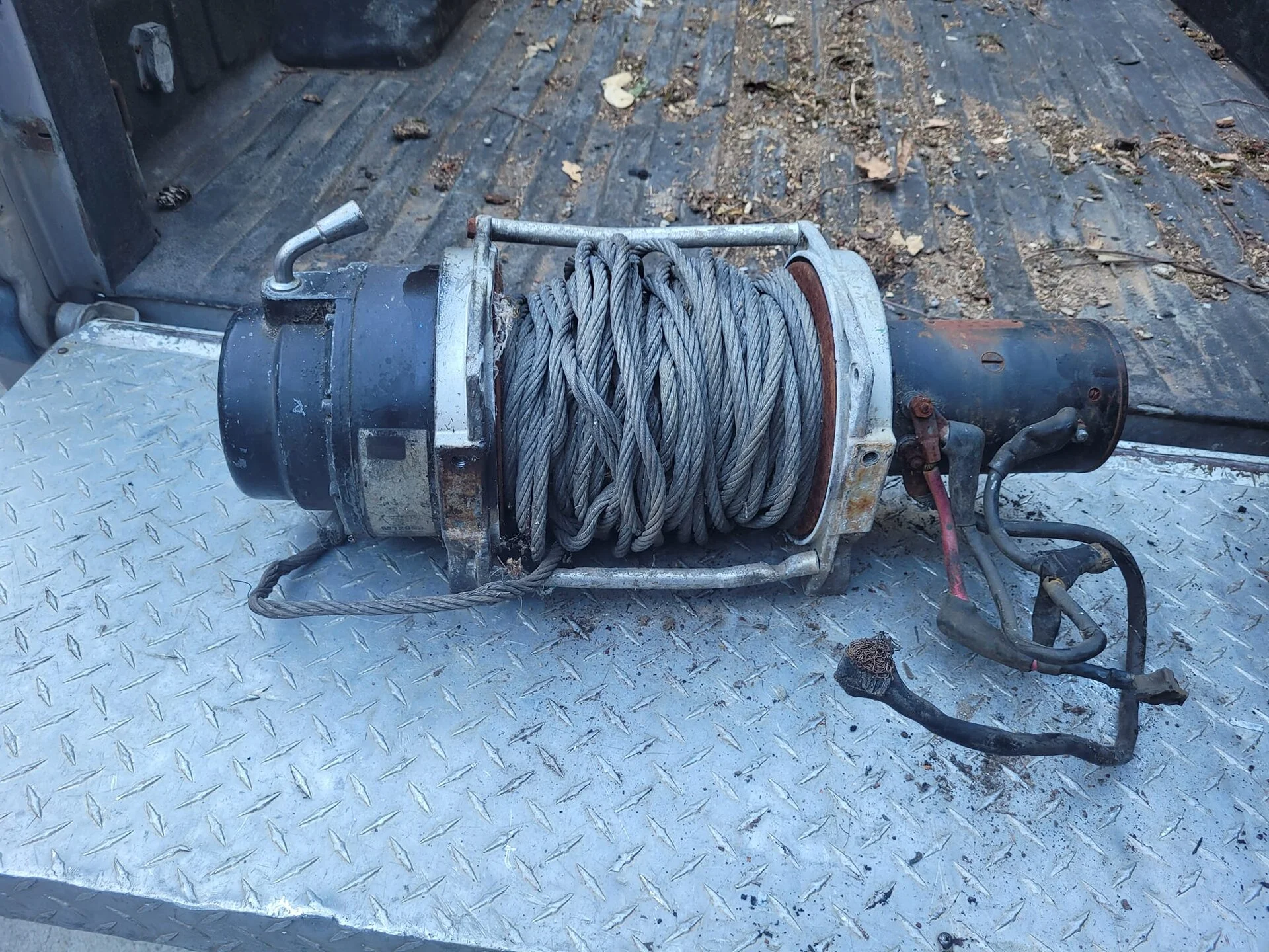

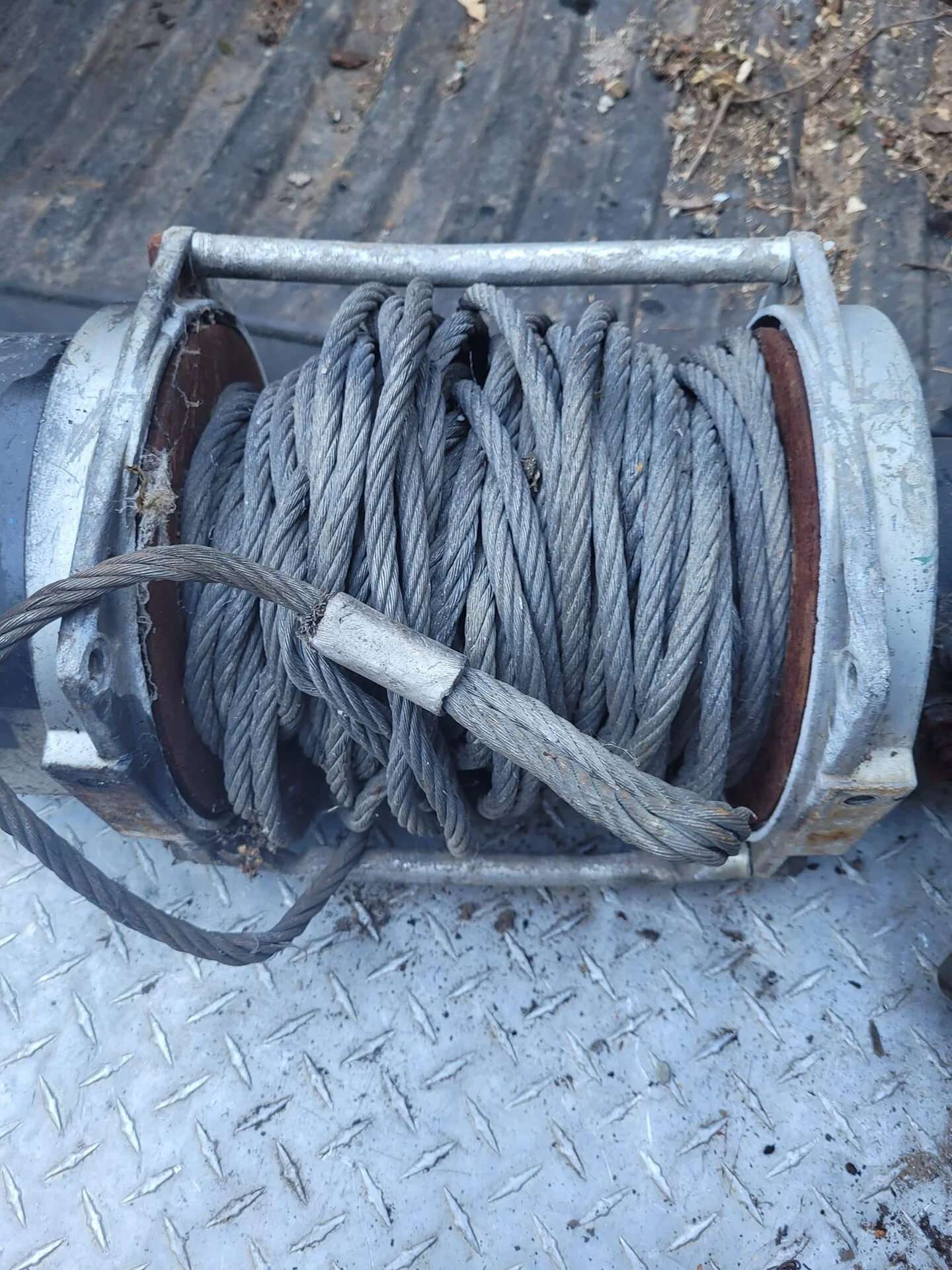

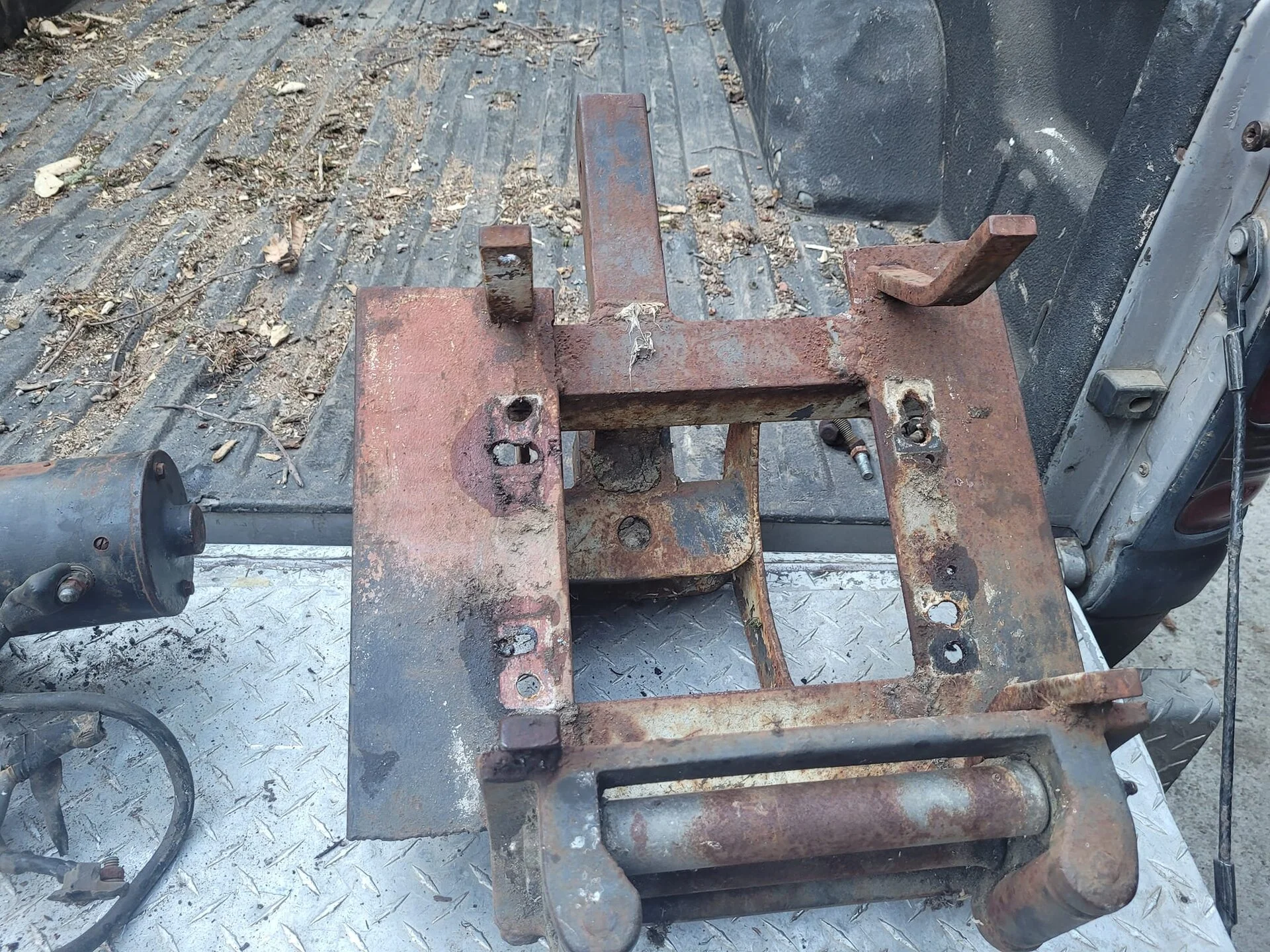

A friend gave me a beat up Warn M12000 for free. It was on a very heavy home-built receiver mount that weighed about as much as the winch itself. First thing I did was separate the winch from the mount and this is what I have:

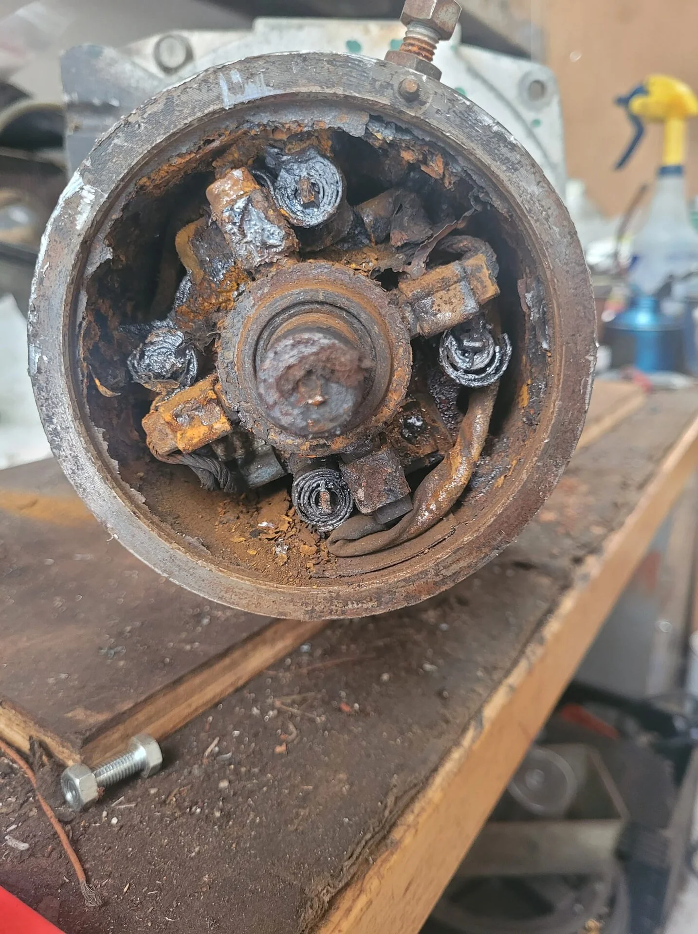

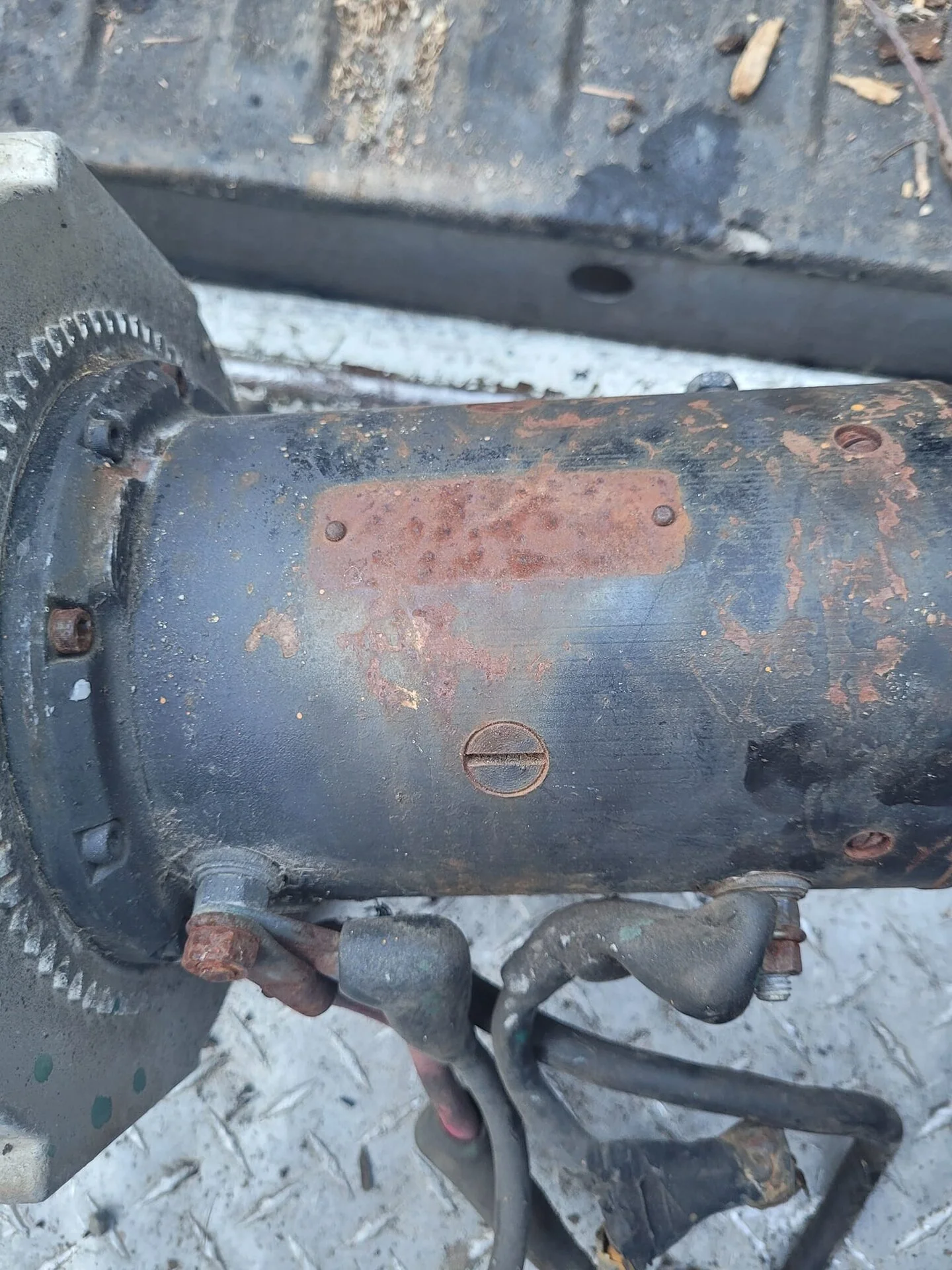

I put power to the winch and got a spark but no movement. I decided to take the motor apart to see what was wrong. Looks like a solid chunk of rust inside. Probably not economically feasible to repair this motor:

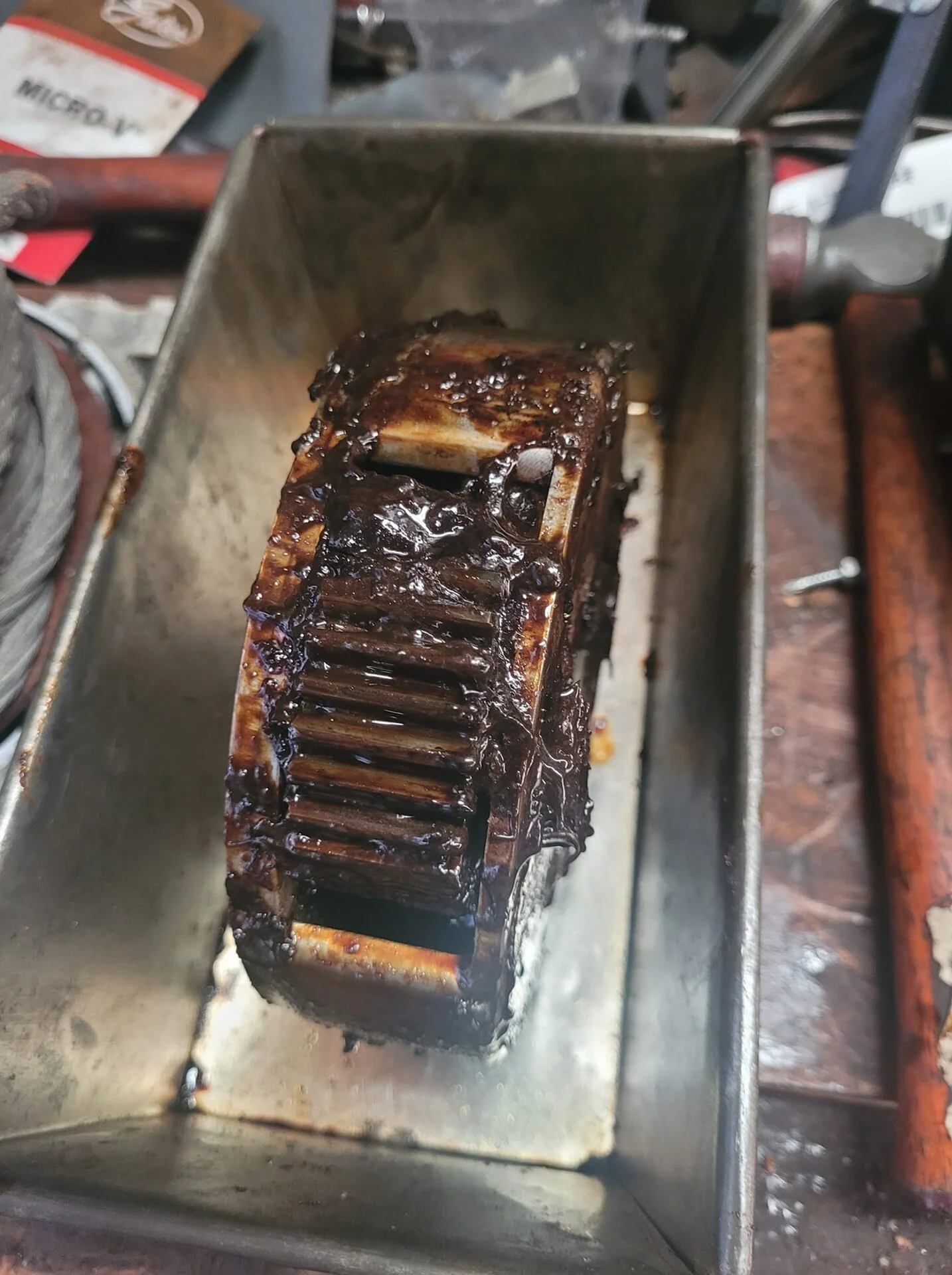

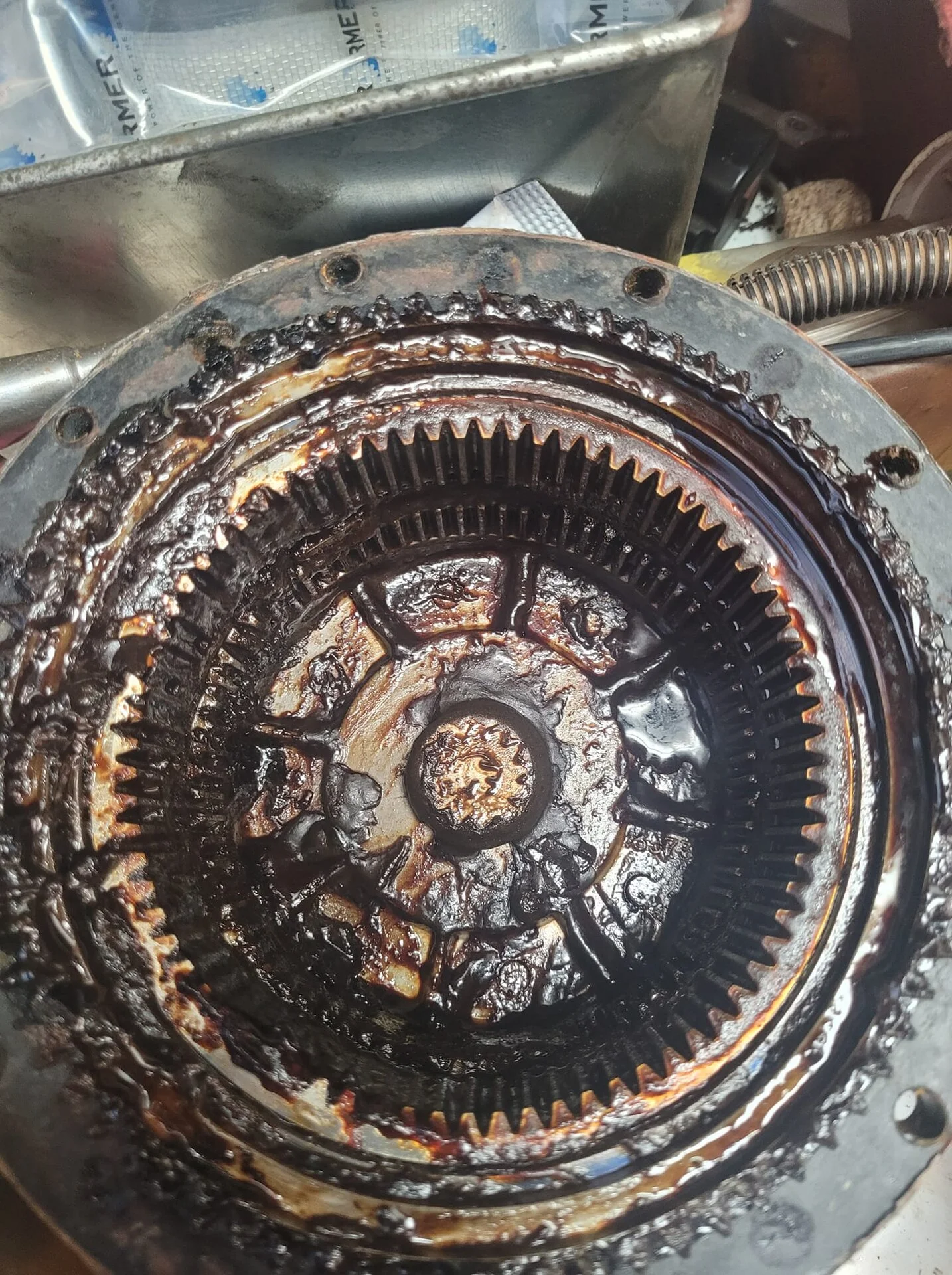

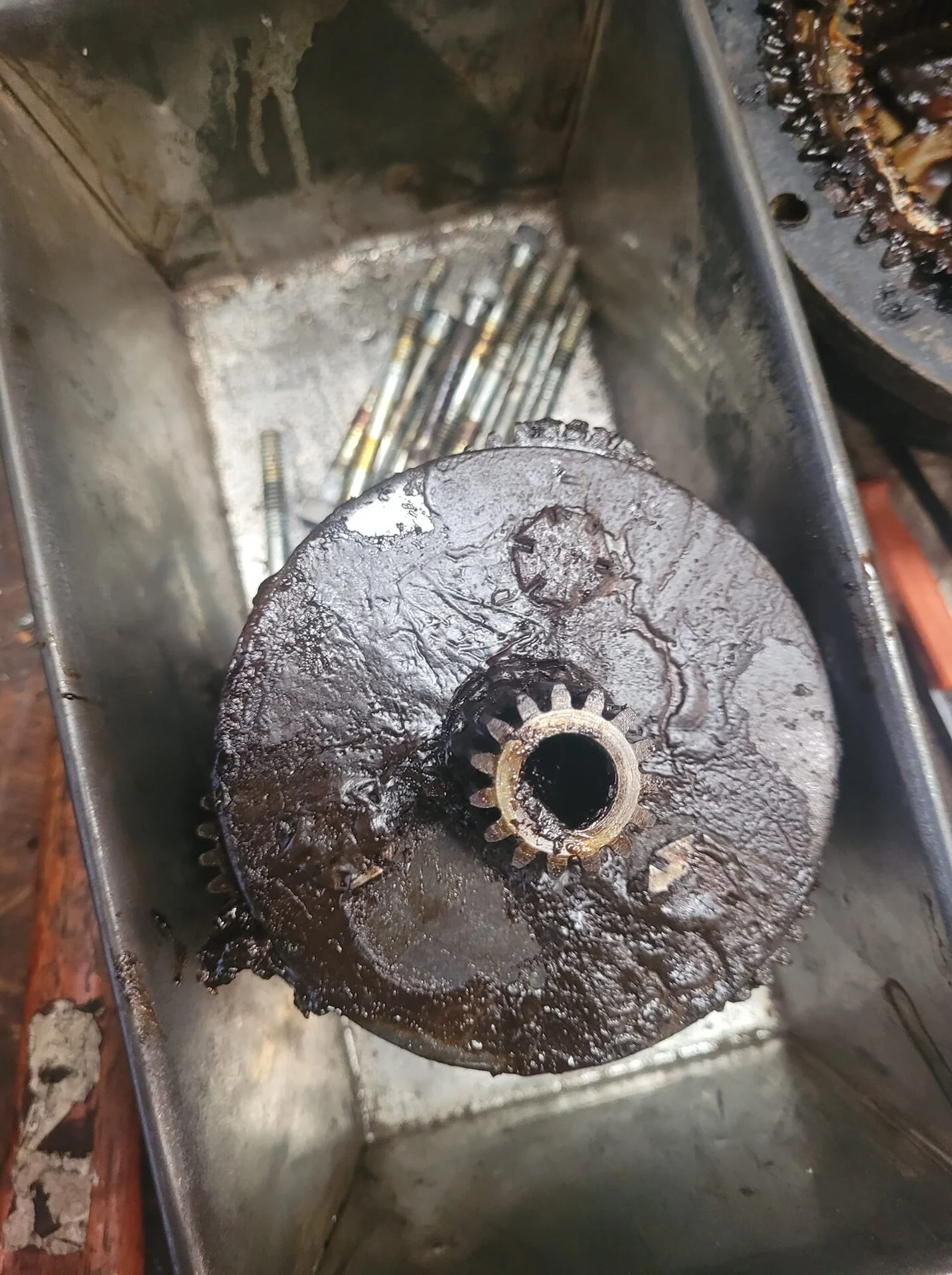

I pulled the gearbox apart and besides the old grease it looks good. Can use a good cleaning and restoration. Looks like a good winter project.

I believe the m12 has a splined input? A 6hp warn motor would be a good upgrade. Or gigglepin has motors. Not sure I'd try a dB electrical one, I'm a little gun shy with cheap vs good. Lots of rebuild threads here on m12 and other winches. Great projects to get you going again cause they have instant gratification because they are small and work again.

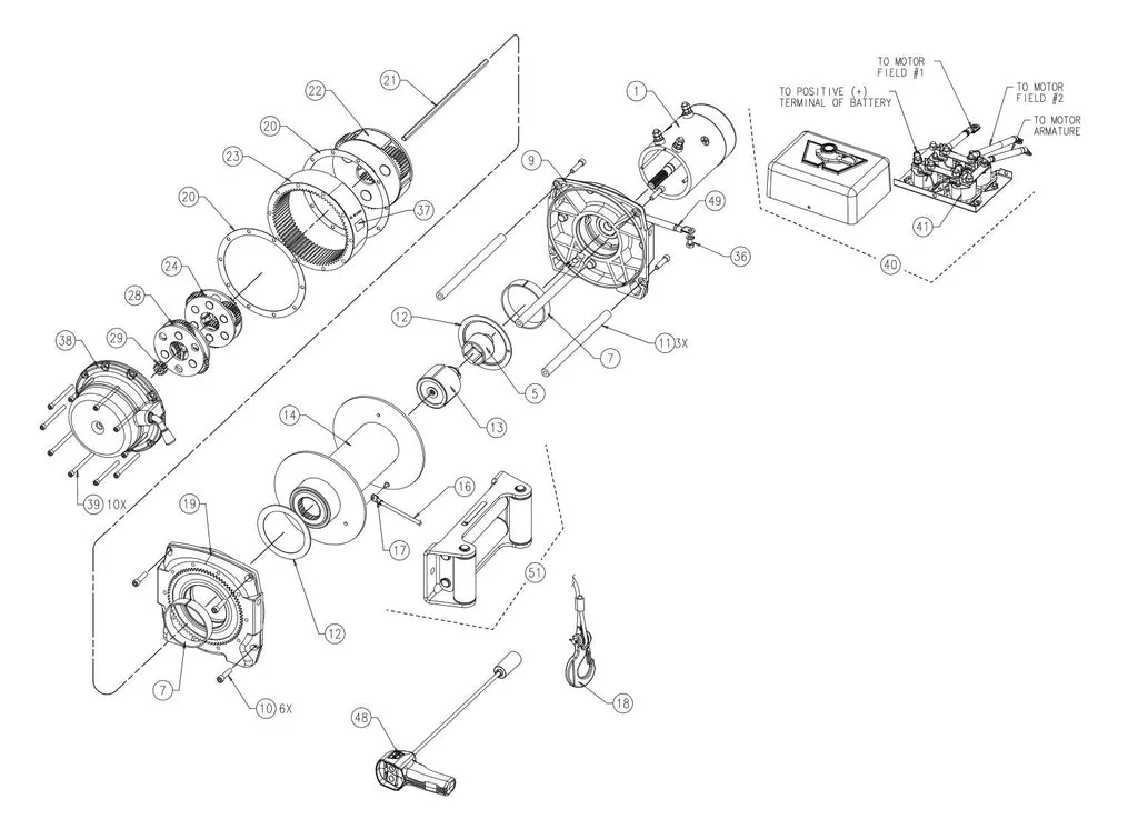

I am ordering parts for the winch. In looking at the IPL I think I should order the following gaskets and seals:
14964 2 gaskets
16336 2 bushings
13826 2 washers
13848 1 gasket
Are there any other wear items I should replace while it is apart? What is the best grease to use when I put it back together?

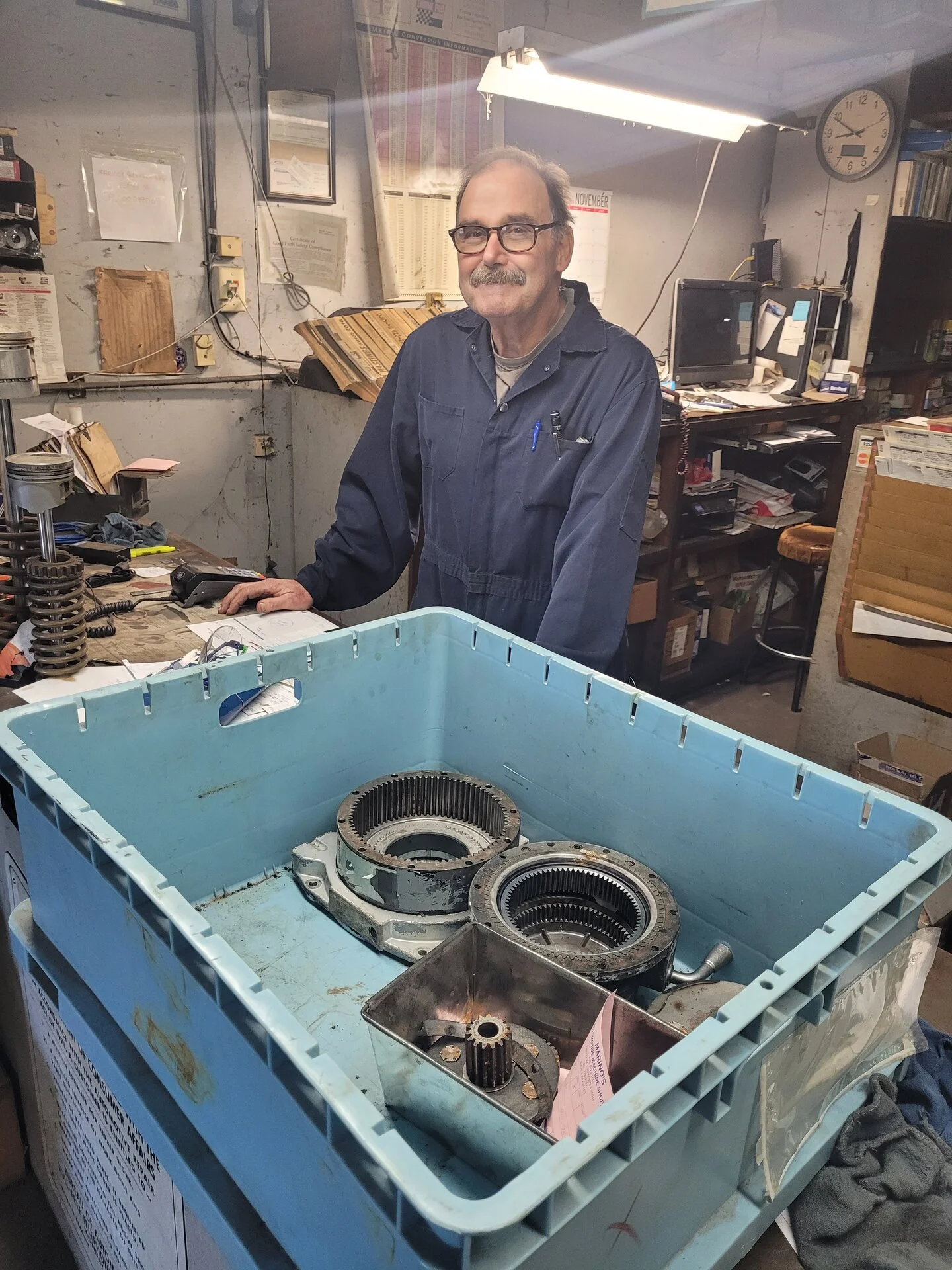

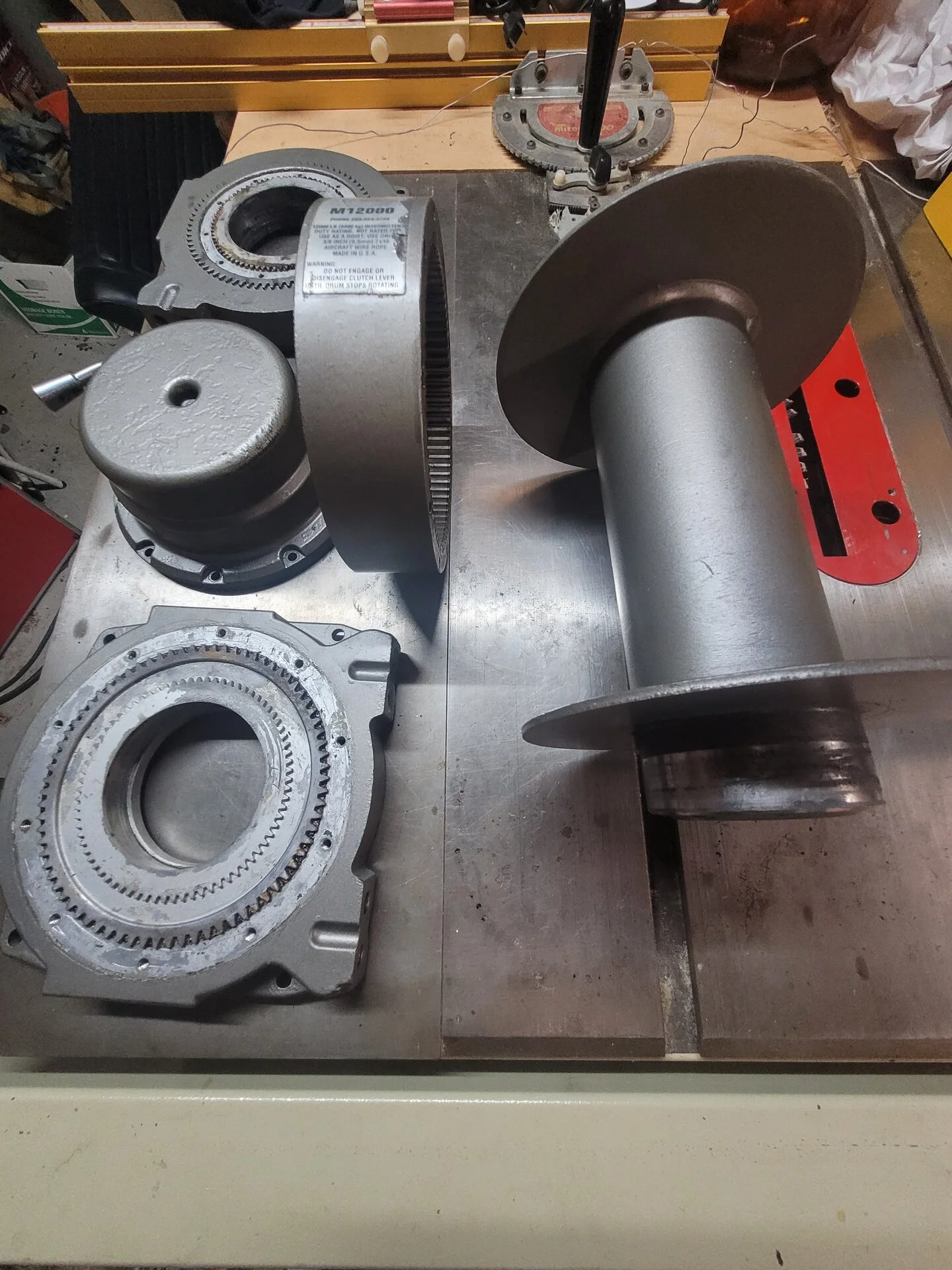

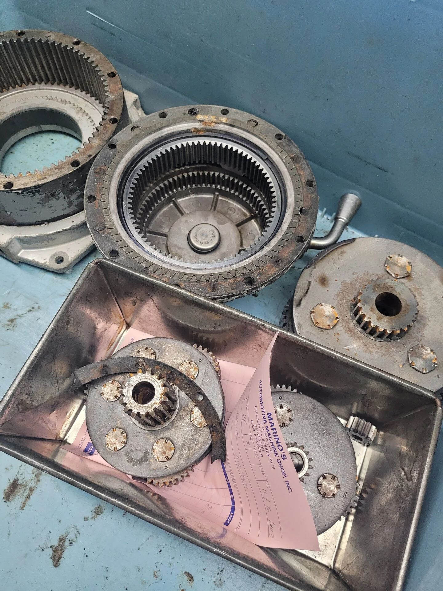

I took the gear train to Morenos in Watsonville. I've taken heads there for valve jobs and was very pleased. This machine shop started in the early 60s and is now run by Paul Moreno who's father was the original owner.
Paul put the steel parts on the hot tank for a week and ran the aluminum parts through the parts washer. He got that solidified, caked on grease off. I was very pleased.
All cleaned up
Paul with the parts.
I have gaskets on the way. Looking forward to paint and assembly.

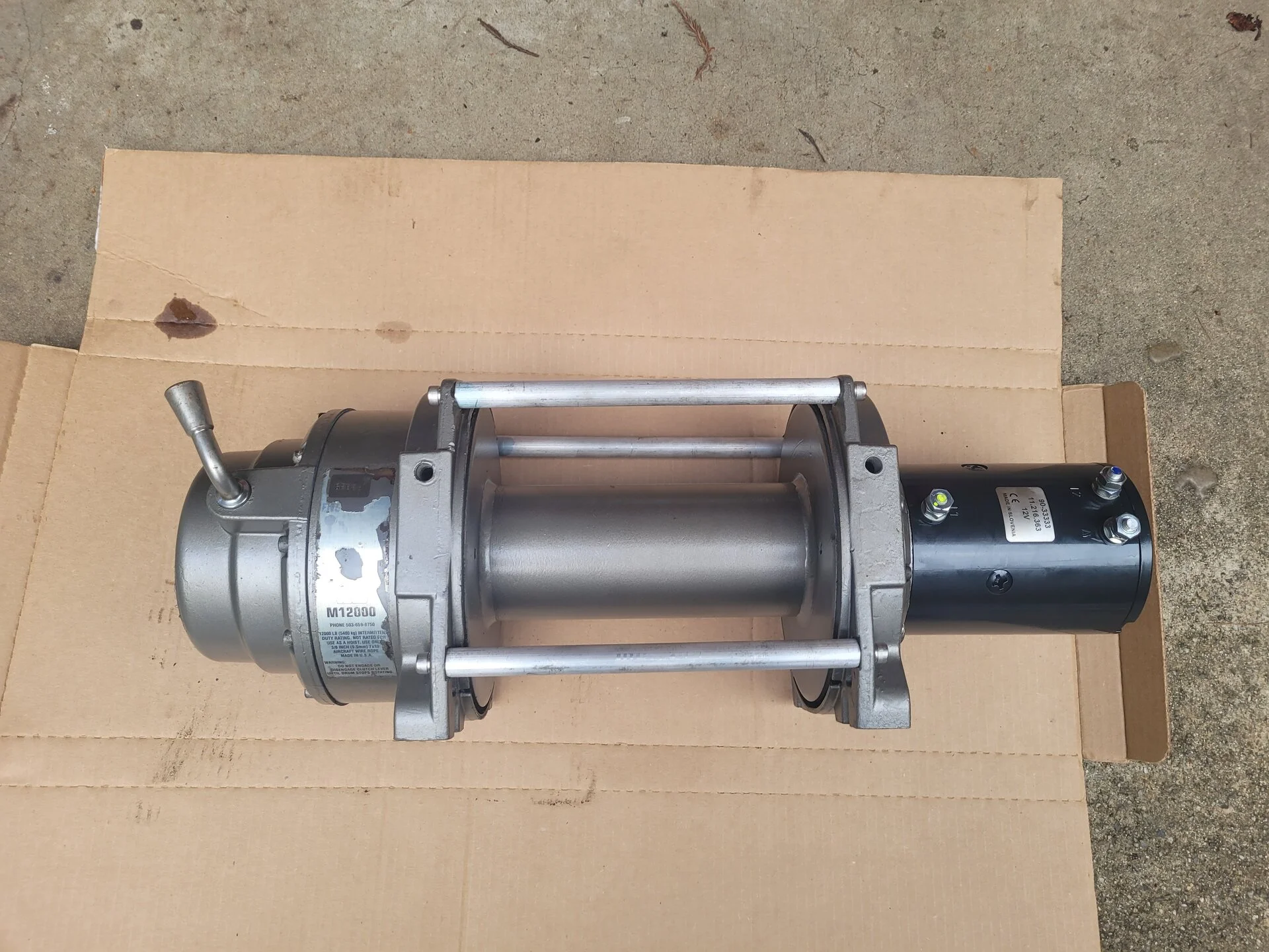

Its been a long time posting. I thought I should put up an update.
I got the case parts painted. I'll post pictures tomorrow.

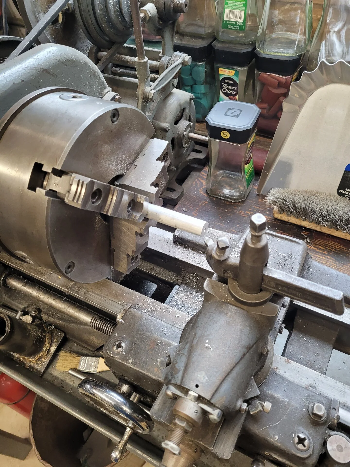

Today I madevthevtie bars on a friend's lathe. Made paer dimensions of the original parts.
Next weekend is assembly. I need to buy greae. I see different Aeroshell greases used on this board. Is it necassary? Whay do you suggest? Warn said any moly grease would work. Is there a compelling resson to use something orhervthan a moly grease I can pick up at the auto parts store?
Ok, I got some time to take pictures this is what I have:
Parts were sanded, primed and painted. I could have done a better job but really this winch will eventually live in a bumper and the paint will serve as corrosion resistance.

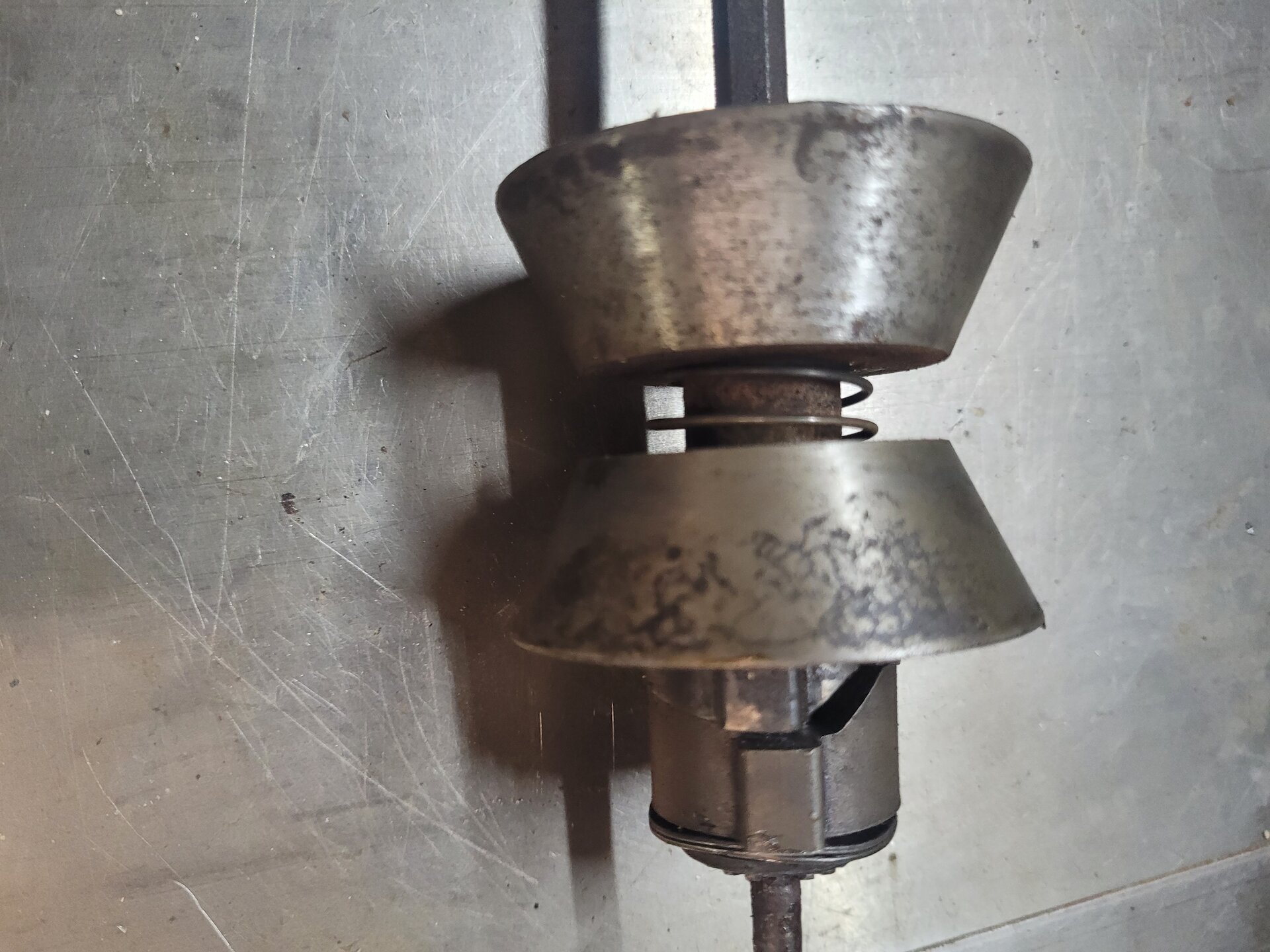

My brake assembly is pretty rusty on the ends. If I sandblasted and painted the ends would that cause any negative effects? How about sandblasting the entire shaft?
The cones had corrosion so I cleaned them up with Scotchbrite. The metal is stained but not pitted.
Finally, a question: What is the proper way to tension the brake before installing the shoes? I don't remember the outside cone rotating but it must have because there is no tension in the spring.
Thanks for following and thanks for the help. I appreciate this board.
Bob
the brake gets preloaded by clocking the outer most cam that interfaces with the motor hub.
actually pretty simple. pictures online show "ready" brakes to be installed.

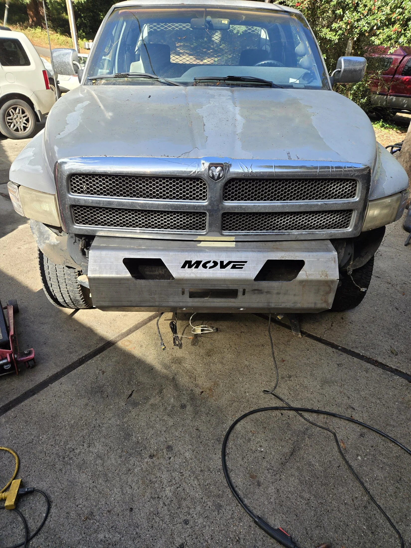

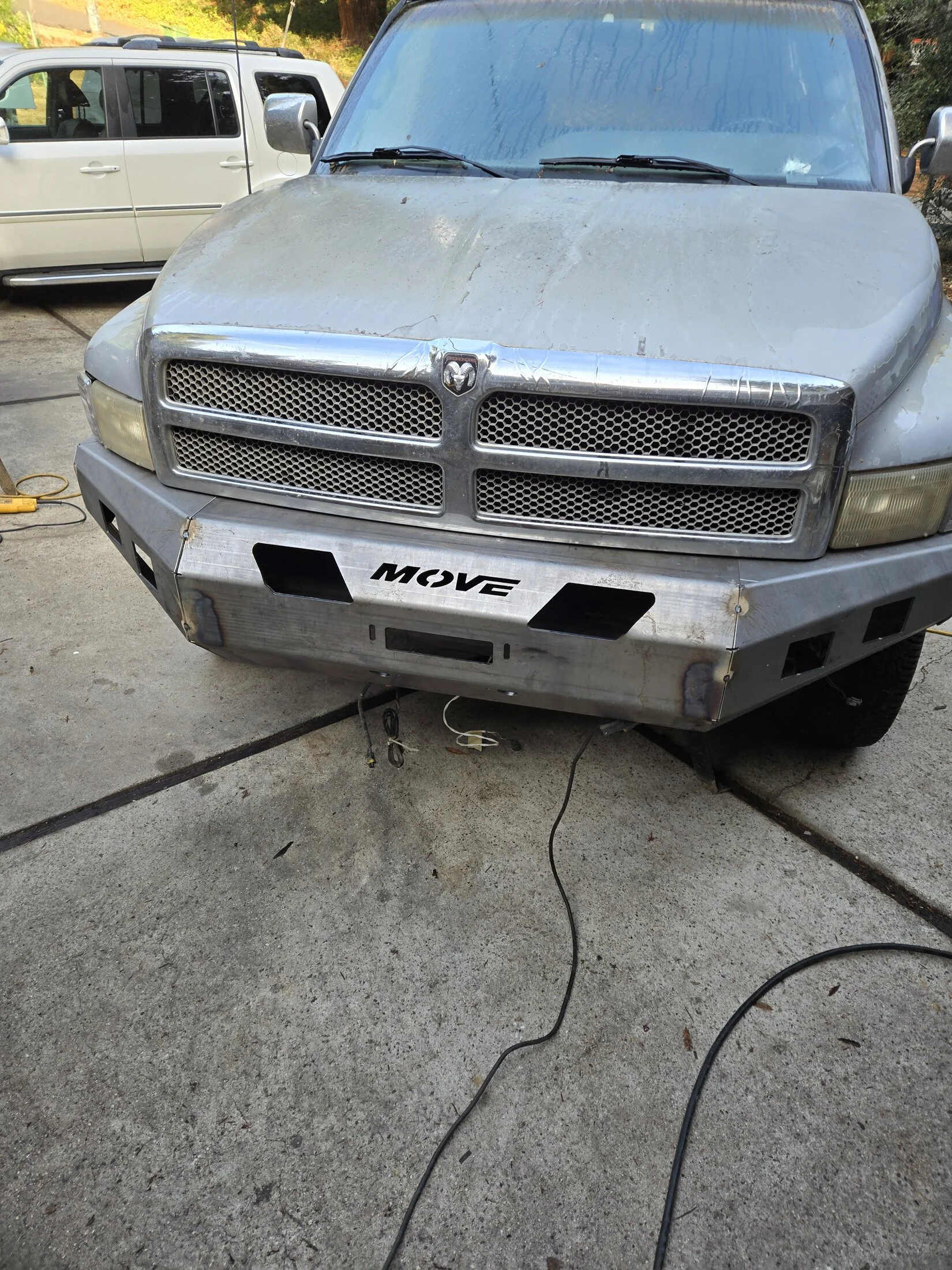

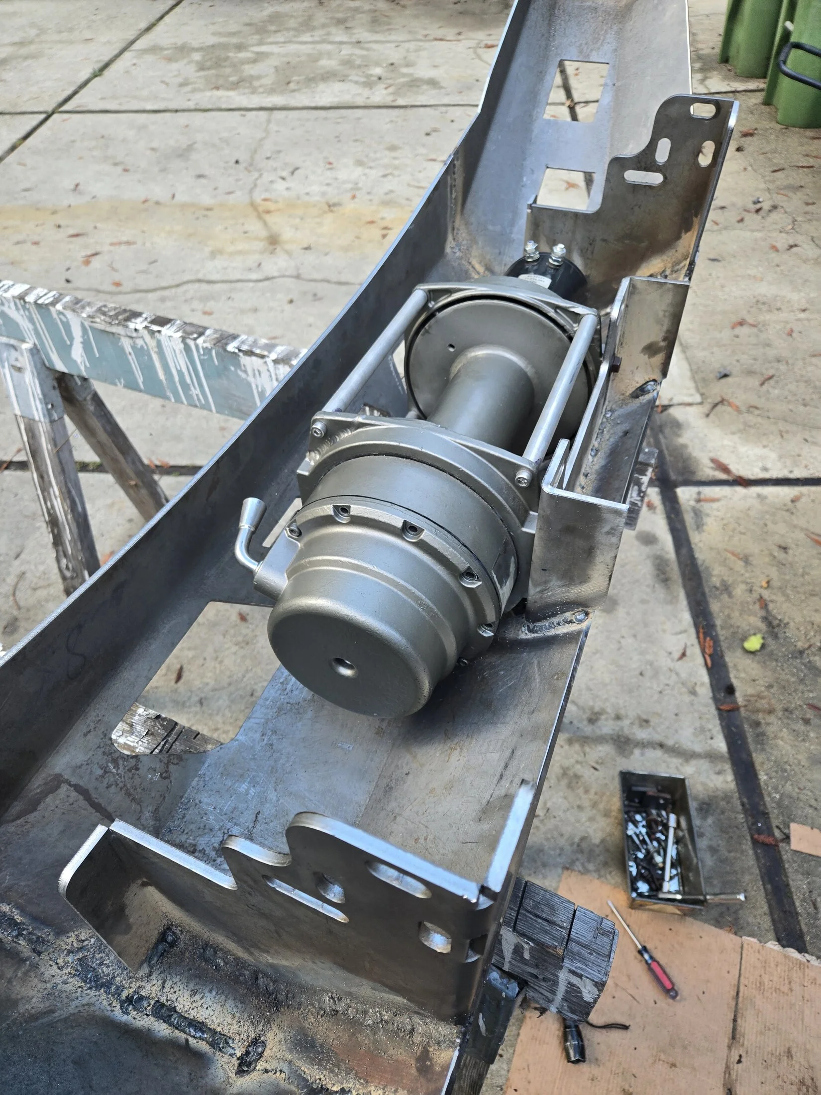

I have a friend in our off road group that bought a 2nd gen Dodge diesel truck like mine. He bought a M12000 and wanted a bumper. We bought a pair of MOVE Bumpers. They arrived and I found out he doesn't own a welder.

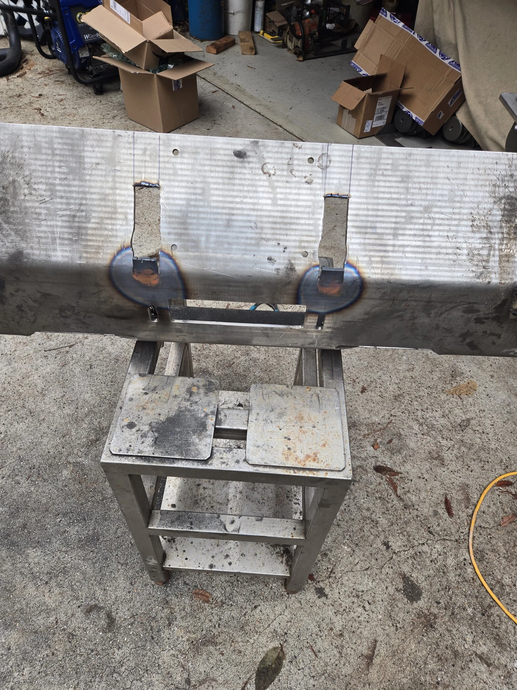

I worked on the "practice bumper" and mine at my house. These pictures are when I started mine.

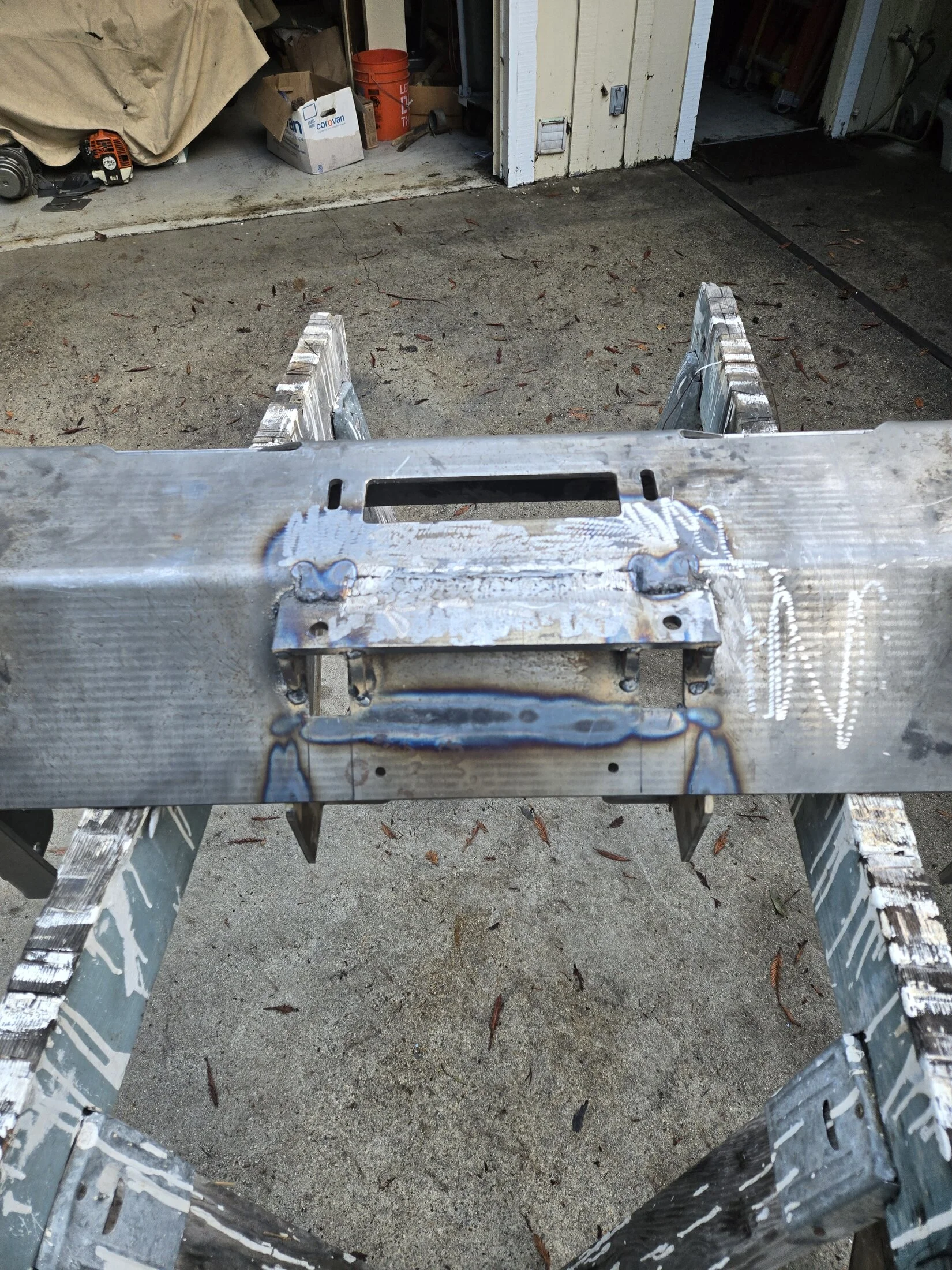

Move bumpers were designed for 8000 pound winches. The frame on a 12k winch won't fit. I did some mods to get it on there.

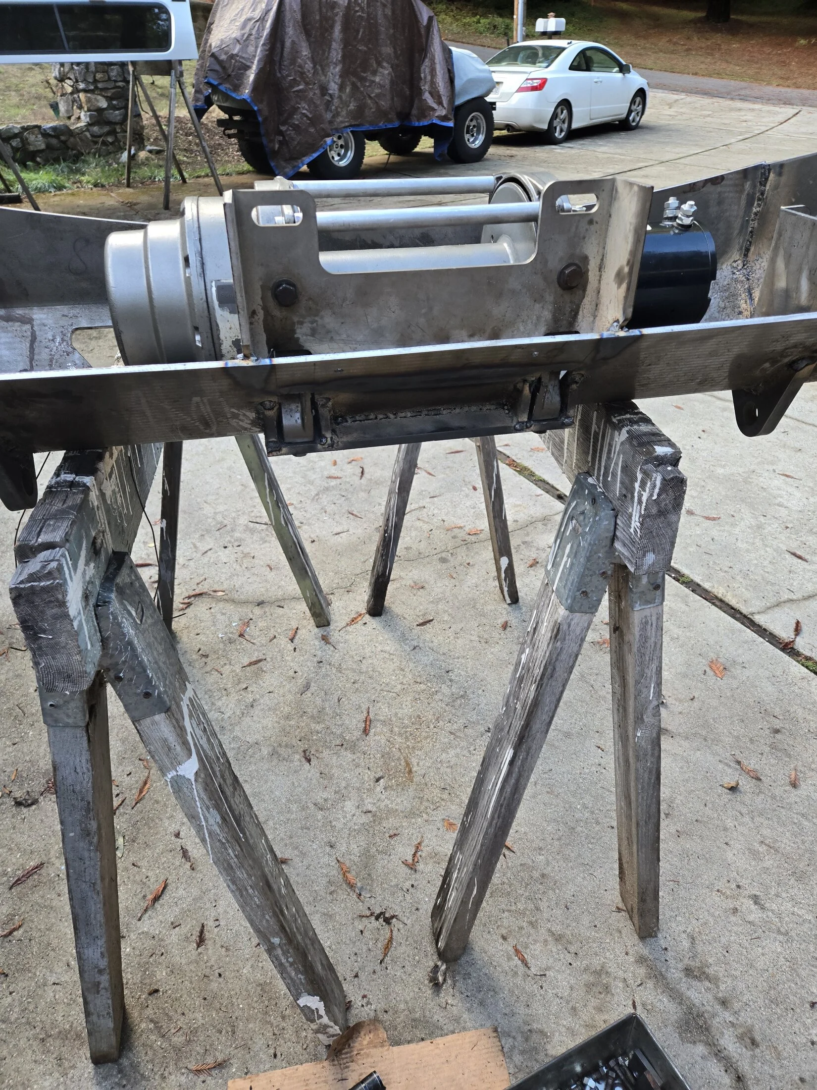

First, I lengthened the slots and using an acetylene torch bent center tabs even with the front of the bumper.

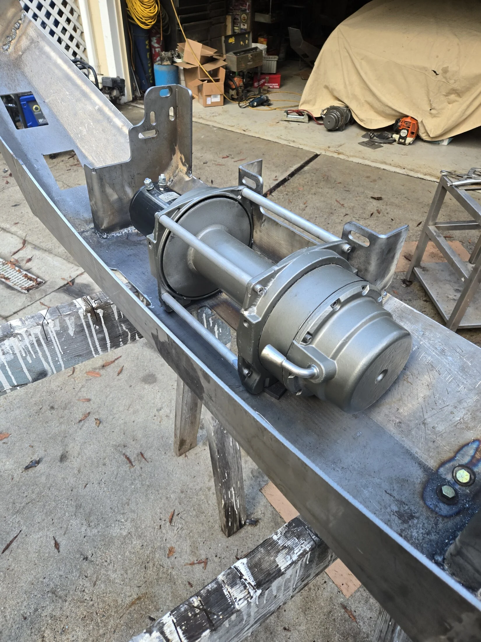

I bolted the winch to the existing slots with 1/4" spacers under the winch. Next I cut a length of 1/4" bar to fit under the tabs. I drilled holes to attach the winch and with it bolted in place tacked it to the bumper. I made 1/4" gussets and welded them on either side of the slots.
I had to drill holes in the bottom shelf for the winch. With the bolts installed I tacked and welded as much as I could. The welds were completed with the winch removed.
I want to put the bumper and winch assembly on the truck to be sure everything fits with no interference.
I have to weld the light brackets to the bumper and it's ready for grinding and paint.

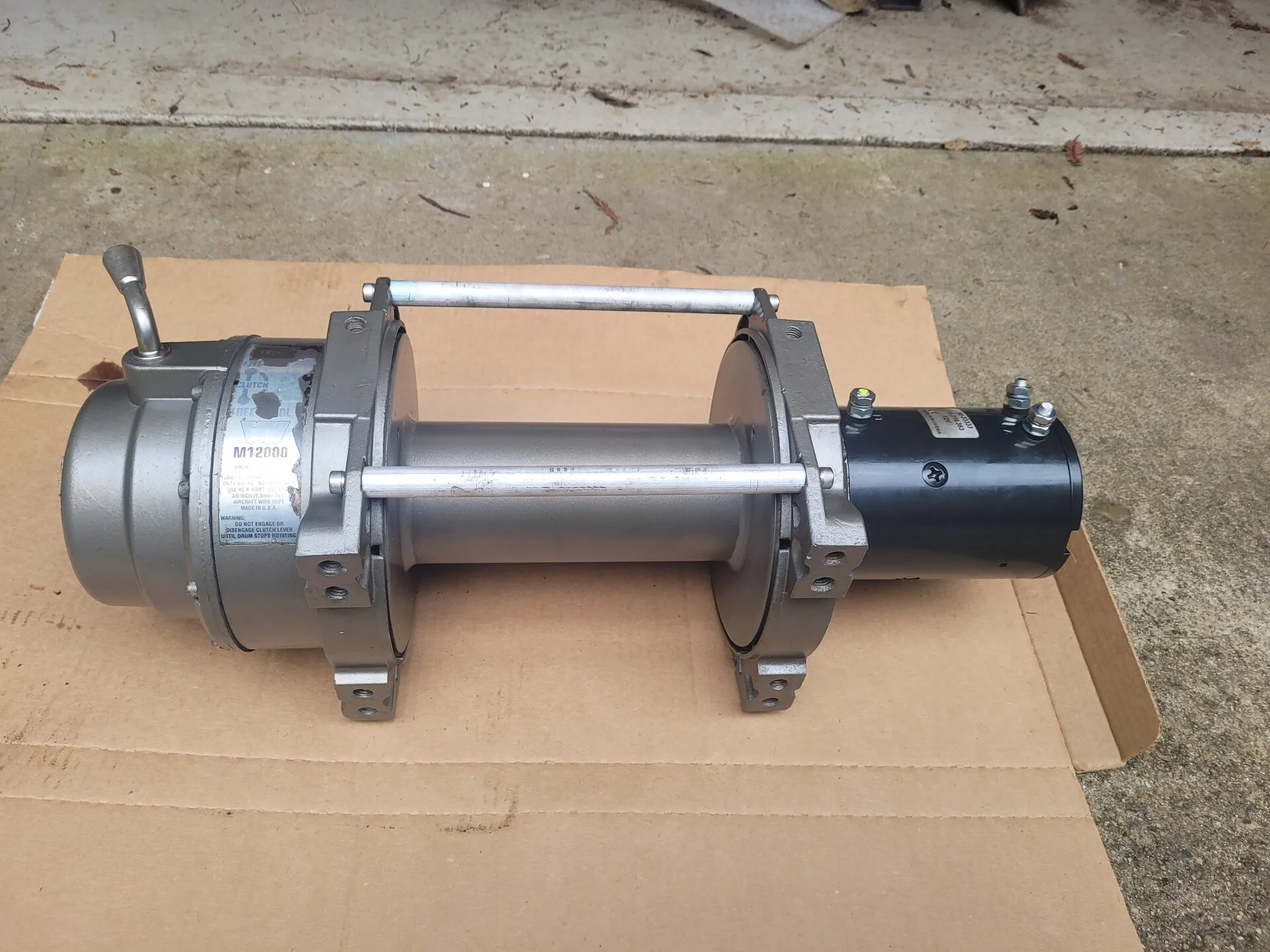

Typically, the M-12000 is mounted foot forward and the motor is on the right side (looking it it) (driver side). Looks like you might have it backwards in the pictures. Also, my buddy has the same bumper on his Dodge and has to modify it to fit an M-12000 I gave him.
