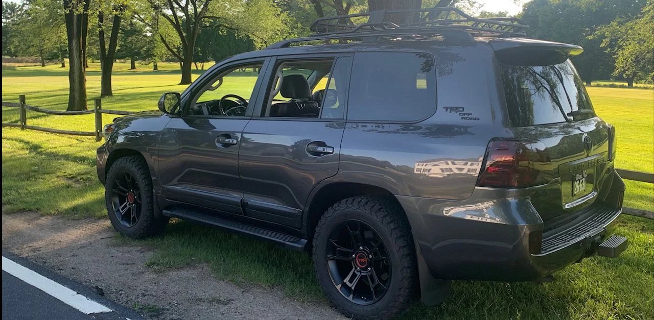

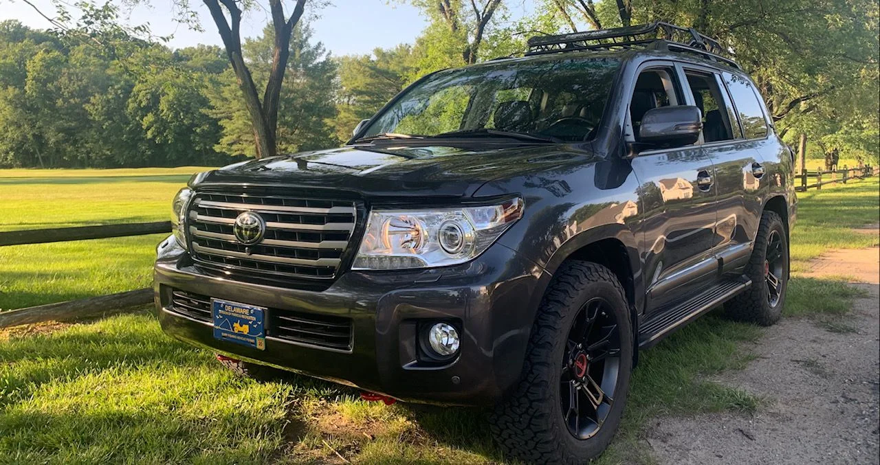

I like the design but the offset just looks weak. Could be the type of thing that look better in person?
Offset is my biggest issue with these as well. I’ve seen it in person and wasn’t very excited over stock wheels.
Rock warrior being a half inch further out and the wider bulge from the taller sidewall pushed me in that direction, personally.
Aren't they both +50 offset though?
No they are 60 which is same as ‘08-‘15 and in ‘16+ moves to 56. Rock Warriors are 50. They also bulge a little bit out so will hit rocks more easily. Look great though!

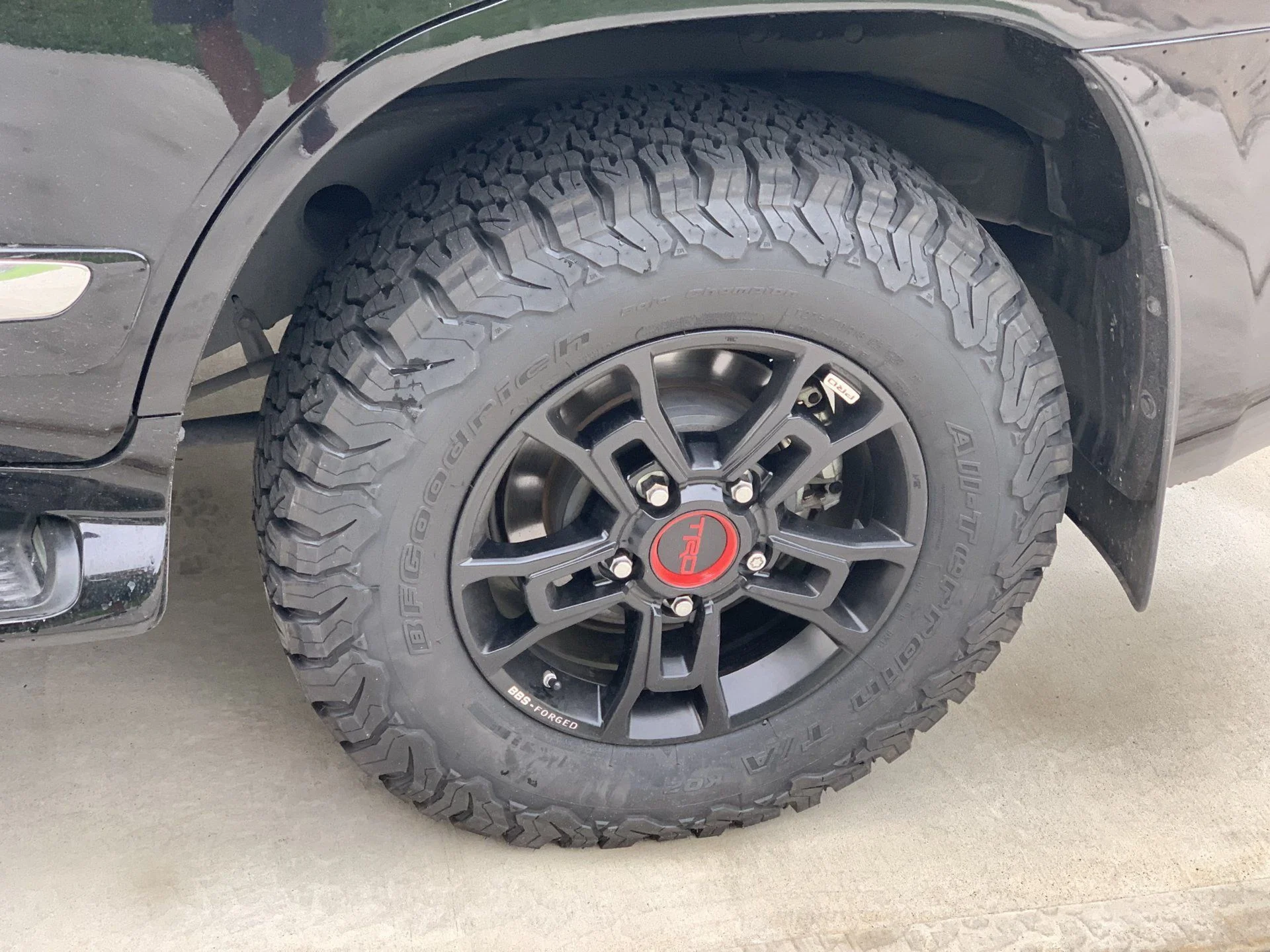

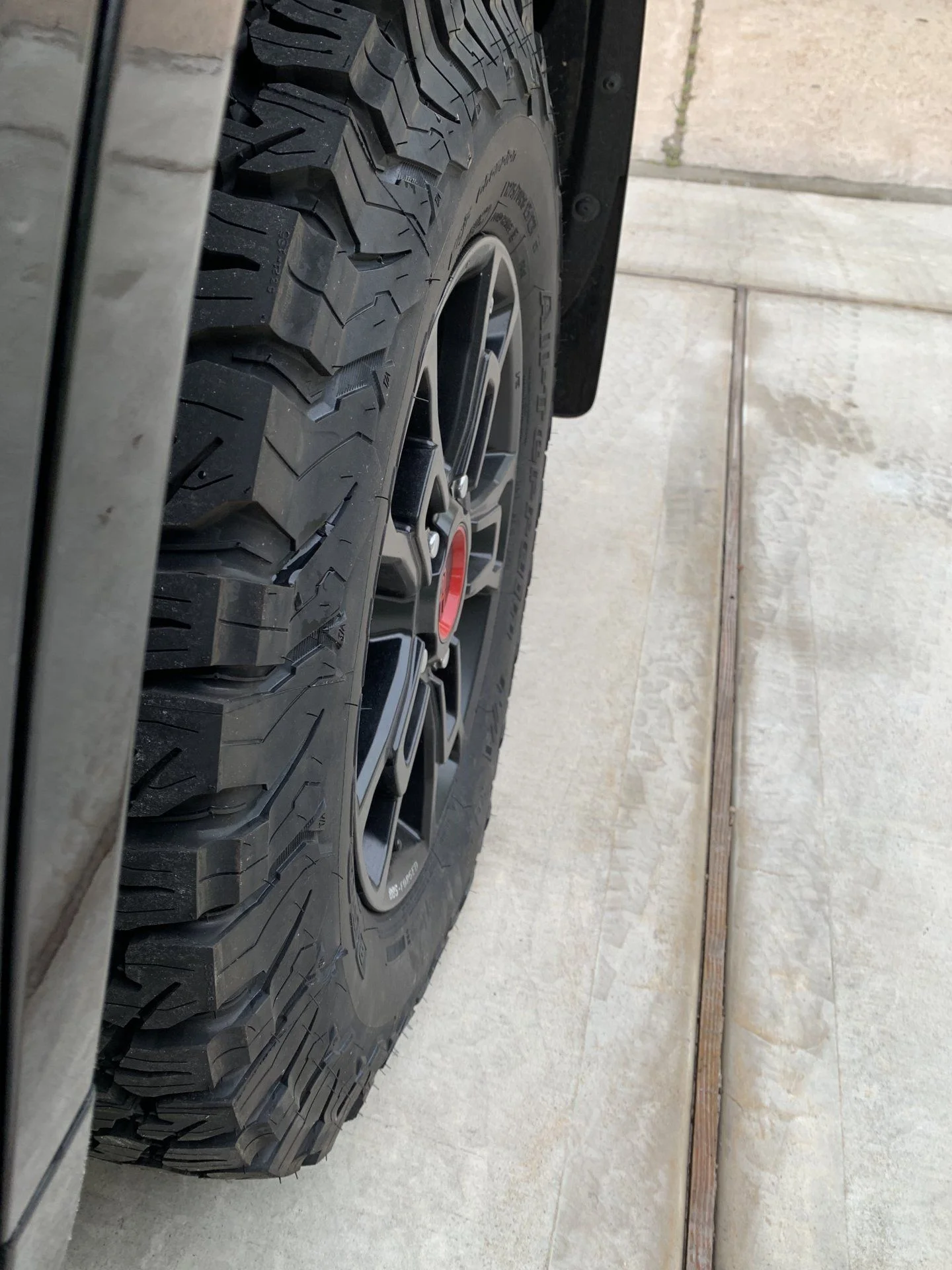

Here’s 36psi...
Is that much bulge normal?
Here’s 36psi...
Is that much bulge normal?View attachment 2015701View attachment 2015702
If your tires are the same temperature as the air temperature, and you trust your tire gauge, and they are inflated to the proper RCTIP for your LT275/70R18 tires, then yes, that looks normal.
It is very unreliable to judge tire pressures by sight alone.
Maybe a meaningless comparison, but here are my LT285/70R17 KO2 tires at 40psi which is the correct RCTIP for them:
The bulge looks in line with what you are seeing.
Don't worry - trust the science.

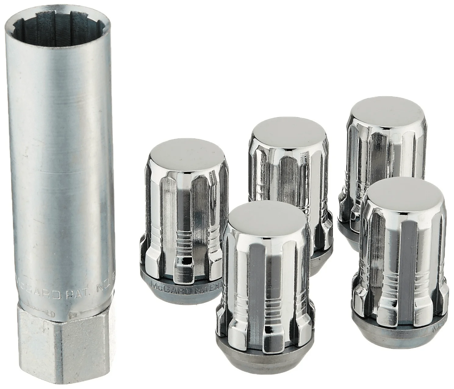

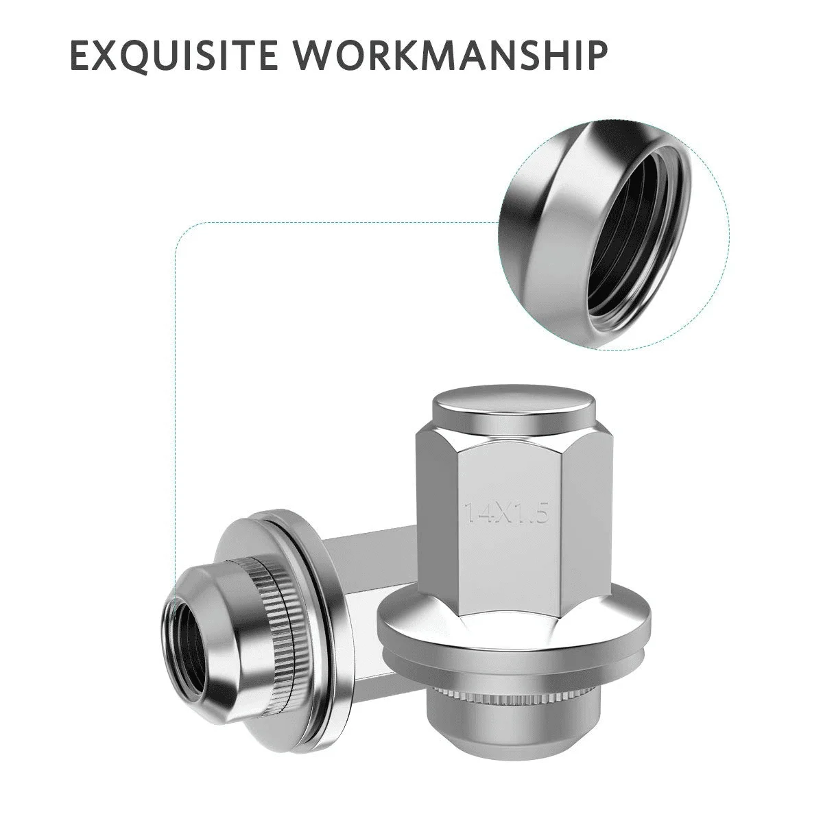

gaijin,
You posted these in a different thread, and I wanted to get your thoughts on if they would work for these BBS wheels?
LUGS
They are 14x1.5, but internet searches say that 12x1.5 and 14x1.5 will fit. is that accurate?
gaijin,
LUGS
12 x 1.5 will not fit. The Land Cruiser lugs are M14 x 1.5.
The FJ Cruiser lugs are M12 x 1.5 - that may be the source of your confusion. FJ Cruiser lug nuts will not fit on a Land Cruiser.
NOTE: The lugs I linked to will work on the Toyota TRD Rock Warrior wheels, but will probably not work on those BBS wheels. It looks like the BBS wheels require a standard Toyota alloy wheel lug nut with a flat seating surface - something that looks similar to this:
2017589
The TRD Rock Warrior wheels have a conical mating surface and require a lug nut that looks similar to this:
2017590
The Conical seat lug nuts will not work on a flat seat wheel like the BBS wheels.

I’ve been all over the mcgard’s website, but can’t seem to find any black lugs that will work. Do you know of any?
