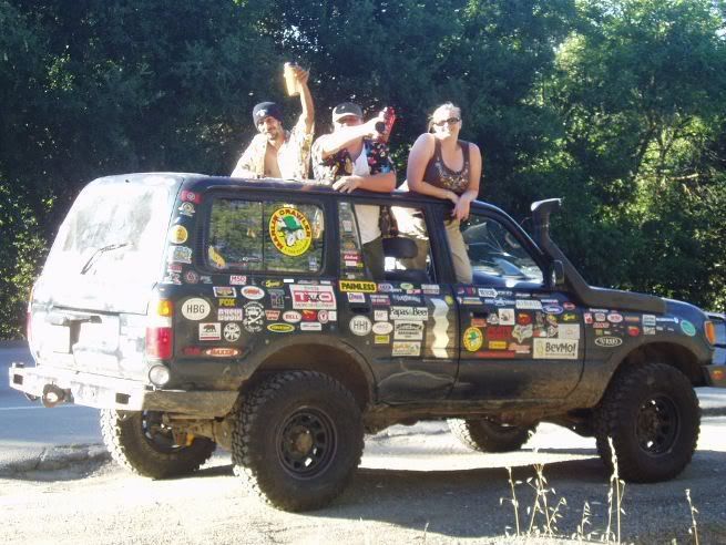

Mickey Rubicon has a green 80 w/ a few stickers on it. I think they were referring to your cruiser's sitcker collection.

This is Mickey Rubicon's ride.
