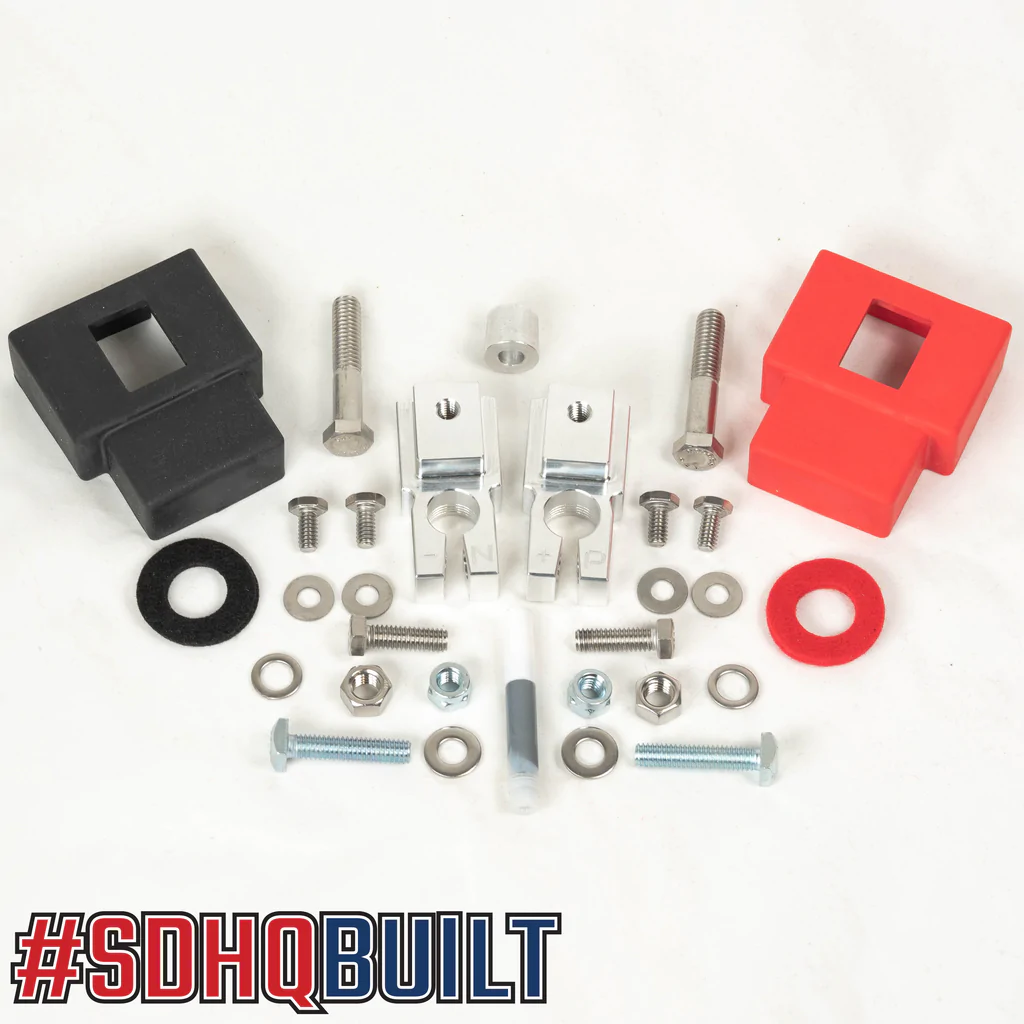

I bought these SDHQ billet battery terminals awhile back and am using MILSPEC battery terminals now.
Mine do not have the covers or the little black/red disc that goes underneath. But you can have mine just pay for shipping.
Those are aluminum?
Aluminum is a poor material for battery connections because it corrodes so rapidly. If you anodized it, it wouldn't corrode, but it wouldn't conduct either. Also, it's probably 6061 which really doesn't like bending at all. 6061 will snap instead of bend.
Battery terminals should be lead or copper.

Those are aluminum?
I am no longer using them. I have switched over to MILSPEC terminals. I am also weighing the options of swapping out my Optima 35A for a Optima Yellow Top D27F, I would love to be able to run dual marine batteries but the Optima marine batteries do not come in a "flipped/reverse" setup that the Land Cruiser uses.
