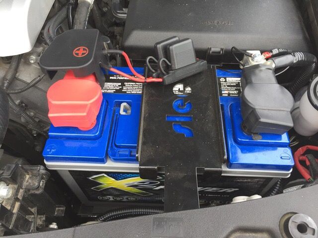

So I just got a new battery. Went with the X2Power Extreme Group 31 from batteries plus.
The terminal posts are further in from the sides though and I had to rig it up temporarily while I was there to get it connected. Anyone else running this battery? Any recommendations on the hardware I should get to make the install look cleaner?

I think Slee sells a main battery bracket for the type 31 that includes extensions for the posts. Markuson did a good write up on it.
http://www.sleeoffroad.com/installation/100_primary_batt_upgrade_tray_SOK009_v1.0.pdf
Thanks, I had seen the kit but wasn't sure if extensions were part of it. Thought it may have just been the tray and bracket. May have to get that.
Would certainly look a lot prettier than this.
Hmm, I'm wondering if there are no "official" specifications for marine battery posts relative to their location on the battery and manufacturers can just do as they please (unlike car batteries which are pretty specific). Odyssey posts are very different and probably could have been made to work with post adapters.
^^^^This. There is no standard terminal location. Don't assume the Slee tray comes with terminal adapters that will work, since it is made for the Interstate 31 AGM battery. You'll end up having to buy adapters for any battery you get other than the 27F size with terminals in the OEM location. You can find adapters of all sorts at an auto parts store or on Amazon, but I know from experience that the deep cycle 31 batteries will need some extra effort on your part.
For what is it worth, I have the same battery as OP and my Slee group 31 tray came with military connectors that worked well.

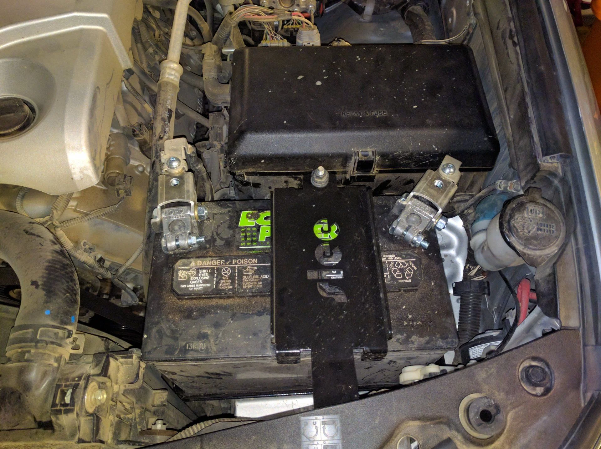

Here is mine -
Slee Group 31 kit with the Odyssey 31-PC2150T (not 31M that has both the threaded studs and SAE terminals - that looks like it would work without the extensions)

Also ordered the Slee tray. I know it works as is but I just want it done properly.
