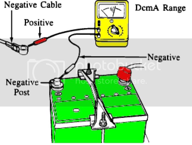

Do you have access to a multimeter? You need one.
Make sure the cars turned off and disconnect the battery negative lead and connect the meter between the lead and the neg terminal with the meter set to amps.
With the car turned off, no key in the lock, radio off and all doors shut you should have a current draw around 34mA.
Betting you have around 150mA.
You now need to start pulling fuses to isolate which circuit is pulling the power. Start with the DOME fuse located behind the front kick panel. 90% of parasitic draws are on that circuit. It feeds the interior dome lights via the door switches, the body management computer and the intrusion detection module.
When the current drops back to around 30-34mA you know you have the offending circuit then you start disconnecting things...
