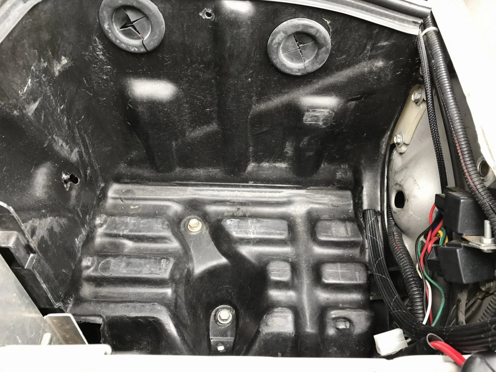

Here is what I did for the 1/0 cable routing. I drilled two holes then used a razor blade to clean it up. The cables run under/to the side of the battery without issue.

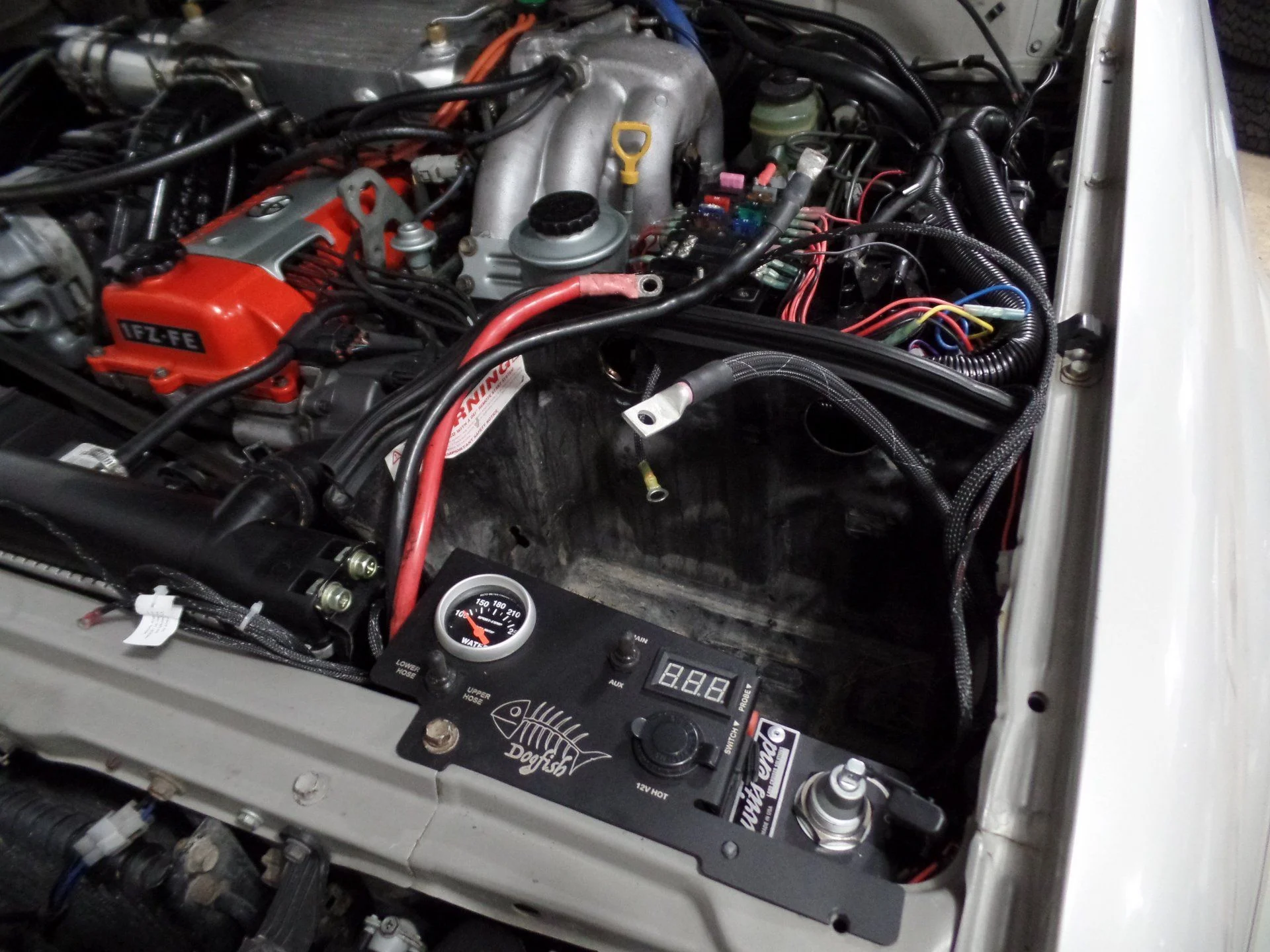

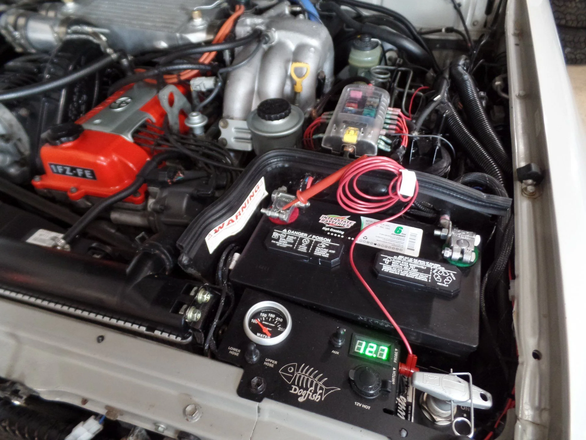

I got my disconnect in this weekend but I do still need to work on the temp guage hookup and I am running an led strip from my accessory switch soon too. The other thing is figuring out winch wiring at some point, but I am road worthy again.
The disconnect is a bit tight because I have led lights and the ignitor boxes are there plus my winch cables come up through that area. Still it fits good, just have to make sure nothing is binding.
Your biggest challenge will be wiring but with a bit of planning it works fine. The po already cut the battery box for the cable to go under for the engine block connection. I'm not sure if I did it right, but on the cable from the negative to the disconnect, I took a chainsaw file and notched the cable hole so my military clamp was square for a nice look. Also i notched the upper corner under the seal for the cable to come back through there. Once I stopped staring and repeating step six and got after it, things went quick. I think a gorilla installed my old block ground so that was the worst part (like PHH territory) getting that off. The new cable lined up there scary perfect.
