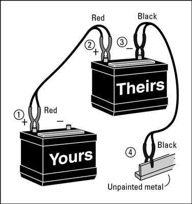

Safe Jumper Cable Sequence
1. Attach one Red clip to the Positive (+) terminal of the good battery.
2. Attach other Red clip to the Positive (+) terminal of the dead battery.
3. Attach one Black clip to the Negative (-) terminal on the dead battery.
4. Attach other Black clip to an unpainted metal surface, away from the battery, on the car with the Good battery.

The recommended way I showed minimizes sparks, possible ignition/explosion of built up battery gasses, may help to reduce damage to electronics and lends some credibility should damage occur, you can always say that you did it the recommended way. :) You'd be surprised the people I've encountered who didn't get the pos to pos piece of this.

"Positive to positive, negative to ground", where the "ground" means the chassis of the dead car.
This is because of the build up of gases from the battery. AGMs greatly reduce this risk but not impervious to it. Generally if I'm jumping a wet cell battery I'll make sure to ground to the frame of the dead car somewhere.
