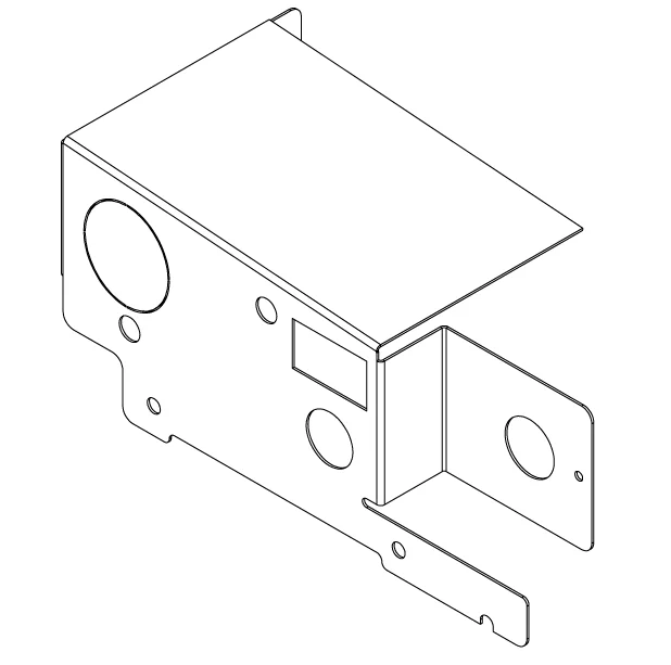

Hi, this looks great, do you have the measurements?
Well, which measurement are you looking for?

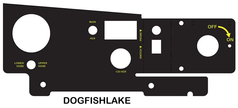

Here is your layout. Look it over and see what you think. The holes are specific to your application as is the etching. Please let me know what needs to change. The interior holes can change and the laser etching can change but that is it. Anything beyond that involves an engineering change I can't mess with at this point.

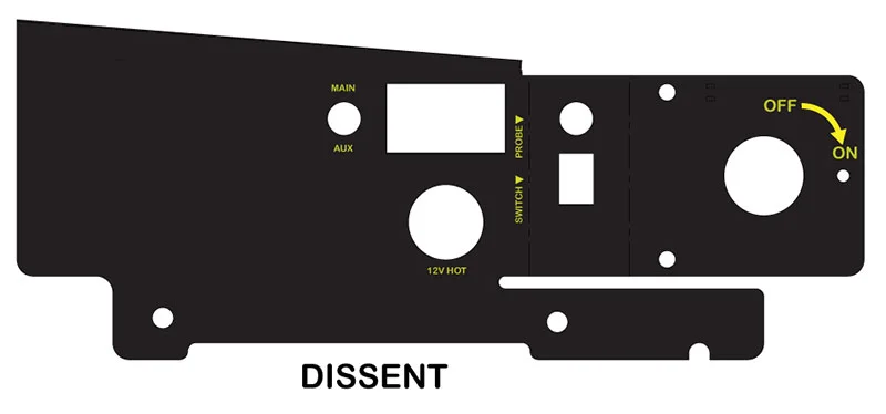

Is it possible to get all the holes and etching except the gauge and gauge switch? I'll definitely add the Flaming River switch and 12v Outlet as money permits.
