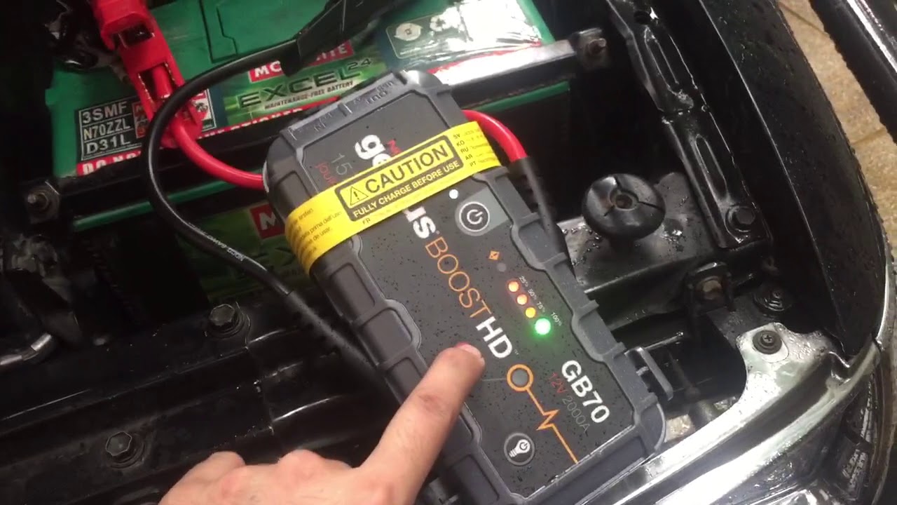

I use CTEK chargers, very happy with them. For jumping I have both a Noco GB70 and GB150. The GB70 has jump started both my HDJ80 and VDJ200 with ease. It even started my HDJ80 just by itself without a battery connected. I always bring the GB70 with me when I leave the house. Nice to have peace of mind knowing that you won’t get stranded with a dead battery.
