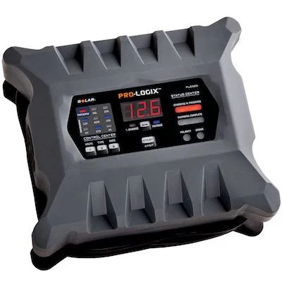

A coworker has this one from MAC Tools: Intelligent Battery Charger/Maintainer
I've found that it is a rebadged SOLAR - which you can find for about a third of what he paid for the MAC brand - downside is no jump start.: 20/10/2 Amp 6/12V Intelligent Battery Charger / Maintainer - Clore Automotive

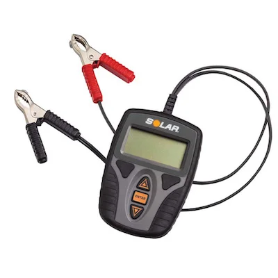

He also picked up one of these: 40-1200 CCA 12 Volt Digital Battery & System Tester - Clore Automotive
Again, he got the MAC version for about three times the price of the SOLAR at Amazon or elsewhere. Reading the reviews, there are mixed feelings about it. People say that it will tell you to charge the battery and then retest - at which point it will give you a good rating for the battery only to have the battery not start the vehicle a day or two later. Sounds like it doesn't actually load test the battery. Should I stick with an old-school carbon pile load tester?

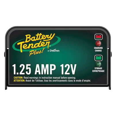

For battery tender/minder-type products, I do have two Deltran units that I've been very pleased with.
For my motorcycle, I have one of these: Battery Tender® Plus 12V, 1.25A Battery Charger
I have a lead connected to the battery in the motorcycle so that all I have to do is plug the Tender into the dongle hanging out by the key switch. I just keep it plugged in all winter.

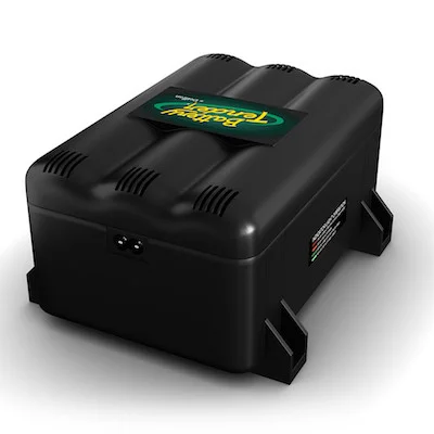

For the Bobcats (skidloader and mini-ex) I have one of these: Battery Tender® 2-Bank 12V, 1.25A Battery Charger
Those are easier to just use the alligator clamps on the batteries than a permanent dongle. When I put them in the shop, they just get hooked up.
Those work great for storage, but there are times that one/both of the Bobcats is outside and doesn't get used for awhile and needs a charge - and then there are the autos. Those are more the ones I'm looking for a tester and charger/jump starter for.

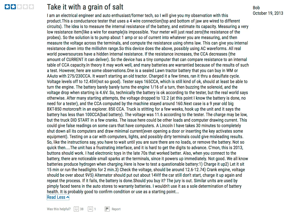

From this review, it sounds like the HF unit is similar to the SOLAR one I mentioned in the first post:
I see similar comments about the solar, so it appears that is the nature of the beast for those sorts of testers. Sounds like the carbon pile units give you a better bang for the buck.
