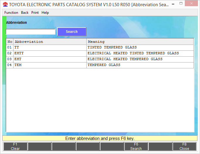

Toyodiy lists a bunch of glass panel part numbers for the barn-door 80's such as mine - can something decipher what all the descriptions mean please?
68131CGLASS, BACK DOOR, RH
68131-60040*TT, T=3.51$172.58
68131-60050*EHTT, T=3.51$425.66
68131-60070*EHT, T=3.51$235.68
68131-60170*TEM, T=3.51$126.16
68131DGLASS, BACK DOOR, LH
68132-60010*TEM, T=3.51$67.89
68132-60020*TT, T=3.51$95.52
68132-60030*EHTT, T=3.51$230.14
68132-60050*EHT, T=3.51$197.69
I know that the prices shown mean nothing in reality. I've tried looking up genuine glass for the side cargo windows (fixed type) and found there are genuine Toyota substitutes for the original part numbers and there might well be for the barn door glass panels too. Barn door panels need to have demister elements so that might be what the 'E' bit means.
Thanks, Craig.
TT​
Tinted Tempered Glass
EHTT​
Electrical Heated Tinted Tempered Glass
EHT​
Electrical Heated Tempered Glass
TEM​
Tempered Glass
T is thickness (厚さ).
