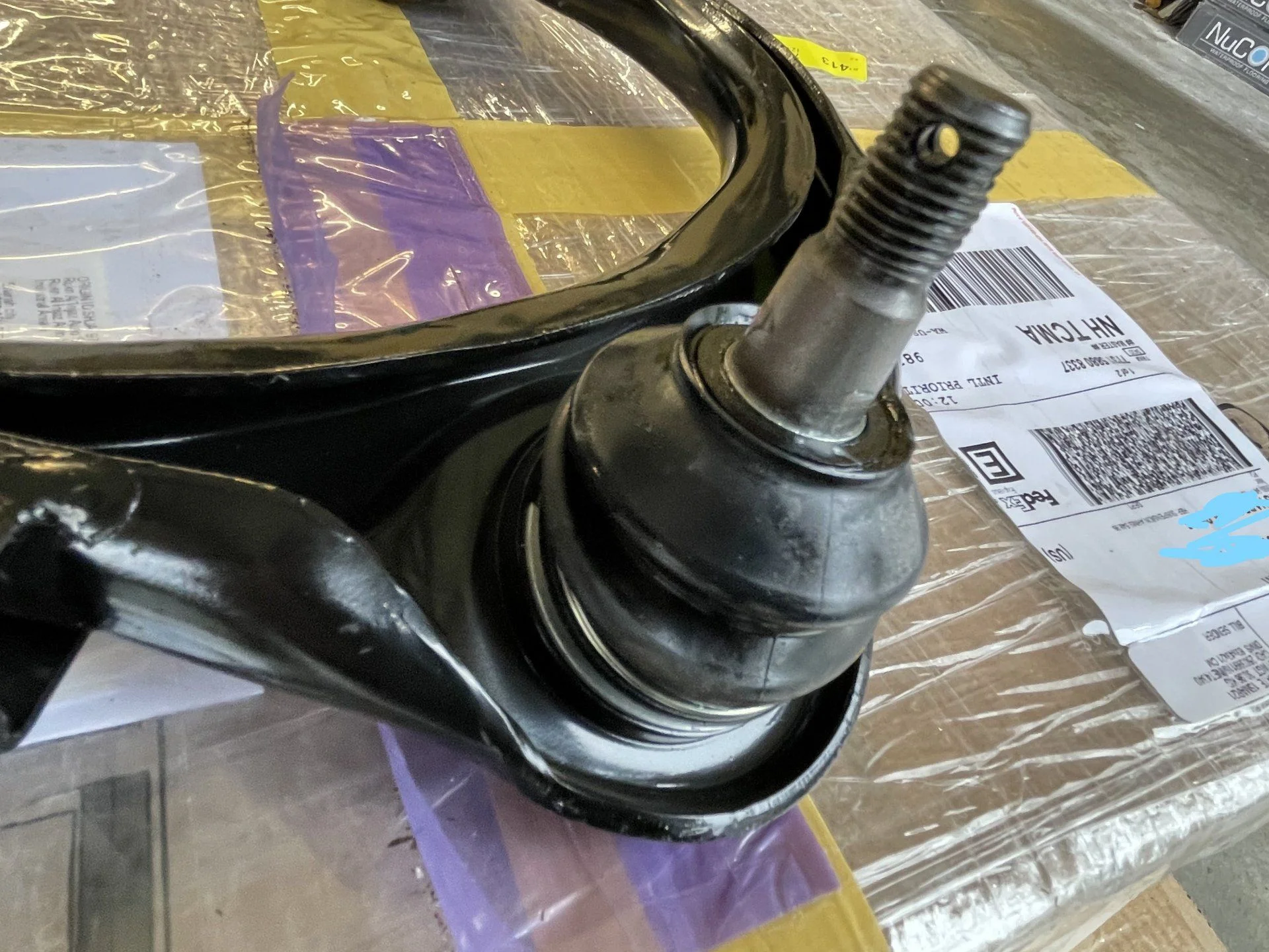

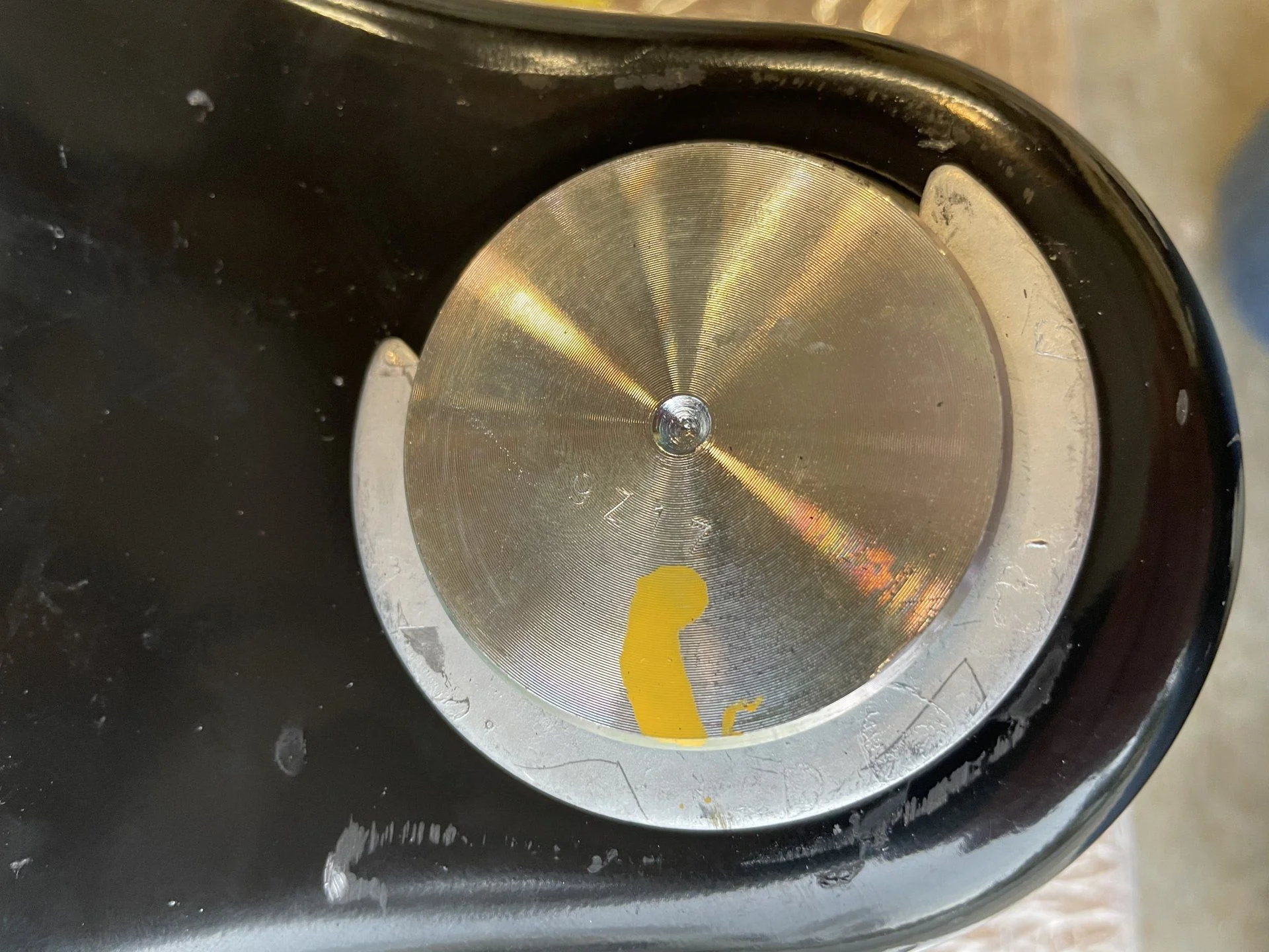

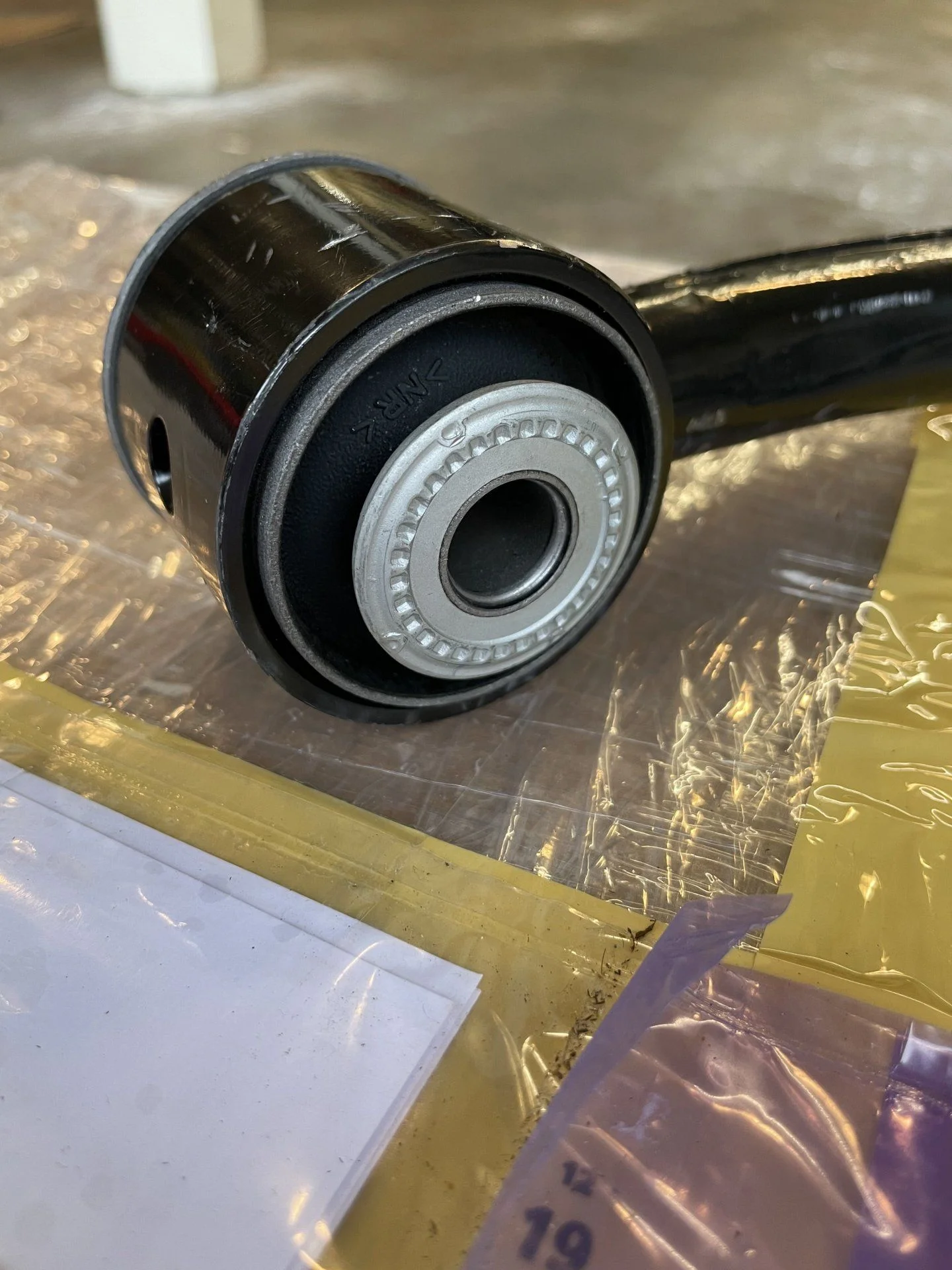

Here are some detailed pics of the control arms. I am inclined to think they are legit because this part is a lot harder to pass off as OEM compared to say an oil filter or spark plugs...
The welds look really good and they seem very solid. Also, there are some markings on them that I don't know would make it on a counterfit. Specifically an LC that looks like it's hand scribed on the lower control arm. Just a detail that I noticed on the photos on PartsSouq that also appears on these.

What was the final verdict on these things? Still thinking legit OEM?
yes I am saying they are legit. I’ve looked at so many pictures online to compare and even compared them to the one (so far) that came off my rig and there are enough little details that match that I’m confident they are OEM.
Also the price wasn’t actually much cheaper than partsouq maybe like $20. If they were significantly cheaper then I might be worried.
