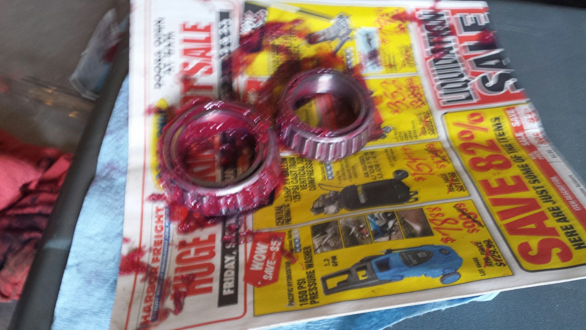

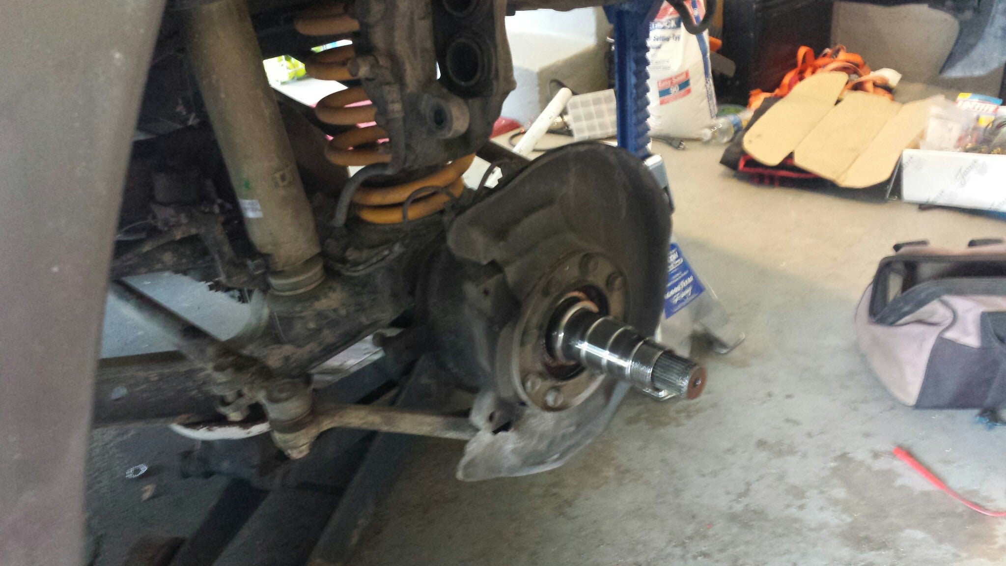

I pulled off the hub and put in new bearings, the outer bearing race was worn and bad, the inner bearing looked fine, but I replaced it. Man, what a pain to get the hub back on, you have to get it JUST right or the bearing will hit at an angle and refuse to go on the shaft. The lockring was in tact so I suspect that the bearing was never properly preloaded when it was serviced last. I will be doing the other side soon because its due anyway. Not a bad job at all really.
Thanks to Bryce at cruiser outfitters for the parts and advice.
