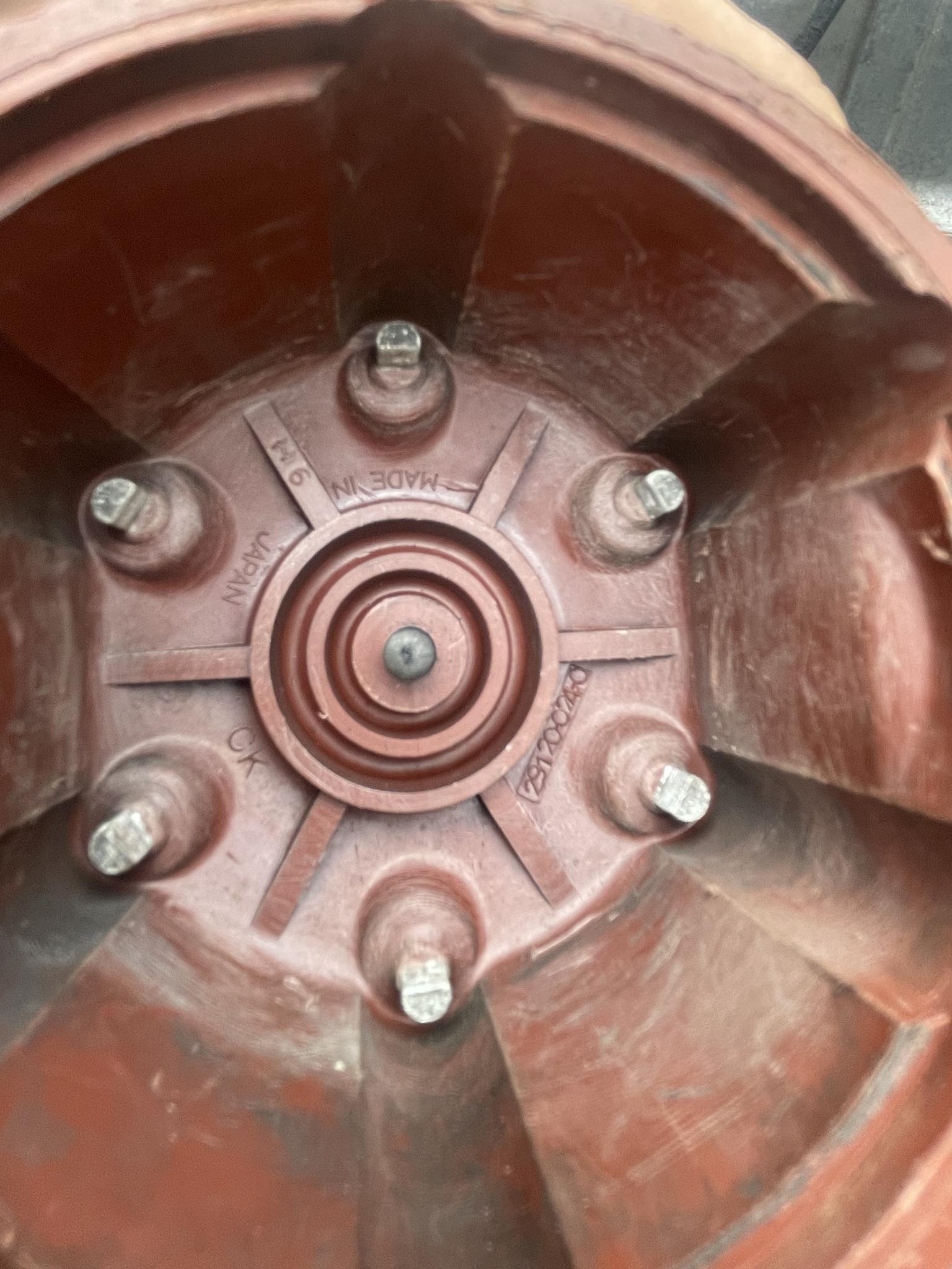

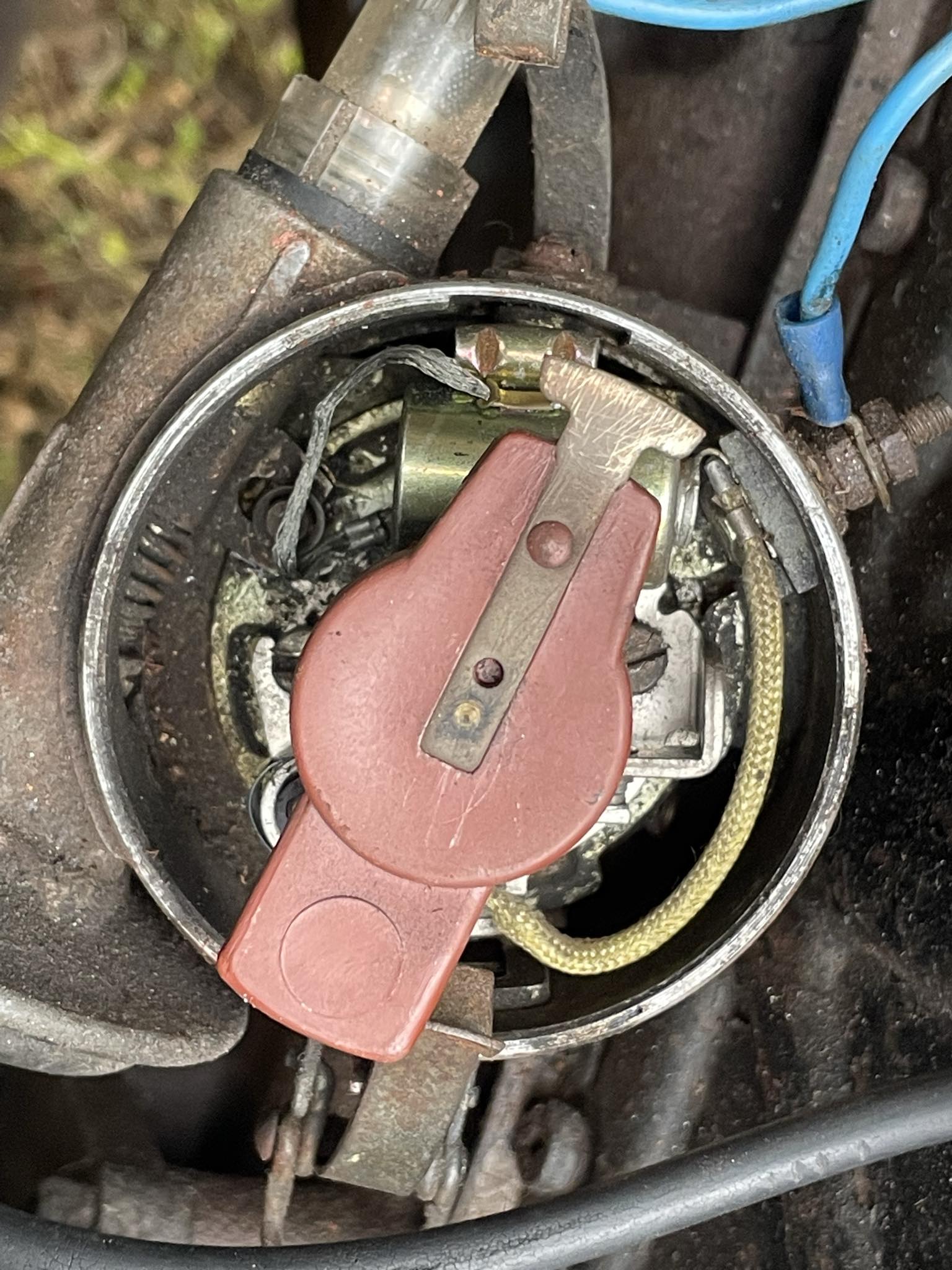

my dizzy cap and inside dizzy looks a but dirty ill take a photo
the scratches on the rotor are from me i was trying to sand some s*** off it
Those aluminum contacts inside the distributor cap still look oxidize on the the flats. Aluminum oxide is an insulator. I scrape the flat with the small blade on my swiss army knife to keep that insulating layer thin. Plus I buy/use NAPA Echlin caps because they have brass contacts.

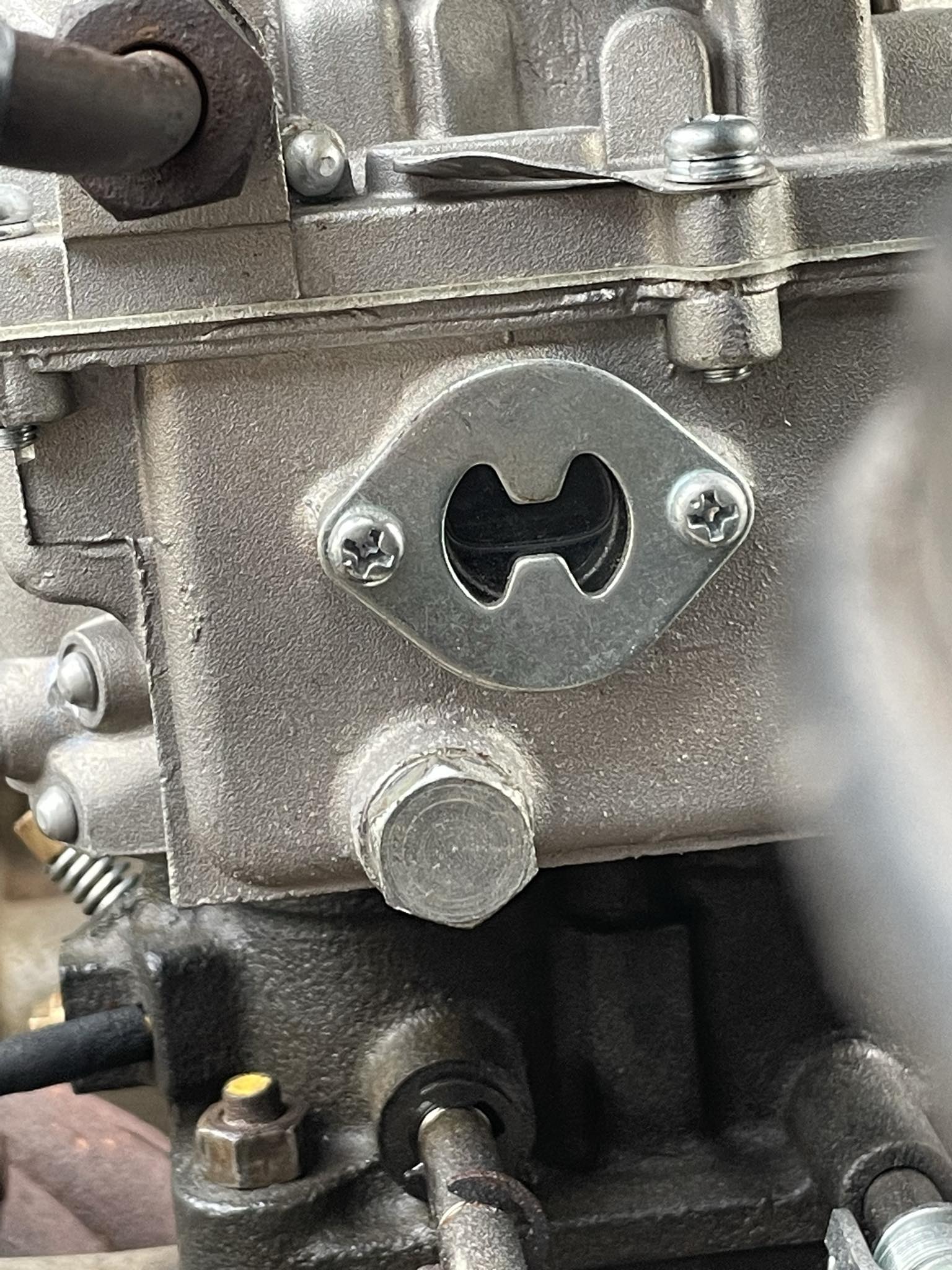

I'd check the fuel filter and float level.
new filter and full level is half way. however one thing i noticed was with a timing light on the engine if i applied vacuum by mouth to the dizzy vacuum advancer/retarder, the timing would not change at all. could this be my issue?
