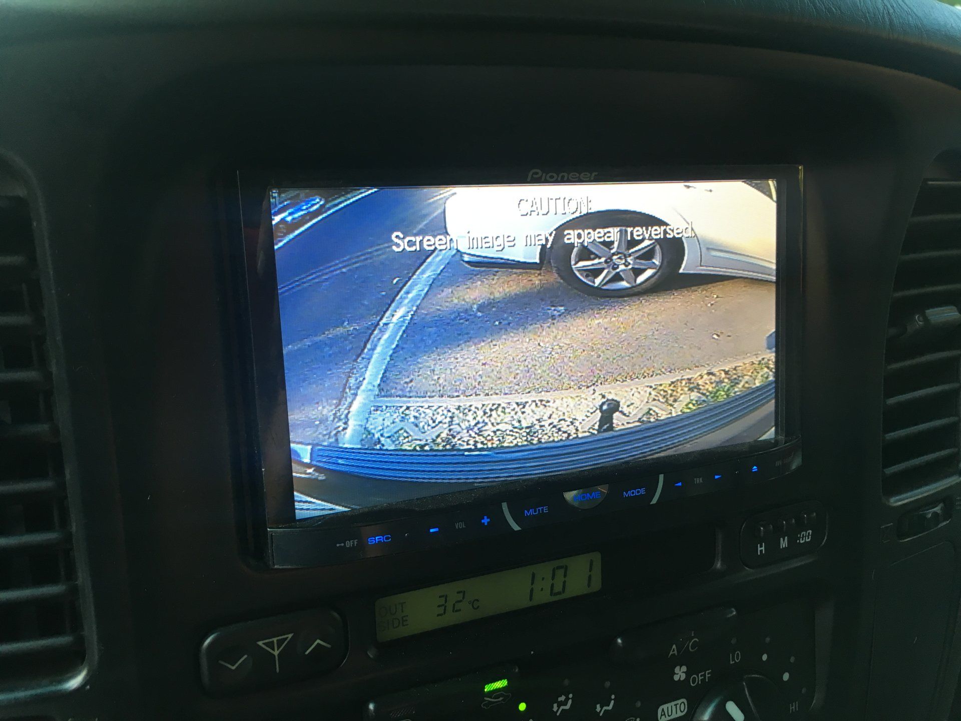

I bought a mount like this to change out my license plate camera I'm using. Unfortunately it kind points at the ground... anyone else have that issue? I'm thinking about finding a way to wedge the camera up or something...
I have this exact issue - I thought it was just me! I can see my bumper really well though. I already siliconed mine in, but was thinking the same. Some kind of shim on the back half carved out of some rubber or plastic.
Ya I can't settle for this lol, my mirrors are more useful than this camera orientation. It's almost like a bad bird's eye view, but it makes me disoriented looking between that and the mirrors. Going to play with it tonight...
Sorry to ressurrect this old thread, but did anyone ever figure our a good way to fix the angle on this camera? I just installed this on my LX and it's nearly unusable due to the angle.
Yes and working great through a few seasons now, but it ain't special: I used double sided 3M tape to "model" it into a usable angle. I drove around like that for a few days moving it a bit, redoing the tape. It was hot out so it was easy to work with. Once I found a position I liked, I kept the tape in there and sort of created an epoxy resin over-mold kind of deal to make it permanent.

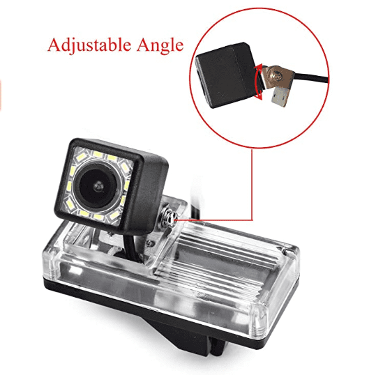

I purchased something similar to the camera that started this thread, but it seemed to address the angle problem that some had issues with:
Does it have active lines on the screen?
I'm not sure, that wasn't one of my priorities and I still have yet to receive and install.
I don't see how you're going to get useful active lines, w/o reading the steering wheel angle.
ahh, I want one with out the intelligent tracks. Our vehicles are too tall for them to work correctly I think.
Please post some pictures once installed and how the image quality is.
Can you please measure the length between the 2 tabs on the bracket before you install it? I would like to use my camera with this bracket.
