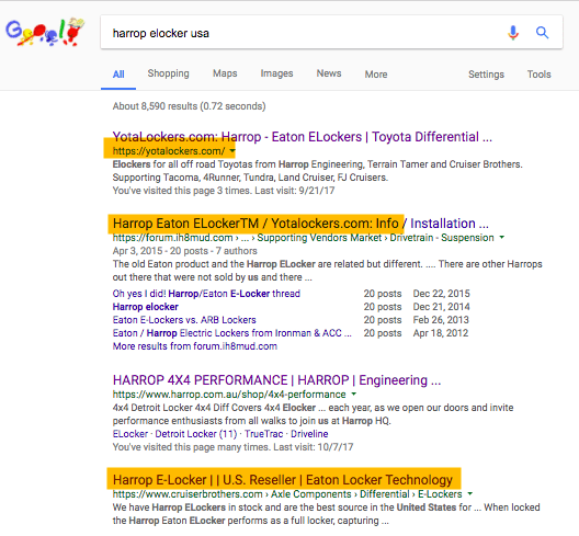

Sorry that Harrop doesn't list us on their site. We distribute in partnership with Terrain Tamer and its a corporate thing. We try to make up for this omission through MUD, SEO and FB. If you search for "harrop elocker usa" via Google, we are 6 or the top 7 hits as below.
