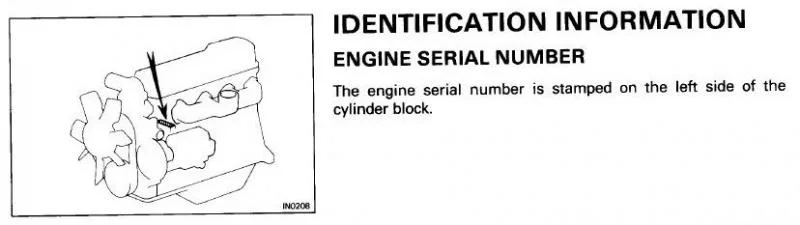

Well Toyota did move around the spot where they placed the serial number on B-series engines.
Here's the spot shown in the 1988 FSM (but they're all on the LH side AFAIK):
And the 1986 FSM shows it placed the same as mine except viewed between inlet ports 1 and 2 instead of 3 and 4.
(I can't post a pic of this location without first going to the trouble of scanning it.)

^^^ Thanks for this post. For haha's I checked out an old Canadian Owners Manual for 1984 BJ42's that I got off ebay many moons ago, which shows the location of the engine serial number. My rig is NZ or AUS but there it was, under the #1 injector. Funny that there were no numbers visible. I put a little light gun oil on the flat surface and the numbers appeared. Like magic.

That pic of the serial number location is the same as in my 1986 FSM.
I never thought of looking in the Owners Handbooks.
